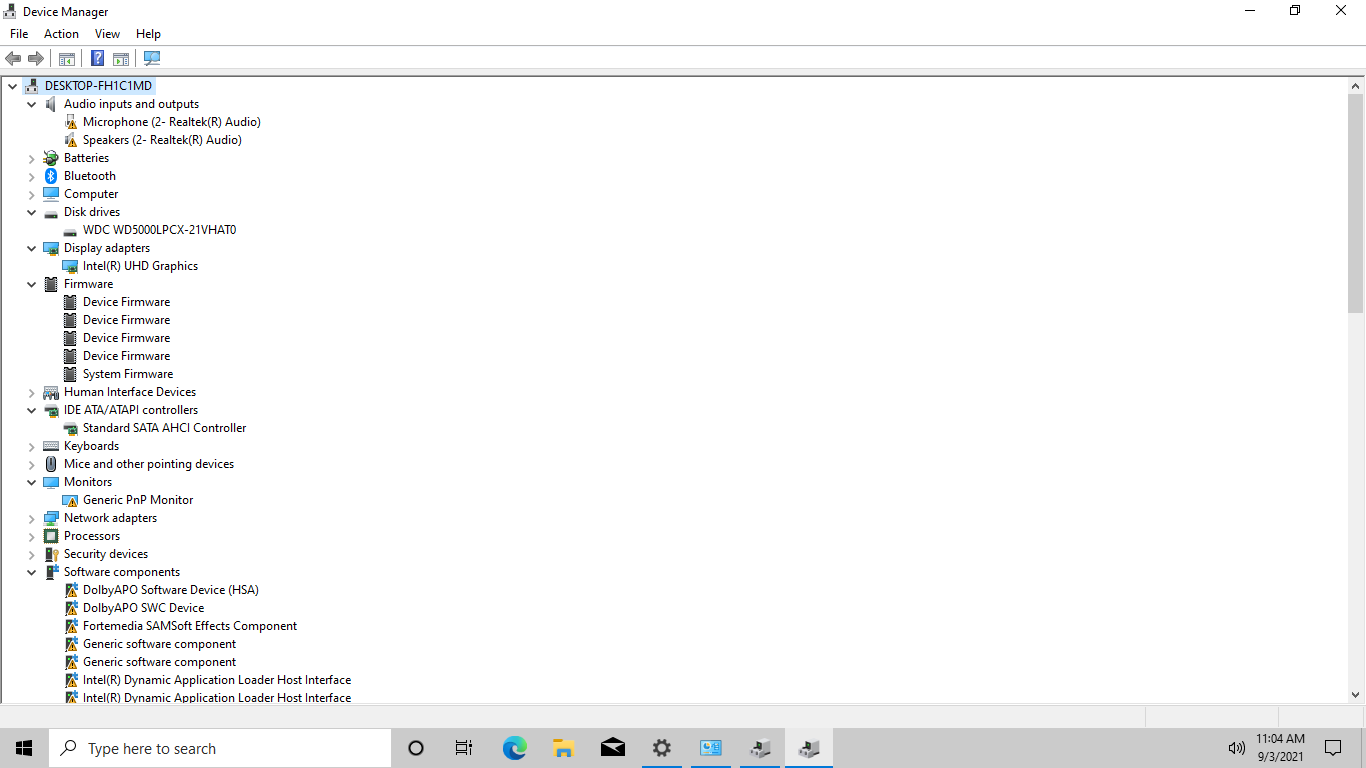

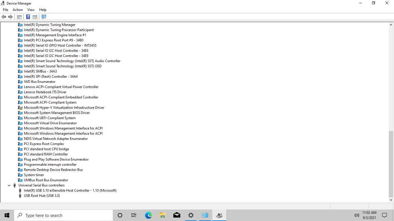

                    Re: Lenovo Ideapad S-145-15IIL BIOS
                    Originally posted by SMDFlea
                    DMI is the serial number, UUID etc. Other problems i think .
                    Thank you master,
                    I trying go to Windows safe mode,running is fast,no frozen.but s/n from PF1V3F51 TO PF1V3F6W.can go to windows some times,but frozen later.would you please analysis it what's problem?thank you!

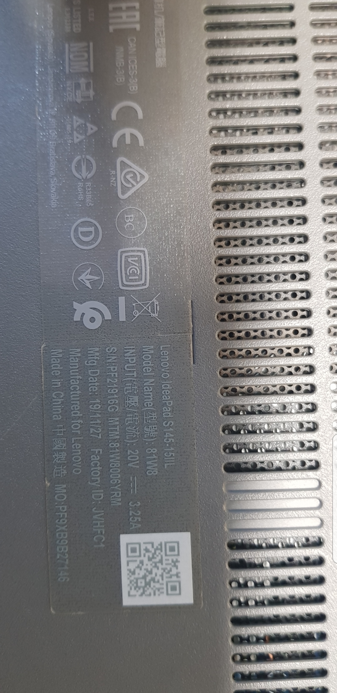

                                  Originally posted by bogdan039
                                  hello.
                                  please fix my original dump bios from lenovo,it die after bios update.
                                  with dump bios from post no 7 i dont have ssd in bios setup and stuck on logo.
                                  thank you.
                                  Your serial number ?
                                      [QUOTE=hoaca388;1169833]Your serial number ?[/QUOTE....]
