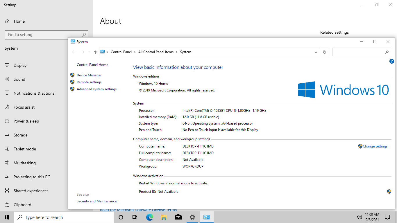

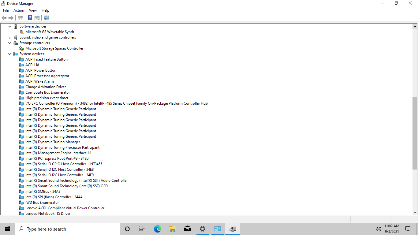

              • linxz
                • Dec 2016
                • 24
                Re: Lenovo Ideapad S-145-15IIL BIOS
                Originally posted by SMDFlea
                Try this one.Virgin bios extracted from DKCN53WW update.
                For these models:
                IdeaPad S145-14IIL/XiaoXin-14IIL QC 2019/Lenovo IdeaPad S145-15IIL/Lenovo IdeaPad 340C-15IIL/V-14IIL/V-15IIL/BS145-15IIL
                DMI 622000 - 623FFF
                Thank you Master!
                what is DMI meaning?
                I'm try it,SSD detected,when run windows going to frozen,may be have other problems?

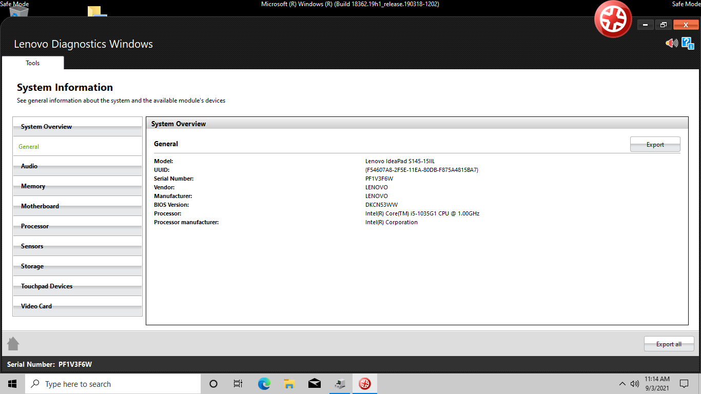

                  • linxz
                    • Dec 2016
                    • 24
                    DMI is the serial number, UUID etc. Other problems i think .
                    Thank you master,
                    I trying go to Windows safe mode,running is fast,no frozen.but s/n from PF1V3F51 TO PF1V3F6W.can go to windows some times,but frozen later.would you please analysis it what's problem?thank you!
                    Premium supporters get full download access and other benefits.
