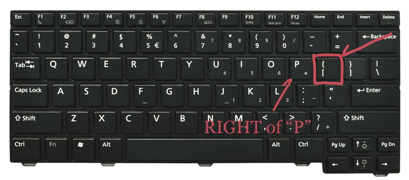

      Hi, my tag is J7TBQH2-E7A8, I have tried three different codes the one generated by https://bios-pw.org/ and two codes from a paid service. None is working. Keyboard is qwerty and used ctrl+enter and caps lock for upper cases.
      Running out of options :-)
      Is there any other options to explore?
      Ok, your laptop has a QWERTY keyboard, but these master passwords are calculated for a US QWERTY keyboard layout.
      Both of the master passwords for your laptop include OPEN BRACKET "[" key, which in a US QWERTY keyboard is located AT THE RIGHT OF "P" key, have you had that into account? Give it a try a few times.
      Check picture attachment of US QWERTY keyboard and compare.
            Thanks AAAC and hoaca388!
            Was the keyboard that caused the issue. Worked fine using the key to the right of the P for the right bracket.
            Thanks for taking the the time to guide me!
