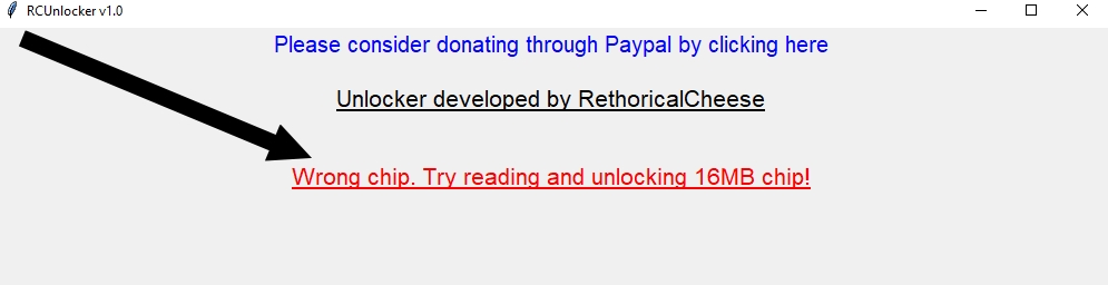

                      HP ZBOOK 14u G6 BIOS UNLOCK
                      Good day,
                      Can someone please assist by unlocking this bin of Zbook 8th Gen the POST POWER-ON PASSWORD?
                      Please find attached Locked BIOS BIN

                          Re: HP ZBOOK 14u G6 BIOS UNLOCK
                          Hello hoaca388, thank you for the link I downloaded the RC Unlock it says, "Wrong chip. Try reading and unlocking 16MB Chip and I'm running 32MB file"
                          Check the screenshot on the attachment
                            Try find 16MB chip on your mainboard. Your laptop have two bios chips.
