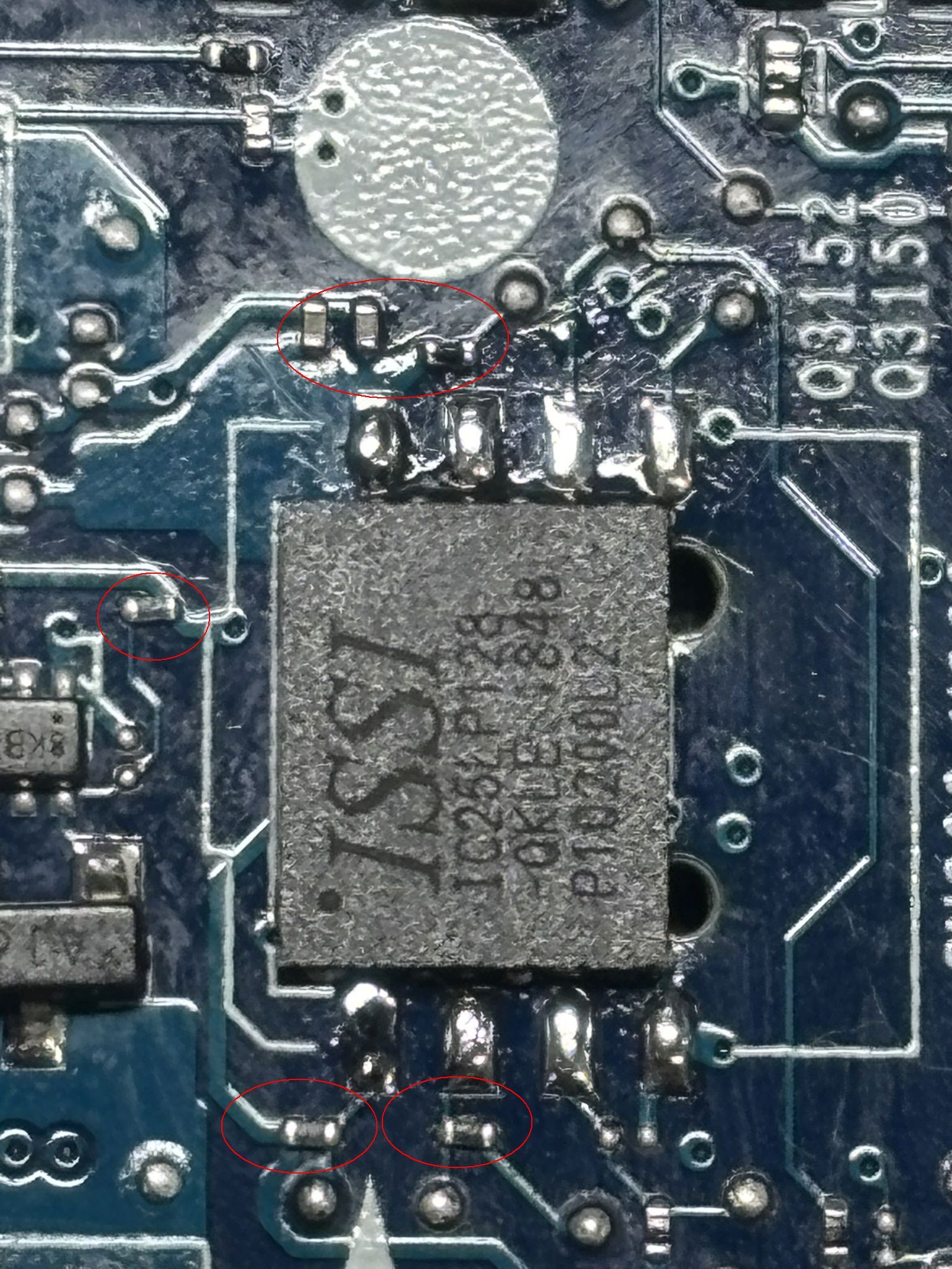

                    Please I need help with my bios for Hp 840G5, I have programmed almost all bios file and EC file on this thread, none seems to work, I have been having different error light, some point bios corruption, and other bios and EC mismatch. Please help me with a working file please. Here is the backup of my ec and bios file
                    My laptop is
                    Hp Elitebook 840 G5
                    Core i5 8th generation
                    Model: HSN-113C-4
                    ProdID: 5JM99EC#ABH
                    SN: 5CG9062P70

                      #531
                      My laptop is
                      Hp Elitebook 840 G5
                      Model: HSN-113C-4
                      ProdID: 5JM99EC#ABH
                      SN: 5CG9062P70
                      Your provided serial does not match any of the dumps provided...in fact the two dumps are from different laptops...anyways,
                      here you got two dumps (EC+BIOS) but you need to use BCU tool to enter factory data ... from your provided bios content is this:
                      Description: HP EliteBook 840 G5
                      Serial Number: 5CG8180LLR
                      Product Number: 2FA66AV
                      Board CT Number: PGWHT00WBAR2GG
                      BuildId(BID): 17WWCSAT601#SABH#DABH
                      Feature Byte: 3X476J6S6b7B7H7M7Q7W7m7saBaEapaqauawbUbhcAdUdpdqfAgdhKhk.hy
                      MAC Address: B4-B6-86-8C-A2-6F
                      Good Luck!

                        #532
                        Thank you so much for your swift response. I appreciate it so much.
                        So after flash the EC & Bios you provide, I get a steady white light with 11 amber then 6 amber blinking then restart.
                        Please kindly help me in anyway you can. Thank you

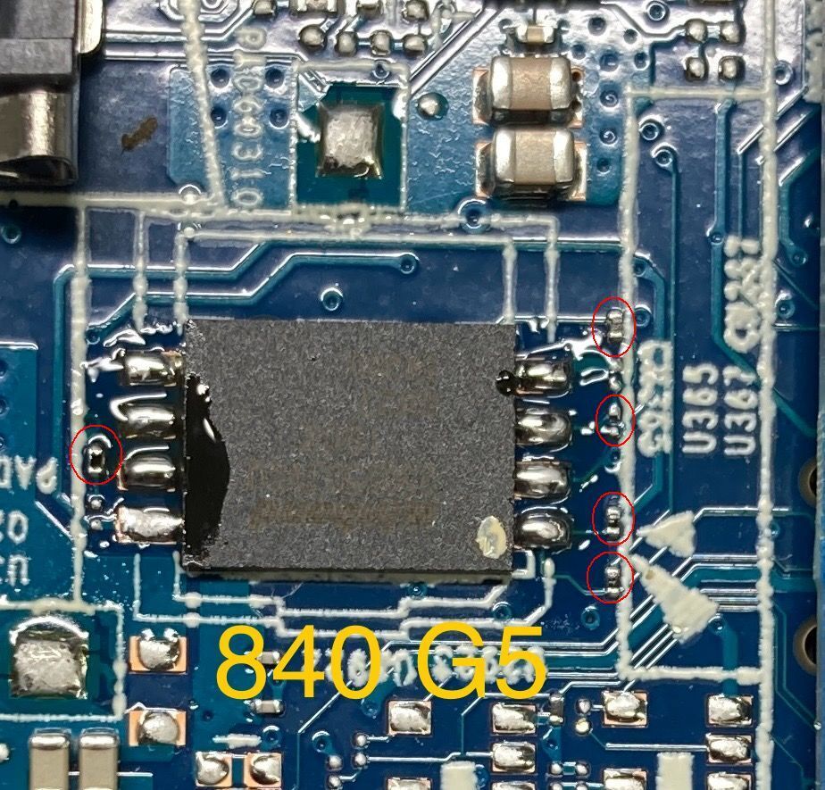

                          #533
                          That dumps worked for me on several 840 G5 laptops.
                          First , you must check all components near the EC and BIOS chips to ensure you have not blow out any little resistor and second sometimes it takes a long time to boot for the first time after flashing both EC and BIOS and I mean even up to 5-10 minutes with several restarts.
                          Click image for larger version  Name:	EC.jpg Views:	0 Size:	501.5 KB ID:	3695808 Click image for larger version  Name:	BIOS.jpg Views:	0 Size:	203.6 KB ID:	3695809

                            #534
                            Thank you sir, I will give it a try again sir
