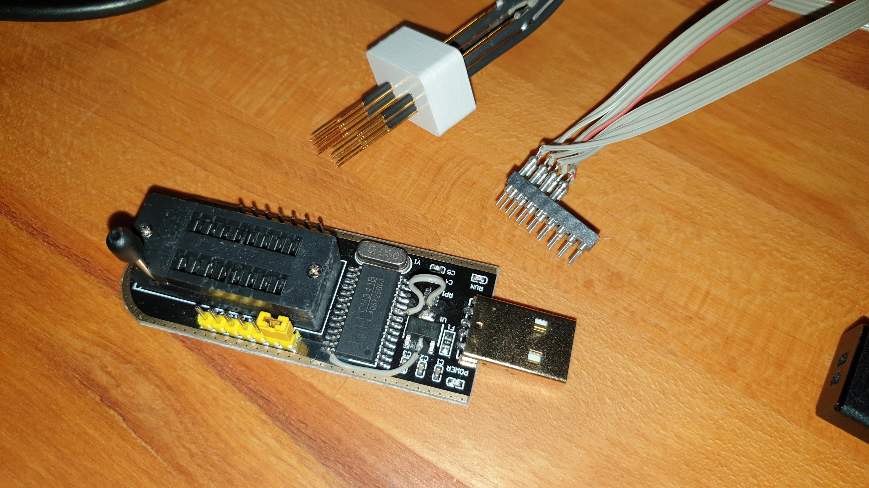

              • x.stas.y
                • Jan 2023
                • 5
                Re: HP EliteBook 745 G5 password
                Hey all,
                I have some issues with my laptop as well. The first one is a bios password and that's how I got here in the first place. And the other one is my laptop throttling down to 0.38ghz. Everything runs frustratingly slow. And the fan is running at full speed all the time. HWiNFO is telling me something about prochot-ext, so something's definitely wrong here, although all temps are fine. I have played with windows power management options. Let it run with or without the battery, same goes for the power adapter. Reinstalled windows and drivers and tried many things more suggested in all kinds of forums. But no luck so far. My guess would be either something's wrong with the board or bios, because this issue persists even without windows running or no ssd installed at all.
                Regarding the bios issue, I've read all posts in the RCUnlocker thread and have a general understanding of how it all works. Still, this whole reprogramming topic is absolutely new to me so I'm a little at loss here. I took some pictures of all bios-like looking chips I could find. Which chip does what? I've read that U366 should be the right one. But to be 100% sure, which is the one I have to modify regarding a.) the password issue and/or b.) fan speed and throttling issue and lastly c.) something else I didn't think of? Because some users reported fan speed running at 100% after reprogramming, I wonder if this issue is somewhat related to mine.
                I still have to buy all the necessary tools. Would a cheap CH341A programmer be enough (for winbond and issi chips)? I have an old RaspberryPi 2 if it that helps, although I'm not familiar with Raspbian/Linux. For that chip with those 8 tiny legs I guess a test clip would suffice? And for the other ones just soldering some wires to the copper pads nearby? If removing the chips from the board isn't absolutely necessary I'd definitely prefer not to, because I most certainly would break something (and had to buy a hot air station).
                Your help is very much appreciated.

                  to delete the password, post the contents of both 128MB chips, here.....you will need an SPI programmer..I don't know if the programmers you have will help you...you can see what bios chips it supports by searching on the internet..you have this video like example, you can see other...
                  https://www.youtube.com/watch?v=DWWigscuQDY

                    WINBOND 25Q128JVPQ is more available when read with CH341A, post the contents of this chip.

                        Blue : yes, it's non relevant.
                        Red : I'm not sure but you can try.
                        Notice the voltage of the CH341A, the black board type has a default voltage of 5 volts.

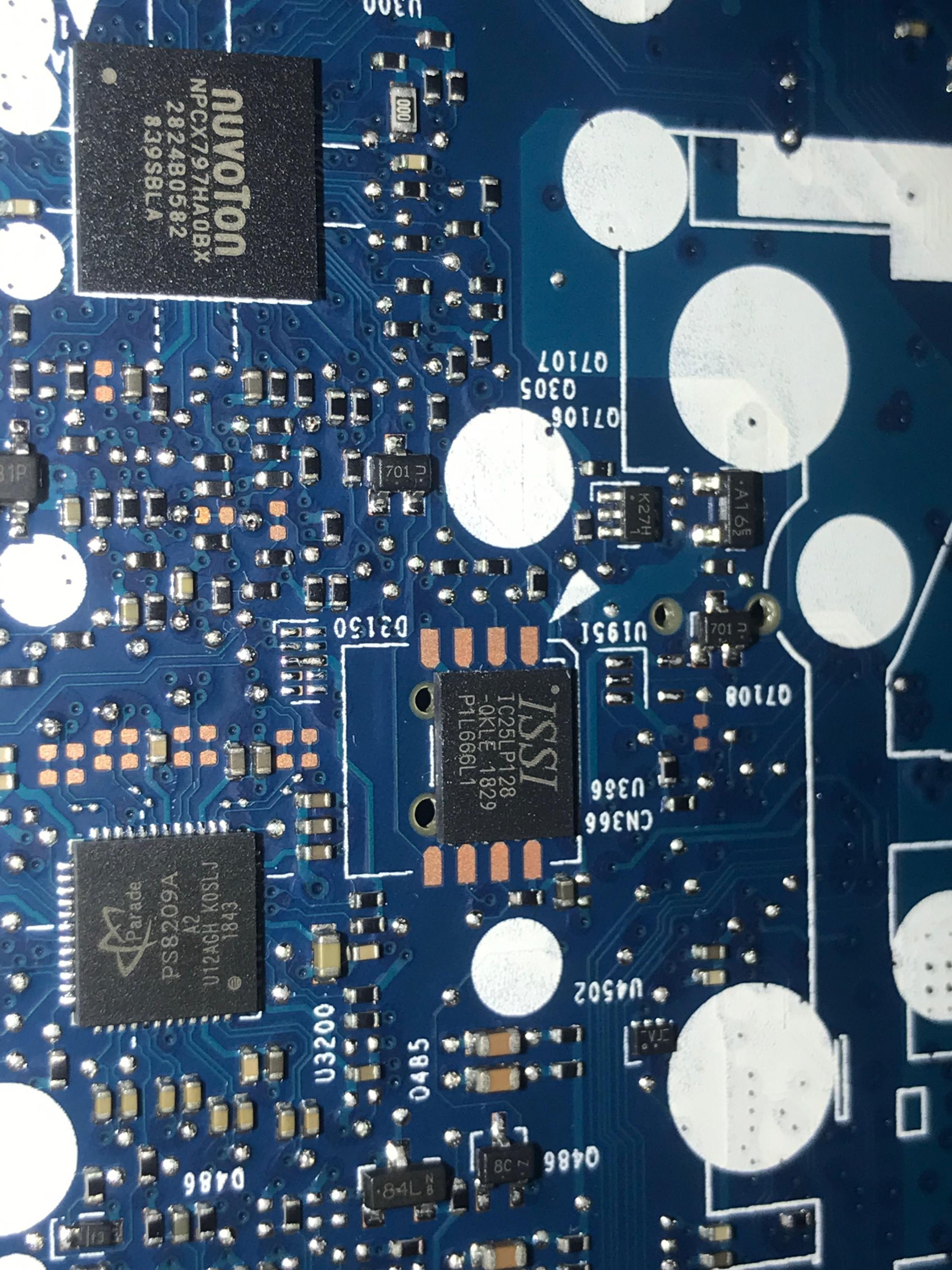

                        • volinakis

                          from my experience you only need to modify U366 with RCUnlocker and at 1st boot press F10 to enter bios setup and reset security to defaults in Security Tab.
                            Thanks for the heads up regarding the 5v issue with this programmer. I'll have to keep that in mind. Was the U366 chip you have encountered the same one from ISSI or another one? Cause there's not much information on the internet regarding that IC25LP128 chip. Well, there is one that it doesn't work: https://www.badcaps.net/forum/showthread.php?t=114626
                            However, if I'm not mistaken you can add a chip manually to the chiplist.xml, right?

                              yes, the same chipset, I am using a RT809H and it has a smart ID for chipset, I don't remember if it recognised as is or something equivalent, I unlocked that laptop few months ago.
                              If you are using CH341A try with ASProgrammer or Neo Programmer, don't use software came with CH341A

                                I did get the CH341A programmer finally and did a 3,3v fix I've found on YouTube. I've made myself some kind of pogo pin contraption so I wouldn't have to solder any wires to the board, but the USB programmer always got disconnected from Windows when making contact. It was like unplugging an USB drive with that typical sound it does. If connected to the board first and then plugging in it wouldn't make any sound at all. Windows device manger wouldn't list the programmer as well. I don't think I have shorted anything, but regardless which chip and how many times I have tried I got the same result. In hindsight, I think it was because I've followed a 3,3v fix guide which involved soldering a wire from pin 9 to the transistor, which I did remove later on.

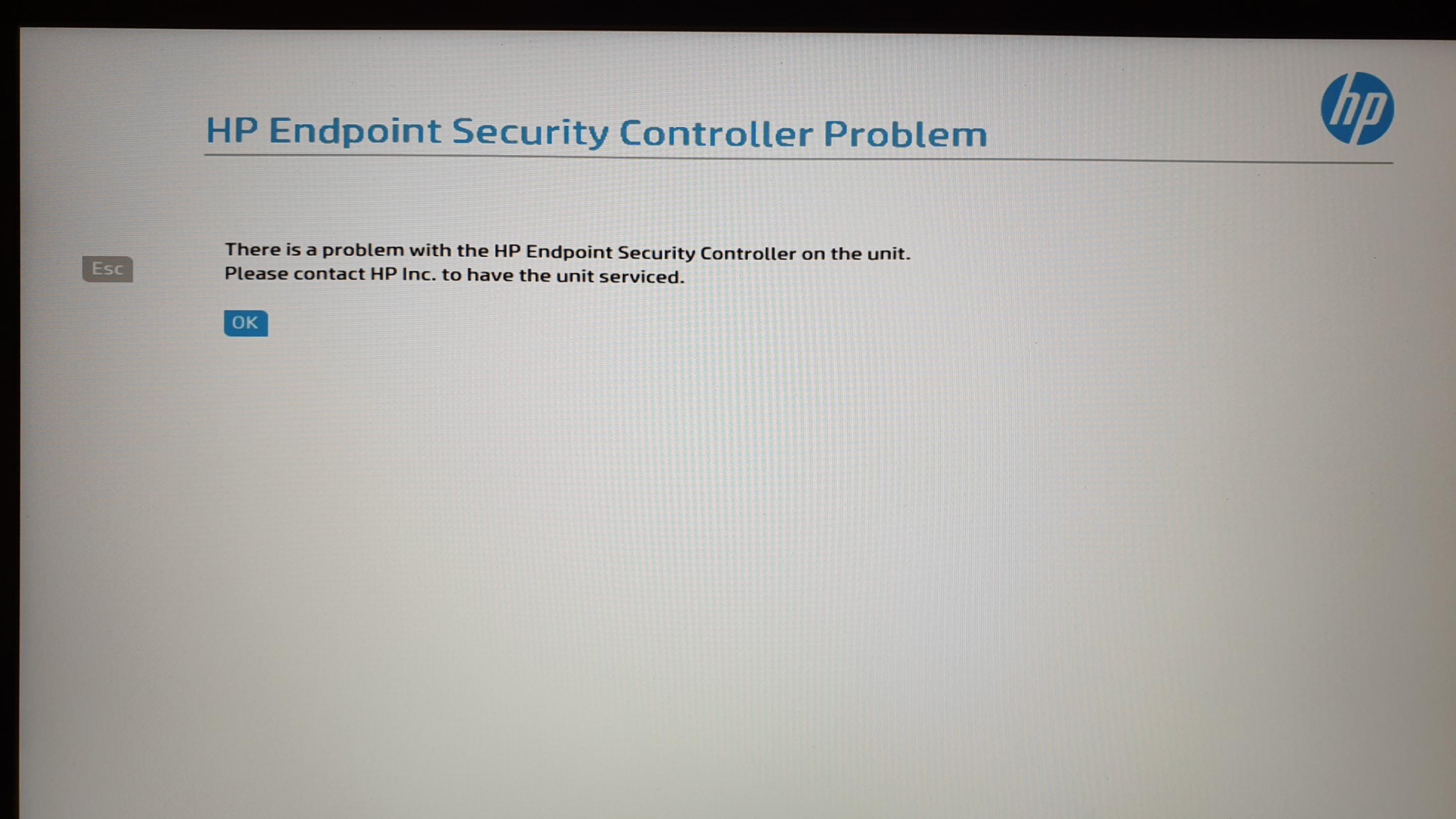

                                Anyway, worrying I might have shorted something and killed the board for good I have assembled everything back together and as soon as I have connected the battery, the laptop started on its own. But the display wouldn't show anything. I have waited a little bit, then hold the power button to shut it down. Tried again, but this time I got three beeping sounds, followed by two shorter and higher pitched ones, and still a dark display. Again, holding down the power button to shut it down. The only thing that came to my mind was booting while pressing and holding the windows + b key to roll back to a working bios configuration, if I've accidently shorted/screwed up the chip/bios while trying to read the 2nd chip.
                                Well, the laptop did its bios thing for a few seconds and started up Windows just fine. I was so relieved. And on top of that the password was gone. So no bios password anymore. Even without soldering or writing to the chip. So either the rollback removed the password (could this actually be?) or just me messing around with both chips did do the trick. Later on I've realized I shouldn't have let it boot to Windows, even though I was more than happy to see the laptop booting at all after it failed to do so previously. Because then I got a “HP Endpoint Security Controller Problem” warning during startup every time. Resetting the security settings and loading the default bios settings did not help. The 0.38GHz and fan speed issue was not solved as well. So something must be wrong with the board physically.
                                Now to get rid of that “HP Endpoint Security Controller Problem” I saw a post by RethoricalCheese suggesting to clear the VSS region from the main bios chip (WINBOND). While that pogo pin thing didn't work well, I've tried soldering tiny wires to the board, right next to chip. Well, that didn't work as well as I've hoped it would either. I did at least 30 dumps or so and a few of them seemed to be exactly the same (this time without soldered pin 9 to the transistor). I have blanked/FF'ed the VSS region with a hex editor and tried to write that back to the chip. No chance, always got errors while verifying. Didn't matter if 3,3v or 5v. Writing just took so much longer then reading and even that took many attempts to get a few good dumps, which happened to be in a row during the first 10 tries, which I couldn't replicate ever since.

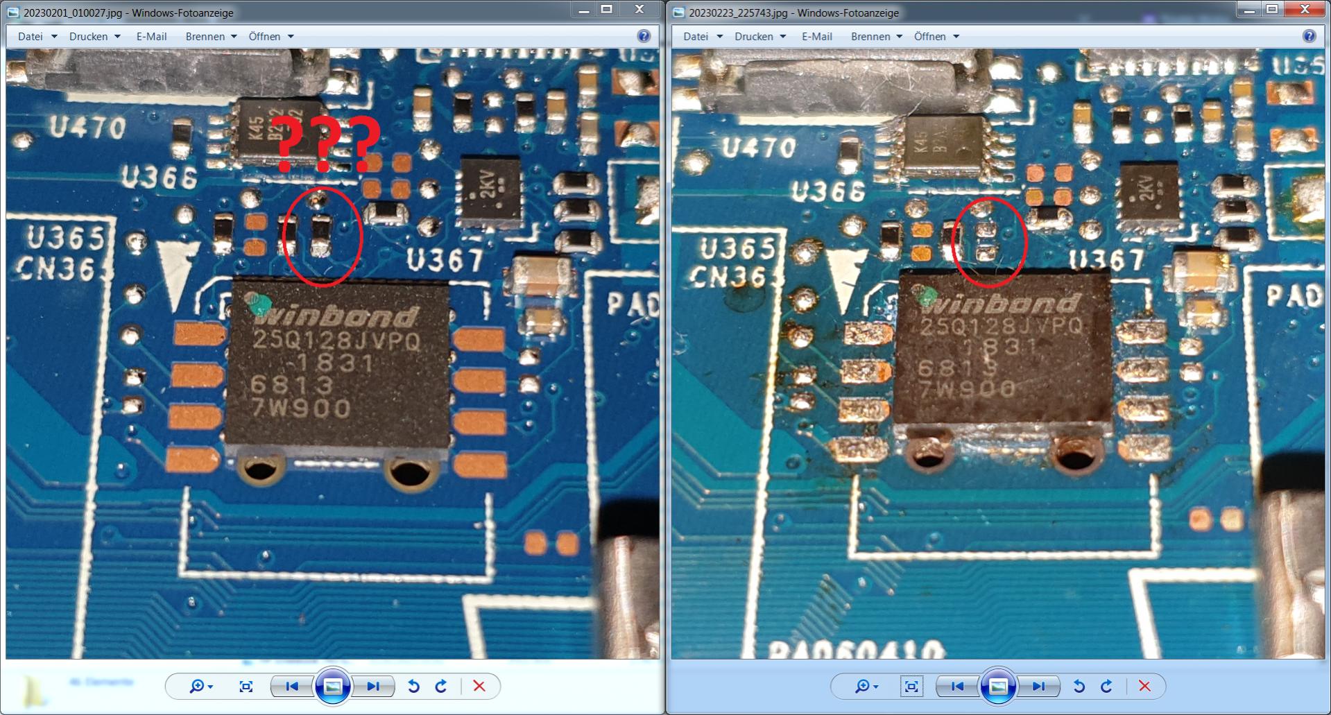

                                Anyhow, now I had to ask somebody to help me desoldering the main chip. Erasing, writing, verifying worked flawlessly. But only without the 3,3v fix at all. The programmer always got disconnected from Windows with 3,3v during the writing process. 3,3v while reading seemed to be working. The chip got soldered back on today, but while doing so one resistor went flying off the board, which can't be found. Oh man, from one problem right to the next one.
                                Does anyone happen to know which resistor goes there, right above the main bios chip? And how about your thoughts regarding the password removal? Could a bios rollback or maybe shortening the chip with a possibly wrong 3.3v fix be the reason why there was no password anymore?
