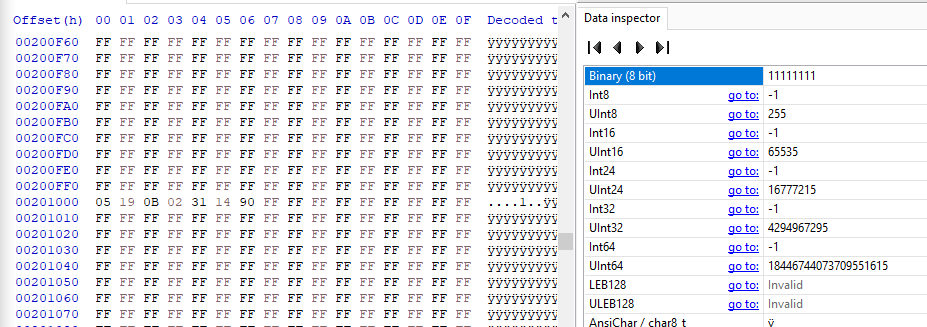

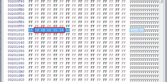

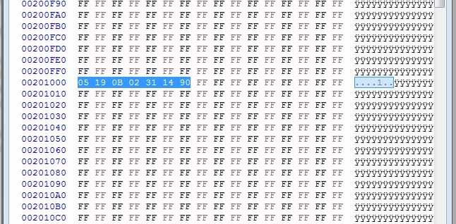

                    • boltonbios
                      • Oct 2022
                      • 5
                      • England
                      #50
                      Re: lenovo miix 520-12IKB
                      Hi pal,
                      Just a little confused as to how to read this. So for example, the first 00 is 05 then 01 then 0B...you said number 30 would be for example the letter B but I'm not sure if I'm reading it right or not.
                      Can you explain a bit how to read/decode this? I've attached a screenshot.

                                • boltonbios
                                  • Oct 2022
                                  • 5
                                  • England
                                  #56
                                  This helped in decoding/translating, thank you:
                                  https://www.win.tue.nl/~aeb/linux/kbd/scancodes-1.html
                                  05 I'm assuming is the total number of characters
                                  19 is P and 0B is 0(zero) 02 is 1(one) 31 is N and 14 is T.
                                  Thanks again!
