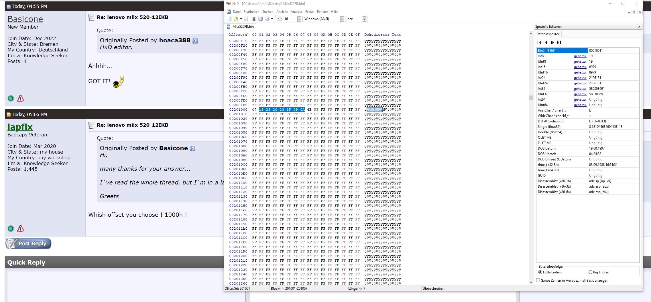

      Hi everyone,
      received a used Miix 520, BIOS PW protected after Startup by pressing F2, so I can´t activate VT-D BUT I CAN BOOT INTO WINDOWS with no probs.
      Made a Backup of my BIOS using "Universal BIOS Backup Toolkit" but it wasn´t recognized by it at once. Then made a generic Backup with a Size of 8MB (.bin file), so I really don´t know if it is the real thing. Should it be 16MB? .zip is now about 4MB - far as I can see: others are about 8MB...
      But here it is for a request to reveal the BIOS Password.
      Would be glad if someone could make it (I´m about 4 hours now on my way to search for solution :-/ )
      Greets

              I´ve read the whole thread, but I´m in a lack of a reliable reader for this .bin file which shows me the right columns. Used Word instead and still confused...

                HxD editor.

                  #68
                  Re: lenovo miix 520-12IKB
                  Originally posted by hoaca388
                  HxD editor.
                  Ahhhh...
                  GOT IT!

                    #69
                    Originally posted by Basicone
                    many thanks for your answer...
                    Greets
                    Whish offset you choose ! 1000h !

                      #70
                      Must be 00201000 as shown in this Picture (and as shown in the Pictures in these threads before: https://www.badcaps.net/forum/showth...t=95689&page=3)...
                      Has to be translated it with help of scancodes:
                      https://www.win.tue.nl/~aeb/linux/kbd/scancodes-1.html
                      https://github.com/tianocore/edk2/bl...KeyBoard.c#L36
                      Haven´t spent the time to proove it yet, but it seems the real thing for me...
