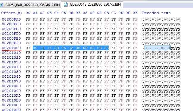

            • 21018
            Re: lenovo miix 520-12IKB
            Originally posted by MrMike25
            AAAC, you're awesome! Thank you so much!! It worked on 7 of them but 3 it did not. I hope you can help on the last three. They should be the same as the other ones but weren't so who knows. I uploaded the bin files hoping you might be able to get the password for the last three. Thank you again for all your help!!
            You can unlock them yourself using a hex editor. The offset is in the picture,the highlighted area is a keyboard scancode. 30 = B ,and so on.
            https://www.win.tue.nl/~aeb/linux/kbd/scancodes-1.html
            https://github.com/tianocore/edk2/bl...KeyBoard.c#L36
            • MrMike25
              • Mar 2022
              • 6
              SMDFlea, Thank you for sending the information. This is great information and I will need it in the future for sure.
              I think I'm confused because this Lenovo doesn't let me use upper case or special characters. The password which was provided earlier only worked when I used lower case because upper case doesn't show anything is being typed. Does 30 = B as in I need to look at the upper case line? If that is the case then the special characters will not work.
              So, from the scan code and the hex editor I get BPWD410M10H (looking at the Keyboard scan code under key then the left side example 02 = 1 not !) but it doesn't work. Also, the 6D gets me confused because it's not in the scan code area so I looked over under normal and saw it says M.
              BTW, yes all the last three have the same 30 19 11 20 05 02 0B 6D 02 0B code under 00201000.
              • MrMike25
                • Mar 2022
                • 6
                SMDFlea, I finally got it! I needed to stop at the 6d so the password was BPWD410, just the first 7 and not the entire line. Anyway, thank you for all your help!

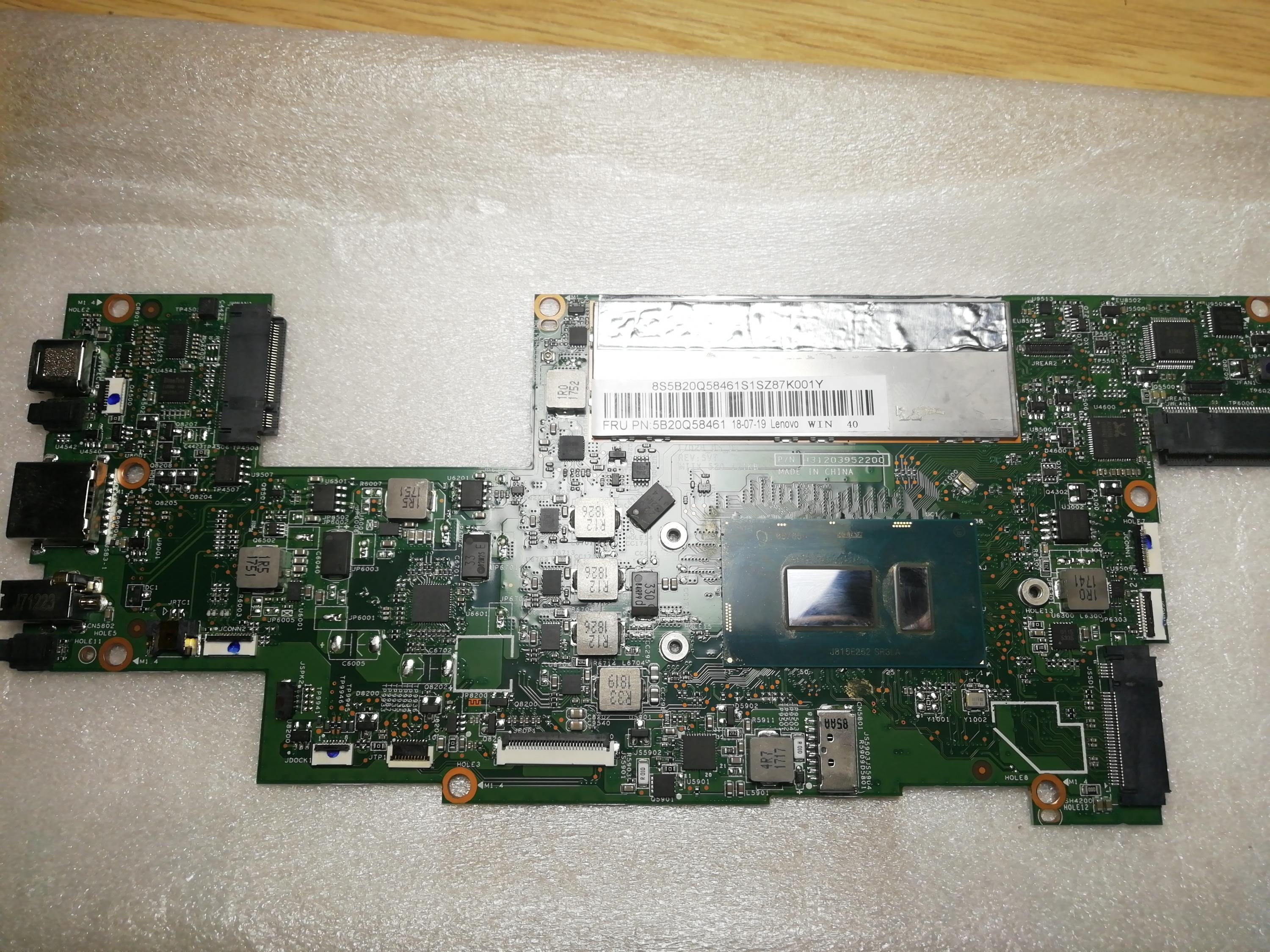

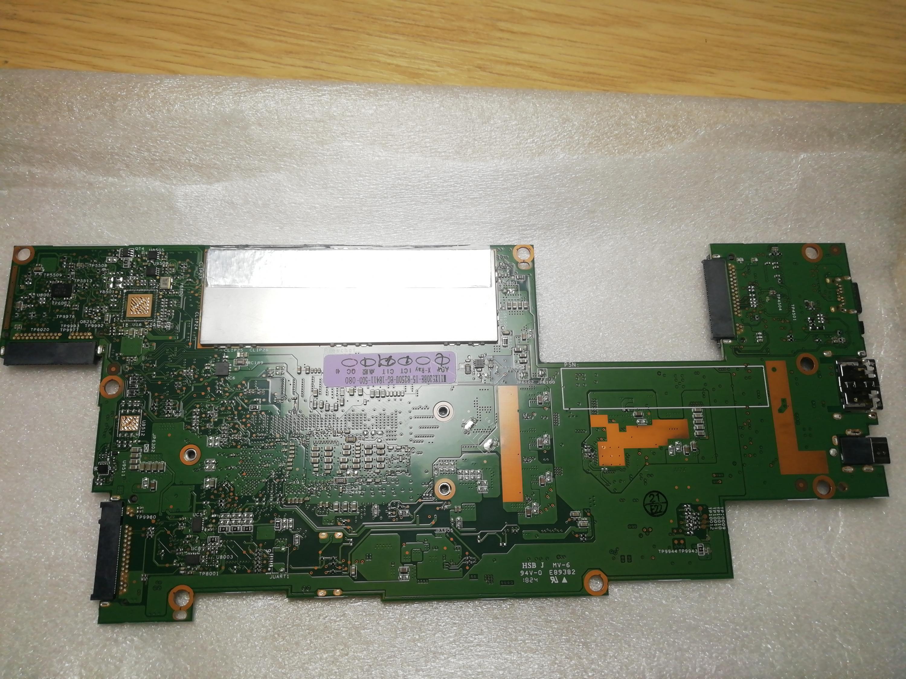

                                • qb92353
                                  • Jun 2022
                                  • 4
                                  • United Kingdom
                                  #36
                                  Originally posted by peste
                                  we don't know all the boards either ... post clear pictures with the motherboard on both sides ...
                                  I have two motherboards they are identical, this one is a broken one I use for testing aince its easier than opening my laptop and taking it apart every time
                                  • peste
                                    • Dec 2016
                                    • 12872
                                    • ROMANIA
                                    #37
                                    u3002 .. to the right of the processor in the first photo
                                    • qb92353
                                      • Jun 2022
                                      • 4
                                      • United Kingdom
                                      #38
                                      Found it! Mersii now i can get the BIOS programmer so i can read whats on it.
