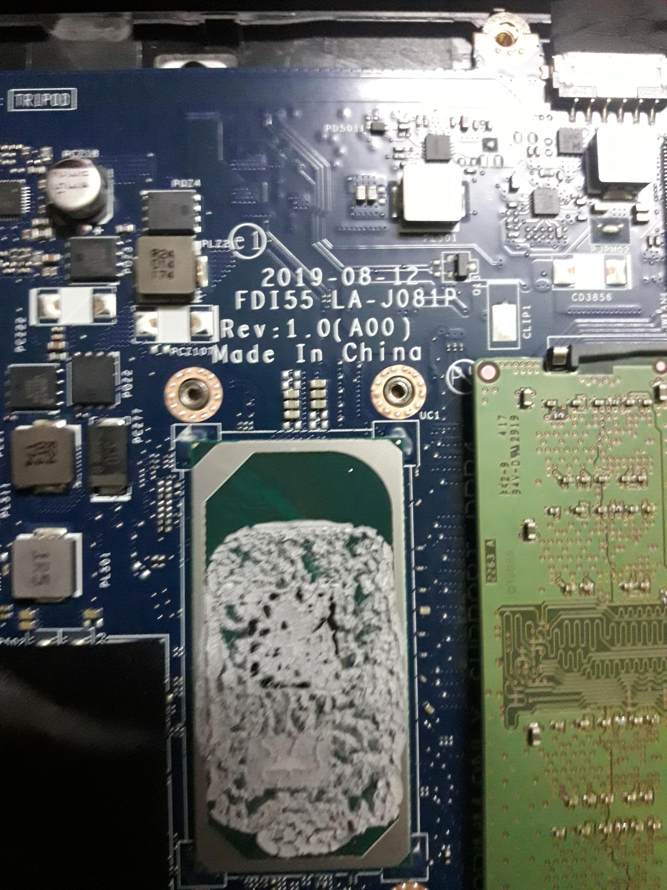

    Hello help me Dell Vostro 3591 FDI55 LA-J081P Rev 1.0(A00) Bios Bin

    Re: Dell Vostro 3591 FDI55 LA-J081P Rev 1.0 Bios Bin
    post the backup of the bios

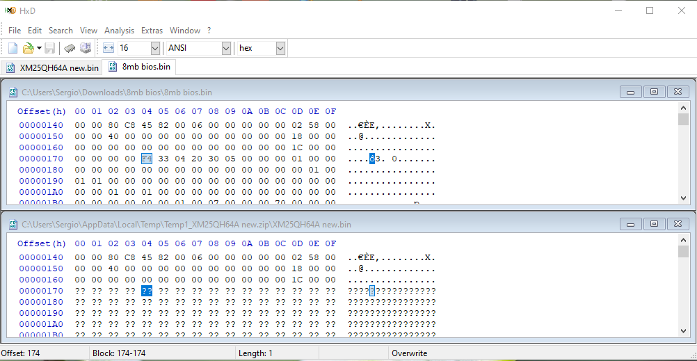

        here they are
        the 8MB bios is corrupt ... read the bios chip again and post ...

                • Mazorca
                  • Jan 2017
                  • 463
                  Open both files with HxD editor, click on Analysis tab>File compare>compare> then OK when one of the files is highlighted. Click on F6 for next difference, shift + F6 for the previous one. They should be EXACTLY the same for a good dump. I myself sometimes take three, particularly when doing unlock procedures.
                              This is a single Bios file that has been split and programmed into two Bios Chips .. you have to combine them into a single bios file before working on it with FIT or any other tool... the 8mb file is the beginning.. after, you have to split them back..
