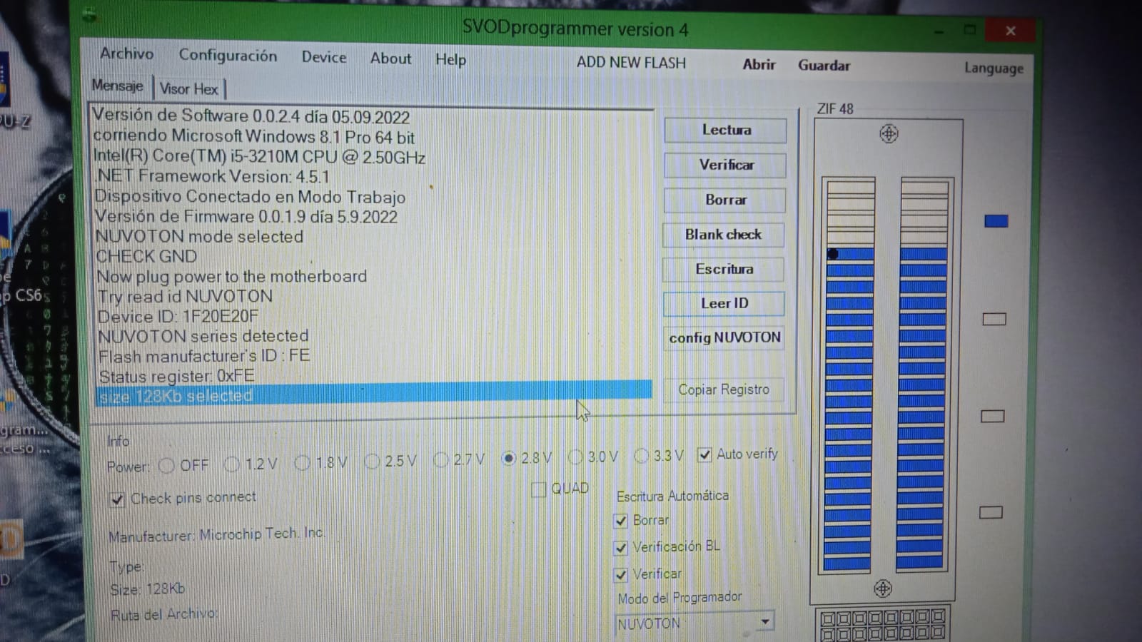

                                • diego2019
                                  • Mar 2018
                                  • 30
                                  • peru
                                  #36
                                  Re: Lenovo Thinkpad L15 (CPU 10th Gen) Supervisor Password
                                  Hello partners, I managed to read the NPCE68APA0DX, with svod 4 but I only get B in the hex. any help thanks
                                  • tomodachi
                                    • Apr 2012
                                    • 608
                                    • Turkey
                                    #37
                                    Originally posted by evserv
                                    Good news for programmer owners: Vertyanov!
                                    Now the Vertyanov programmer supports the NPCE68A chip. To work with the chip, you need the power supply and battery to be connected at the same time. Use version 8.10
                                    download link please ?
