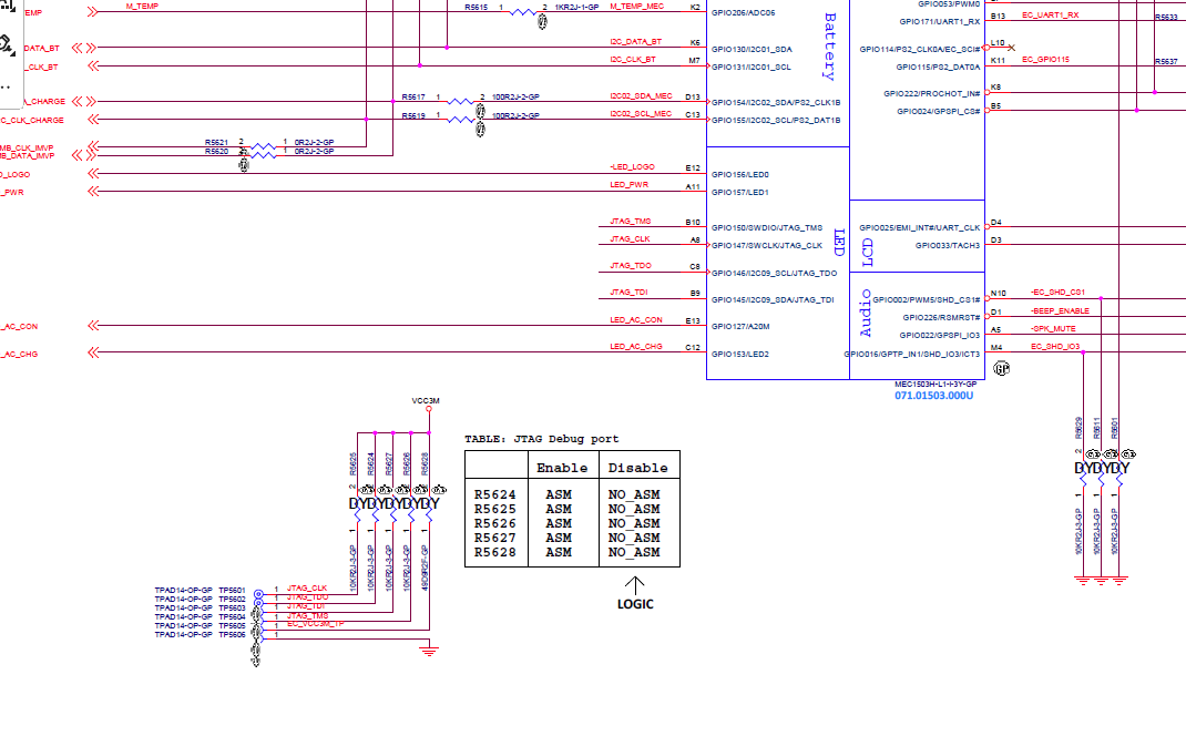

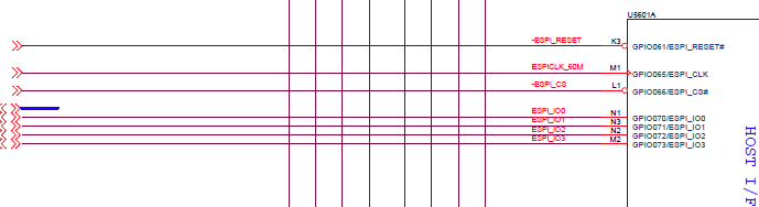

            1. Because your SIO works with ESPI you can't use Maxpower3 method.

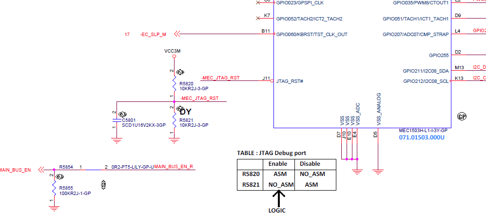

            2. Your SIO is MEC1503 so probably your single chance to read/write SIO content is thru JTAG.
            This is my opinion, maybe some other member has better idea.

              I have SVOD3 programmer can you show me how to conect it to motherboard ?
