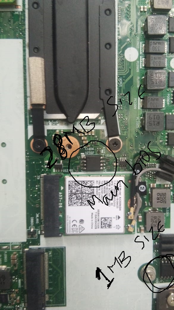

        • Paficator
          • Mar 2020
          • 13
          • France
          Re: Lenovo Thinkpad L15 (CPU 10th Gen) Supervisor Password
          Here is some pictures of the Motherboard.
          I'm not used to work on it
          • RethoricalCheese
            • Mar 2013
            • 1518
            • Estonia
            MX25L8006E is for sure thunderbolt 3 chip, nothing to do with bios/supervisor lock.
            Your bios chip is right next to wifi card. But the password is not there either. It's most likely in nuvoton chip.

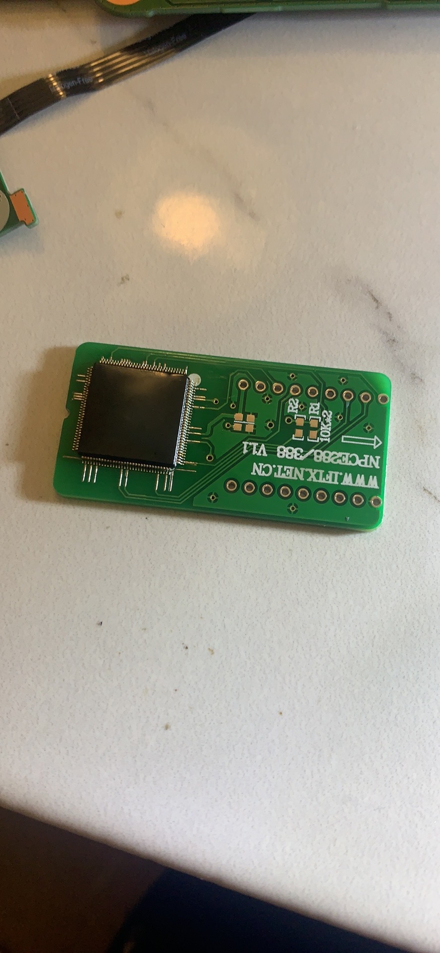

                    I can confirm that also, the chip is NPCE68APA0DX, I'm almost 99% positive that it does have different pin out than previous models. No keyboard settings worked, nor offline reading 👇🏼. The unit I'm working on is Ryzen.
                    The picture below is before I had placed the 2 10k resistors on designated pads.
                    No luck before or after.
                      Originally posted by imranromi
                      Yet not have solution bios or via Programmer.For programmer you need to config file in nuvoton npce68apa0dx.
                      But now not have schematic so very hard for unlock.
                      I find the config, the problem is that the chip have different protocol for read/write operation. So the developer of the software programmers (SVOD, Vertyanov, RT809H, etc.) need to come with a software update.
                      For the moment everybody is stuck !

                            • evserv
                              • Jun 2014
                              • 359
                              • Russia
                              NPCE68APA0DX
                              Not one of the programmers available to us can work with this chip yet.
                              The problem is not with the config file, this chip uses a different protocol for reading and writing.
                              We just have to wait for the programmer's author to add an algorithm to his programmer to work with this chip!

                                      • 21145
                                      Originally posted by evserv
                                      To support this chip, you need documentation describing the programming algorithm ...
                                      If anyone has this documentation please share with me.
                                      There are 2 dediprog programmers that have added support for the chip (july 2021). StarProg-U is the cheapest at $750 ,the adapter costs around 150 .Don`t know about the algorithm but you can find the chip ID if you search through the programmer software xml files .Maybe its downloaded from the dediprog server ?

                                      • maksoft121
                                        • Oct 2019
                                        • india
                                        There is another bios chip beside processor. i have the same issue lost the file in that chip.
                                        please upload file from main bios.
                                        the size may vary from 24mb to 30mb.
                                        the file from second bios is 1 mb .
                                        both needed to run the laptop.
                                        lost one. please upload it for me.
                                        thank you in advance .
