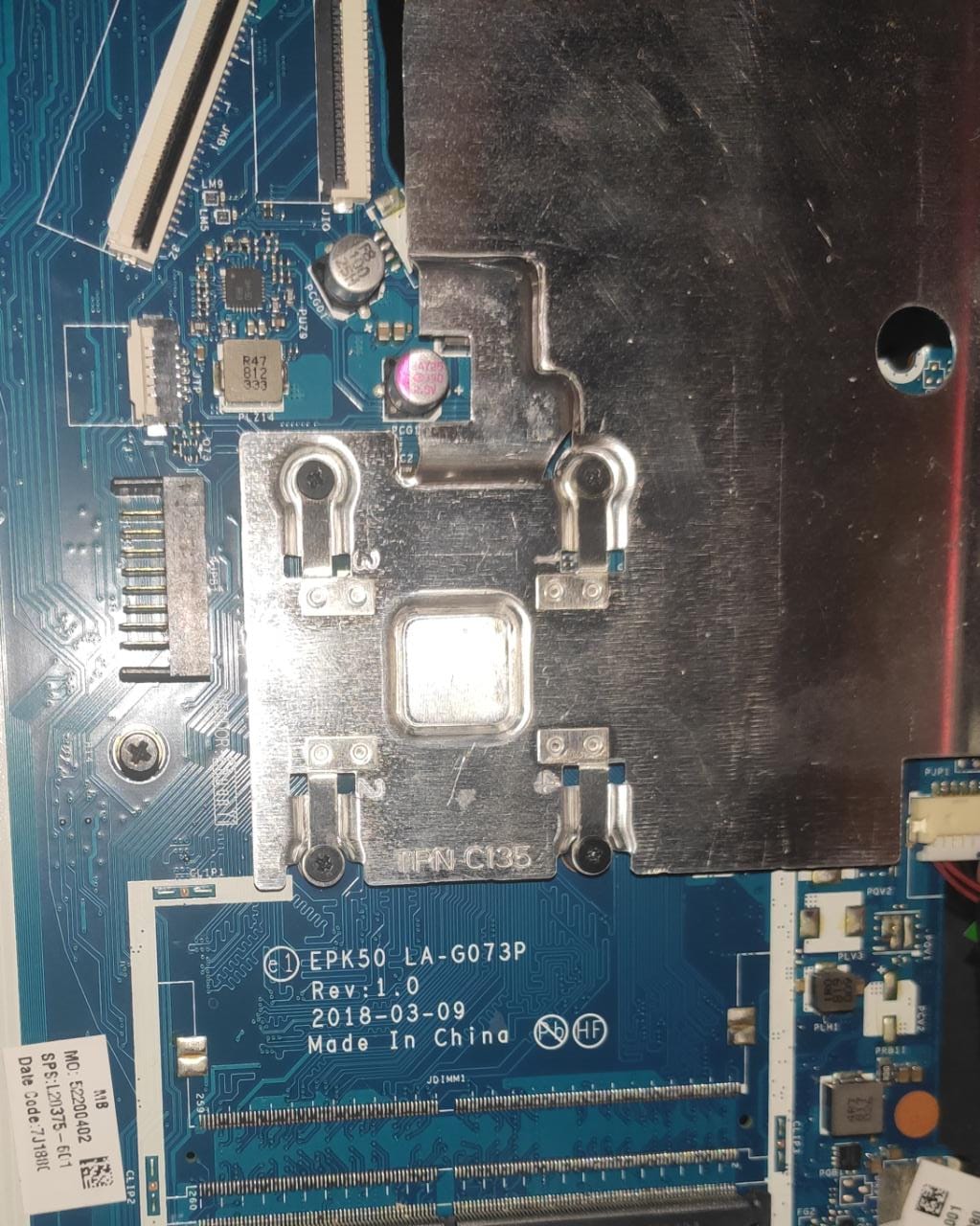

    Hello friends, i have a HP 15-da0002la with motherboard EPK50 LA-G073P rev 1.0, with the next error code, the caps lock blinks 5 times slow and then 3 times quickly, does somebody have the bios dump of this machine? or does somebody have more information about this error code ? thanks a lot.

            Re: EPK50 LA-G073P Bios dump need
            Mine does the exact same thing, just took out the MOBO found some rusted CAPS below the CPU
            I've cleaned them, checked the Tension fall on BIOS seems ok, let's cross fingers

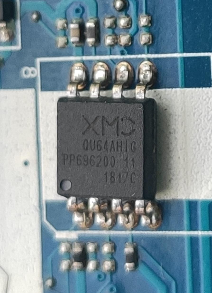

              HP Notebook 15-da0019la (EPK50 LA-G073P)
              Hi, dear friends!
              Computer: HP Notebook 15-da0019la
              MoBo: EPK50 LA-G073P Rev: 1.0
              BIOS chip: XMC QU64AHIG
              I have this laptop with a frozen BIOS because of a Windows update. I already tried to reprogram the flash memory with a EZP2019 programmer (the autodetect doesn't work for the chip, so I used the W25Q64 chip option at 6 MHz, but not sure if this is correct way), unfortunaley, when I turn on the laptop it just blinks the code 5.3 in the caps lock.
              Besides, I found out that at the HP site for the model there is a software tool (https://support.hp.com/us-en/drivers...model/21909979) that extracts the BIOS file, but there are 6 different bin files (3 with 16MB size and the other 3 with 8MB size) plus another 6 files with .s12 extension (with the same names as the bin and 1KB size each one), with these names:
              084A6 -- 8MB
              084A8 -- 8MB *
              084AA -- 8MB *
              086B3 -- 16MB
              086C1 -- 16MB
              08532 -- 16MB
              According to the BIOS chip, I need an 8 MB file, so I tried with those marked with an * from the previuos list. But it didn't work, just the appear the blinking code again. I'm here to see if anyone could share the correct BIOS file (or a dump from the same laptop model), or if really worth it to try with the last 8 MB file; beacause I already de-soldered the chip twice. So, I think this is my last chance before a possible damage to the MoBo.
              I really apreciate your comments and help!

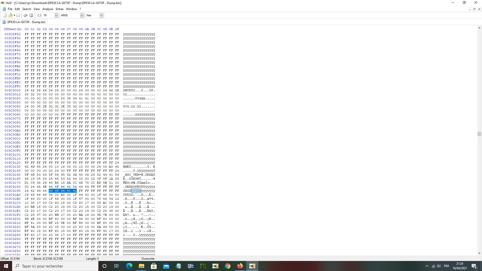

                        • bachir2004
                          • Feb 2015
                          • 437
                          • maroc
                          Re: HP Notebook 15-da0019la (EPK50 LA-G073P)
                          Originally posted by el panke
                          did u get the file?
                          using hxd,you can see what is the MB bid.
