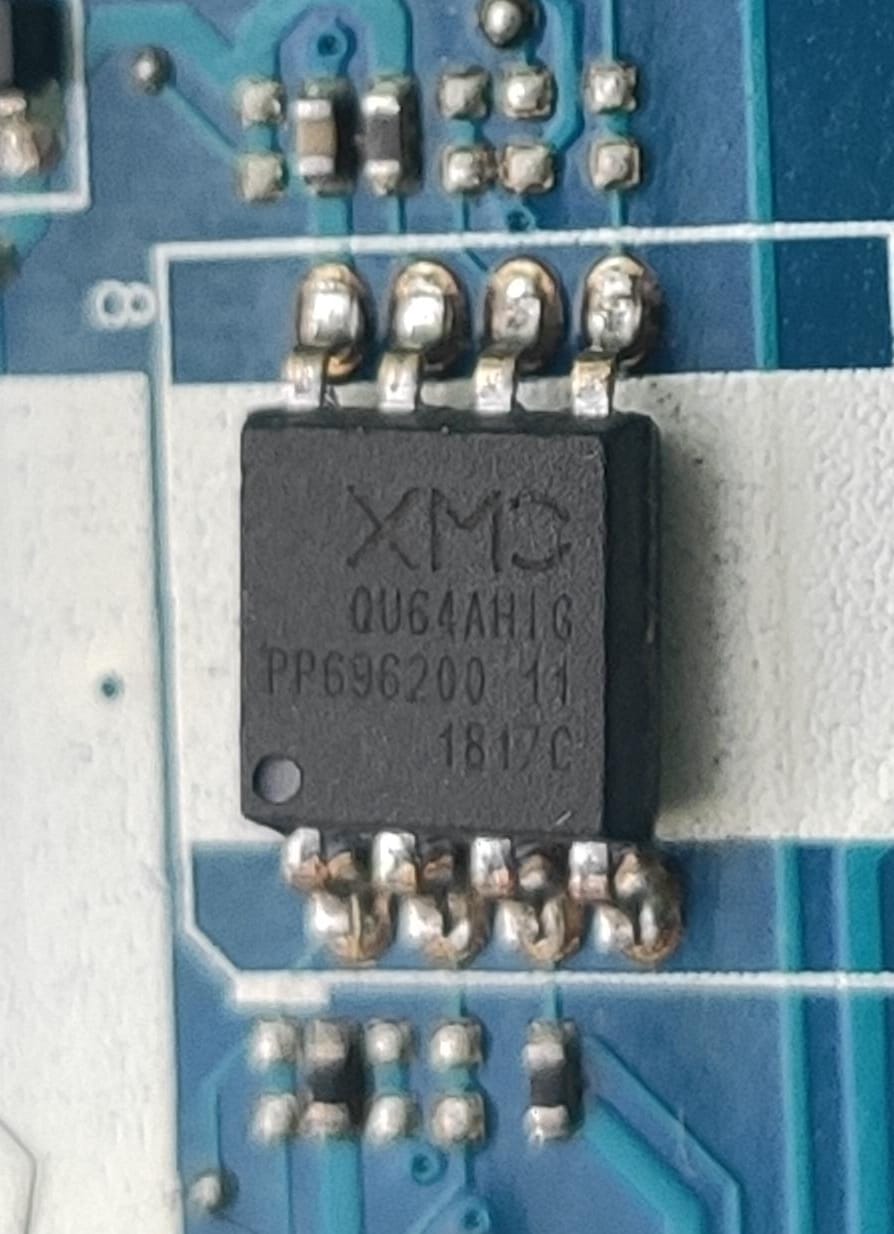

              HP Notebook 15-da0019la (EPK50 LA-G073P)
              Hi, dear friends!
              Computer: HP Notebook 15-da0019la
              MoBo: EPK50 LA-G073P Rev: 1.0
              BIOS chip: XMC QU64AHIG
              I have this laptop with a frozen BIOS because of a Windows update. I already tried to reprogram the flash memory with a EZP2019 programmer (the autodetect doesn't work for the chip, so I used the W25Q64 chip option at 6 MHz, but not sure if this is correct way), unfortunaley, when I turn on the laptop it just blinks the code 5.3 in the caps lock.
              Besides, I found out that at the HP site for the model there is a software tool (https://support.hp.com/us-en/drivers...model/21909979) that extracts the BIOS file, but there are 6 different bin files (3 with 16MB size and the other 3 with 8MB size) plus another 6 files with .s12 extension (with the same names as the bin and 1KB size each one), with these names:
              084A6 -- 8MB
              084A8 -- 8MB *
              084AA -- 8MB *
              086B3 -- 16MB
              086C1 -- 16MB
              08532 -- 16MB
              According to the BIOS chip, I need an 8 MB file, so I tried with those marked with an * from the previuos list. But it didn't work, just the appear the blinking code again. I'm here to see if anyone could share the correct BIOS file (or a dump from the same laptop model), or if really worth it to try with the last 8 MB file; beacause I already de-soldered the chip twice. So, I think this is my last chance before a possible damage to the MoBo.
              I really apreciate your comments and help!

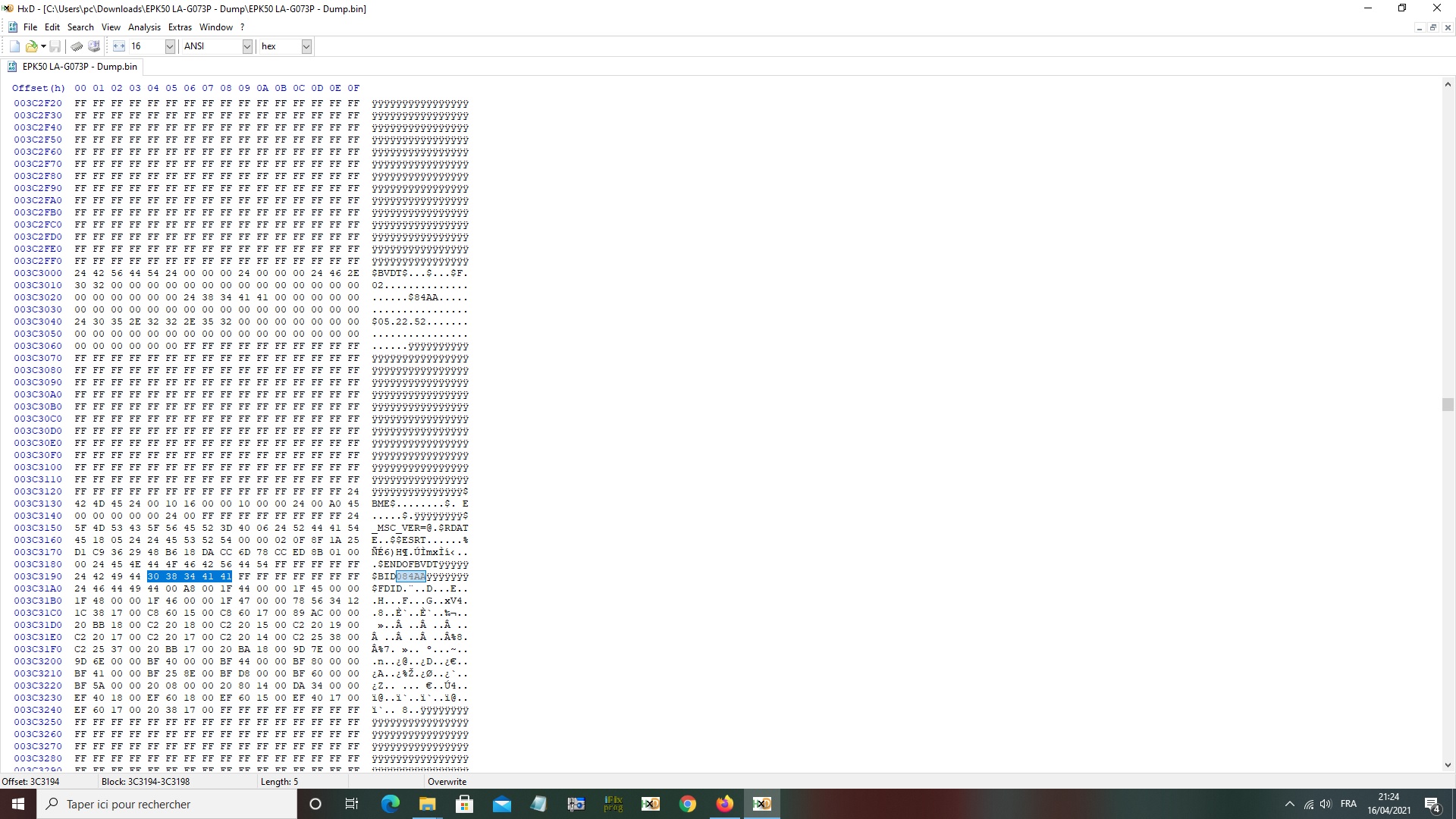

                        • bachir2004
                          • Feb 2015
                          • 439
                          • maroc
                          Re: HP Notebook 15-da0019la (EPK50 LA-G073P)
                          Originally posted by el panke
                          did u get the file?
                          using hxd,you can see what is the MB bid.
                          • el panke
                            • May 2019
                            • 78
                            • argentina
                            i mean if he found the bios file that fixs it
                            the file posted here doesn't work
                              • 21679
                              The bios file posted here won`t work,its corrupt,also its been booted on another machine its "initialised" . Clean ME/TXE firmware will be in a "Configured" clean state. You can check it for yourself with MEAnalyzer - https://github.com/platomav/MEAnalyzer/releases
                              Post your original bios backup if you have one .
                              • el panke
                                • May 2019
                                • 78
                                • argentina
                                heres bios backup
                                hp 15 da0051la
                                  • 21679
                                  Your bios BID is the same as the OP , BID084AA .The link to the bios is in the first post,run the exe to copy the 8MB 084AA.bin .Program the bios, then enter your DMI info using wndmifit/HP Bios config utility .
