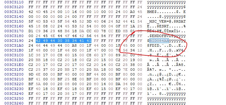

      Your bios BID is the same as the OP , BID084AA .The link to the bios is in the first post,run the exe to copy the 8MB 084AA.bin .Program the bios, then enter your DMI info using wndmifit/HP Bios config utility .

          did you flash the right bios,check the bios BID in your original backup

            Re: HP Notebook 15-da0019la (EPK50 LA-G073P)
            Yes,
            The laptop turns on after the flash, but turns off after 10-15 seconds,
            It was like that several times (5 times), after that I couldn't turn it on
            what can happen to him?
            PS: when I take out the RAM it doesn't flash 3 times and it should ,,, be 5.3 again ... it doesn't register that the RAM has been taken out

              Post the original bios backup
