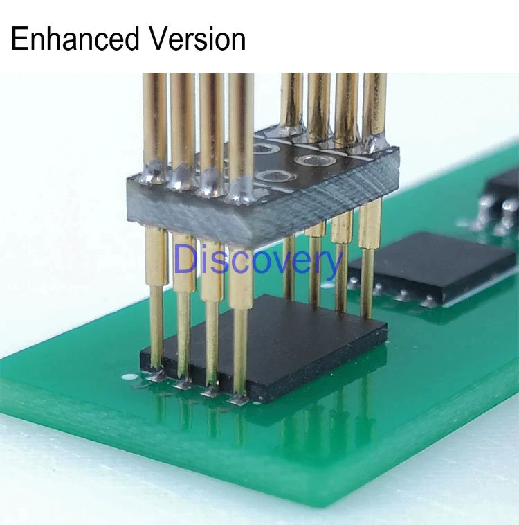

    The dump can be made with a CH-341 programmer, but you need to have a connector for MSI board (the connector is JTPM1) or an special clamp for WSON 8x6 packages - something like this:
    I attach the boardview and schematics for this board, if one would need it.

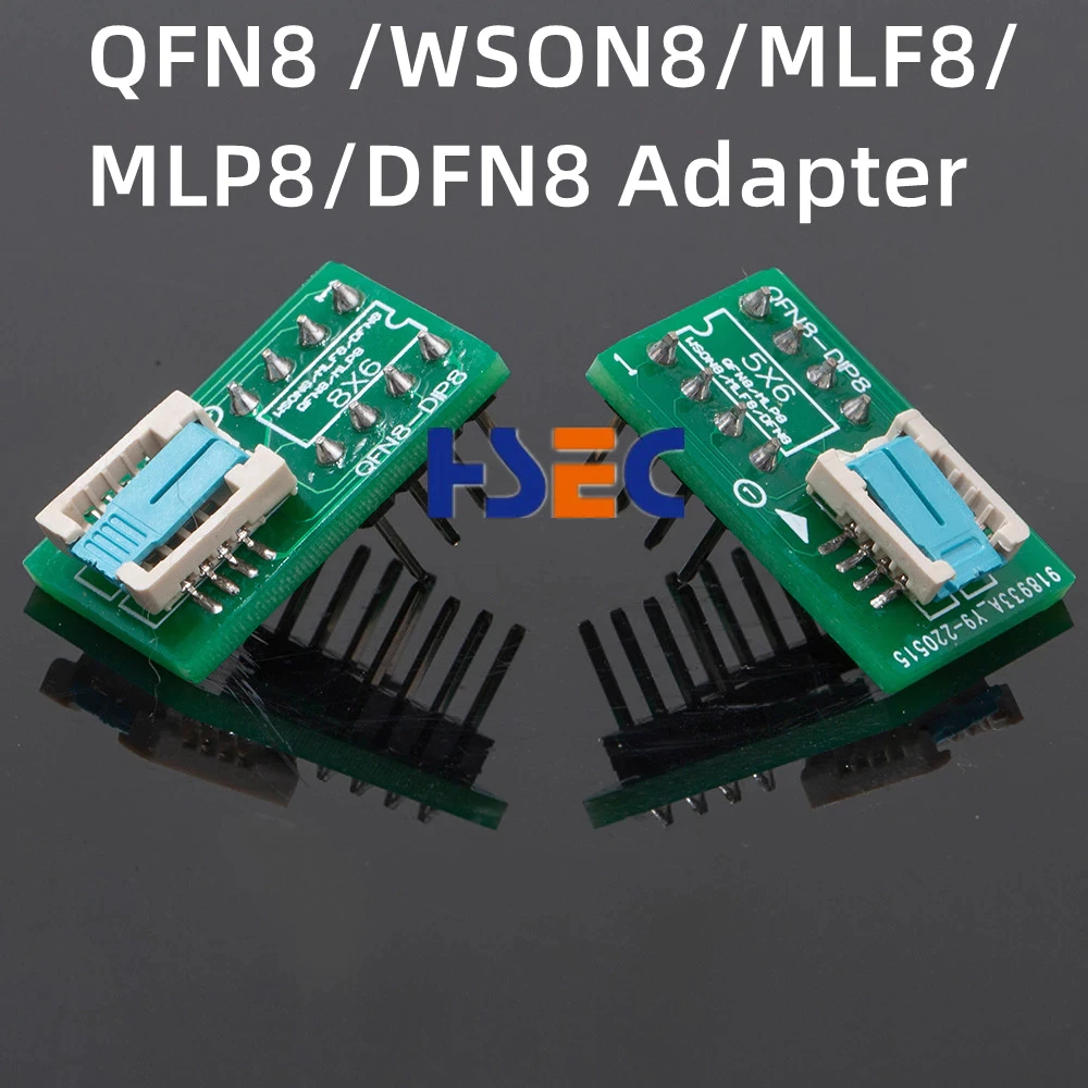

    Alternatively it would require to desolder the BIOS form the board and to have a WSON8-DIP8 adapter for CH341 - something like this:
    Note that desoldering requires some good knowledge how to do it, so don't do it if you are not experienced - the WSON bios package has a big thermo pad underneath, so it can be desoldered only with a preheater and heat gun, soldering iron is useless !!! The BIOS chip on the board is a Winbond W25Q256JWEQ (package is a 8-pad WSON 8x6 mm), so you can't use the standard clamp for normal BIOS chips.
