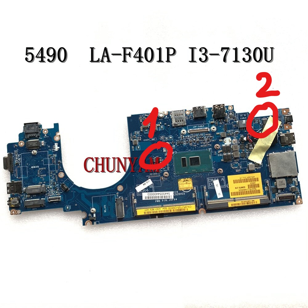

    Hi I need bios EC for DELL LA-F401P REV 1.0 A00
    My old is deleted, i try some files in forum but all corrupted

    What's your laptop model / serial

      s/n 79x6rq2
      reg model p72g
      I upload main bios here orginal one
      EC bin is all clear

          Deleted from where , which chip is it deleted from. This board has an MEC5105 doesn`t it ?

            Board have another chip
            chip 1 is bios I upload here
            chip 2 is empty inside
              • 20758
              Re: Ec Bios dump for DELL LA-F401P REV 1.0 A00
              Whats the part number on chip 2 ,it should be a small size,maybe for the thunderbolt firmware.It could be for the EC ,not sure

                25q80csig

                  i have a this same board and the super IO (mec5105) needs replacing because it causes a short on rtc_cell . how do you reprogram these chips?

                    i have same problem my EC bin is all clear . any help ? Ec Bios dump for DELL LA-F401P REV 1.0 A00

                      post S/T, full name and model,post the contents of the bios chip even if it is corrupted.. ,etc.
