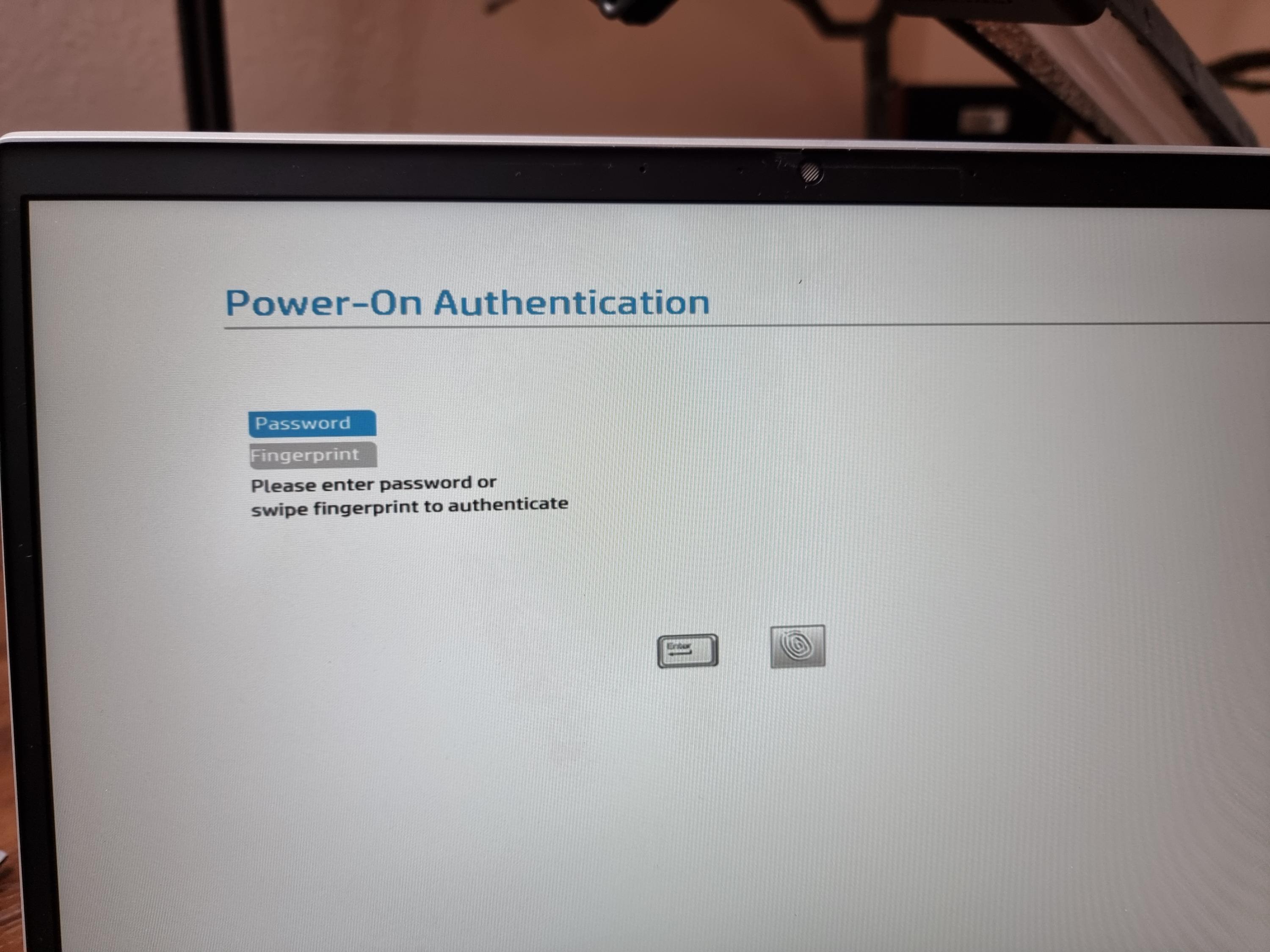

        #63
        Re: HP EliteBook 845 G7 BIOS Pass
        Originally posted by SMDFlea
        Wipe the dust off and try this bios,flash it only to the bottom one. Set bios defaults as soon as it boots
        Took me almost a year, but alas I did as instructed.
        The pc said someting about doing a bios backup and then it says HP Endpoint Security Controller Problem (Pic 1 in attachment)
        I can press enter okay and then I'm back at the familiar despised Power-On Authentication (Pic 2 in attachment)
        I spent more time repairing this notebook than using it...
        So what next?

          #64
          Originally posted by sh4rp
          So what next?
          Next - program both spi chips with the corresponding files from the attached archive and you're good to go.

              #66
              Works like a charm! Thanks alot!

                #67
                You're welcome. You had to wait a really long time to solve the problem, but at the end your patience was rewarded. Have fun!
