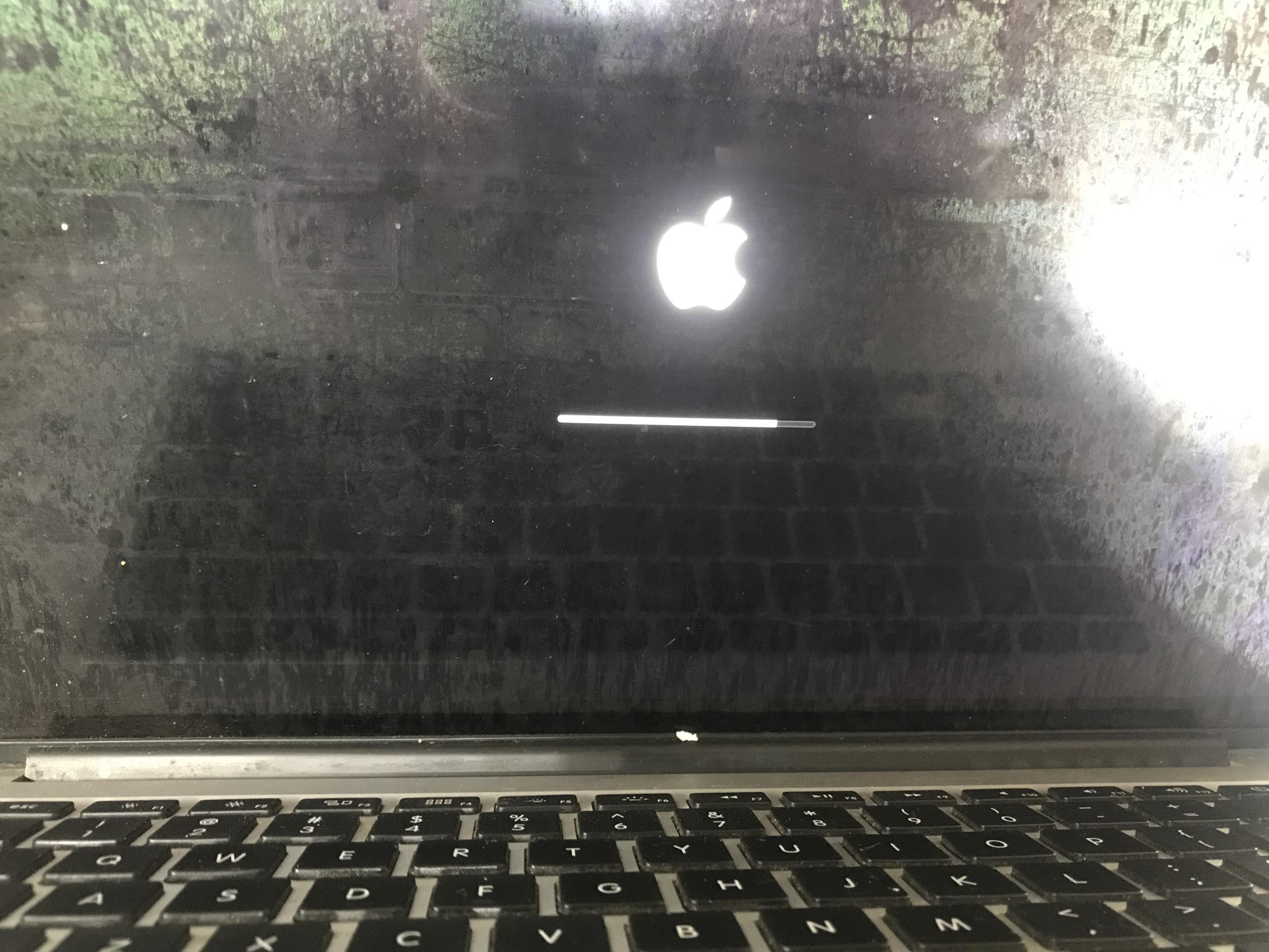

    Hi guys, please help me fix my BIOS dump (clean ME as well if possible), it's slow on loading bar and stuck on apple logo when loading bar 25-50%

          Re: MBP15 2013/2014 A1398 (820-3787-A) stuck on loading bar apple logo
          Originally posted by Ghamidi
          try...
          chime on, blank image, nothing on screen...
          try with another GOOD BIOS chip, same...blank display, nothing on screen.
          try using old BIOS dump, image shown, apple logo (slow)...
              Originally posted by CraterM
              Try original dump, without battery!
              I did, when loading bar almost finish, it stuck...

                • guzq
                  • May 2017
                  • 54
                  • Indonesia
                  try...
                  Sorry for late post...
                  Amazing...this one working
                  Thanks Ghamidi like always
