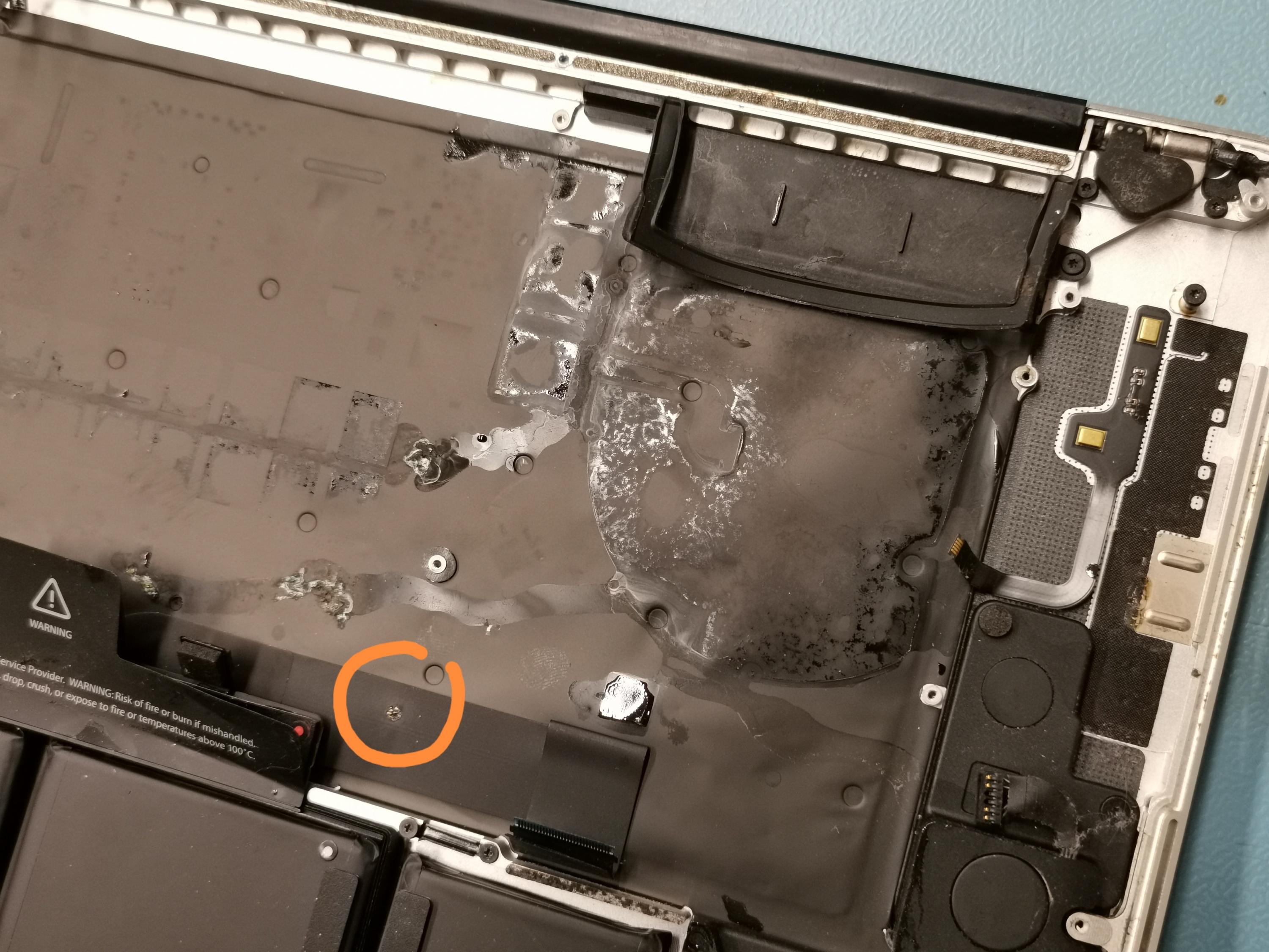

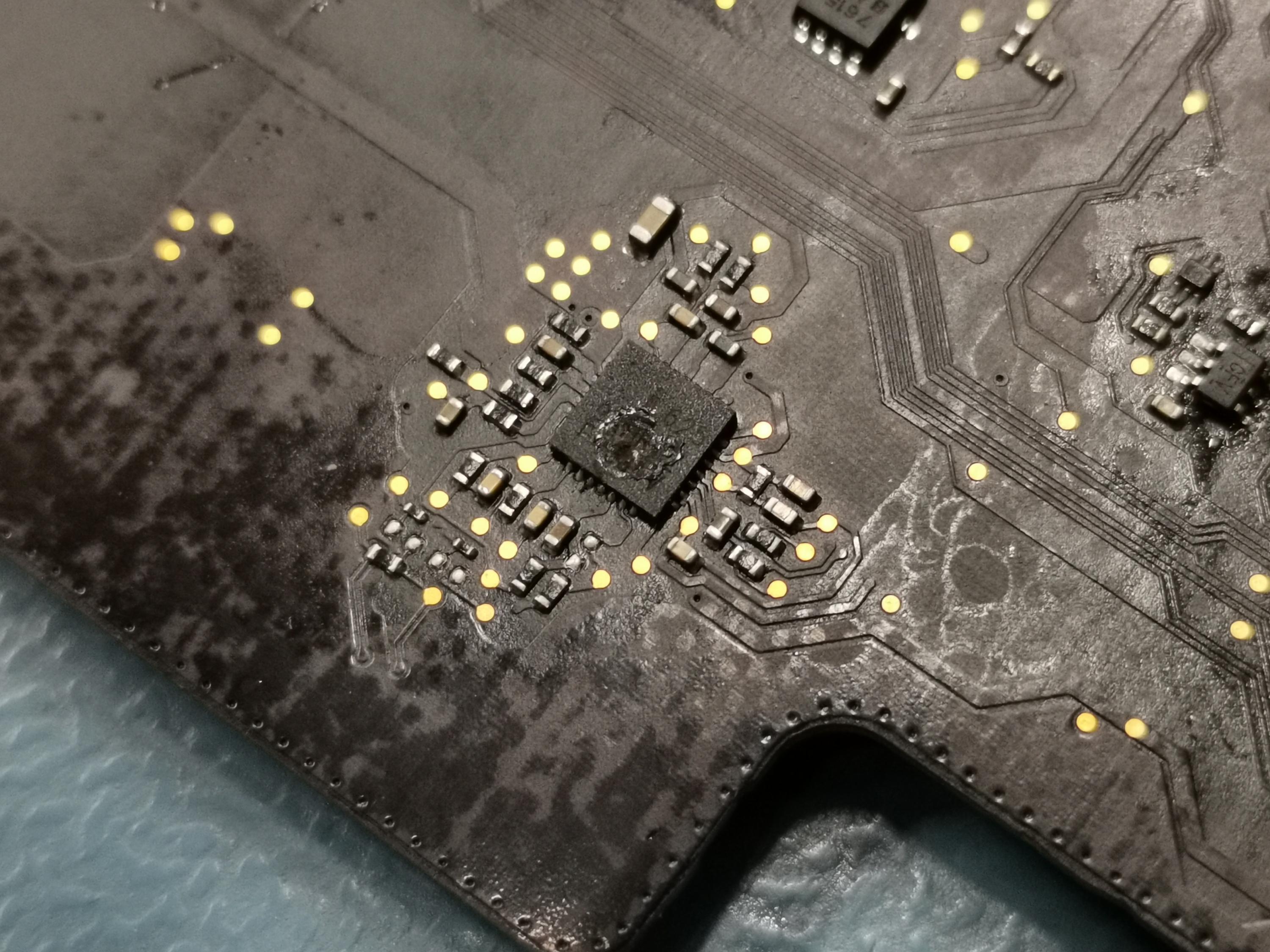

    Got machine with liquid damage - Apple MacBook Pro 15-Inch "Core i7" 2.5 Mid-2014 (DG). Wasn't powering on completely. After inspection got the idea that charging IC is blows and couple more places of corrosion (swapped few more components form doner board).
    I have a spare working logic board with irrelevant physical damage (just a donor board to me now) Apple MacBook Pro 15-Inch Mid-2014 (IG).
    Replaced U7100 (ISL 6259) from it - powers on OK now, though battery is not getting detected. Battery is tested and is good working one, tried it on another machine. Eventually just to be sure bought a NEW chip from eBay - replaced again - same thing - no battery detected in OS, nor does it charge or powers off it.

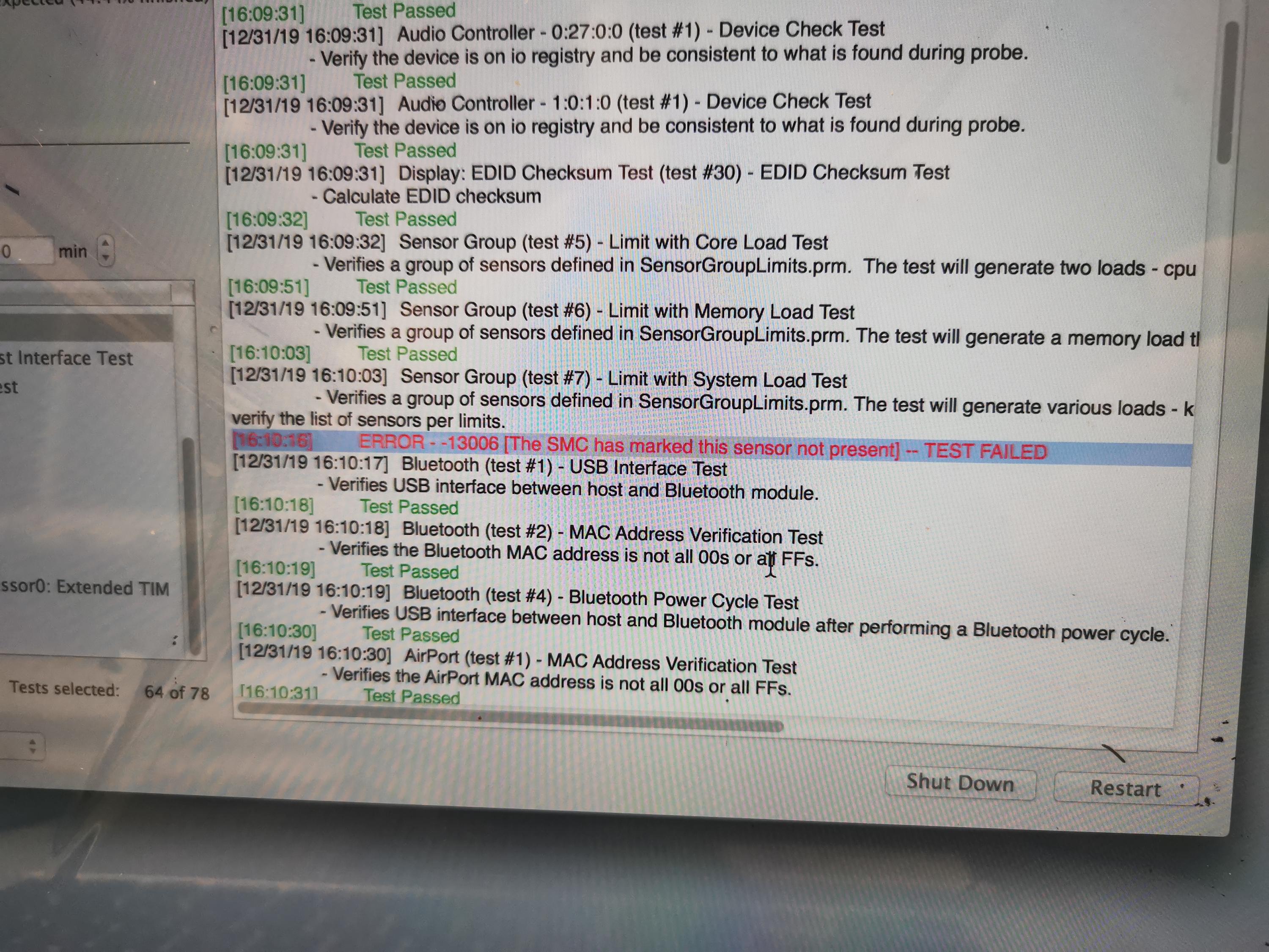

    Tested it with ASD. Reports a bad sensor..
    Sensor Group (test #7) - SensorGroupLimits.prm

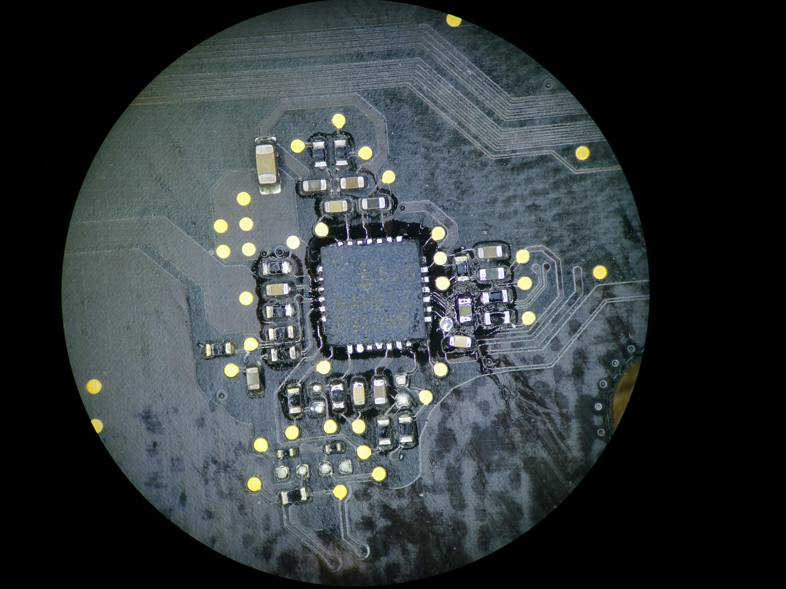

          Right, I got frustrated with this MBP to say the least Few days ago I realised that accidently knocked off one little bit next to charging chip (ISL625), which I tried to reseat once again as I thought maybe there was an issue with it. At this stage have two working ones. Got it sorted, than have put missing bit next to it from donor board.

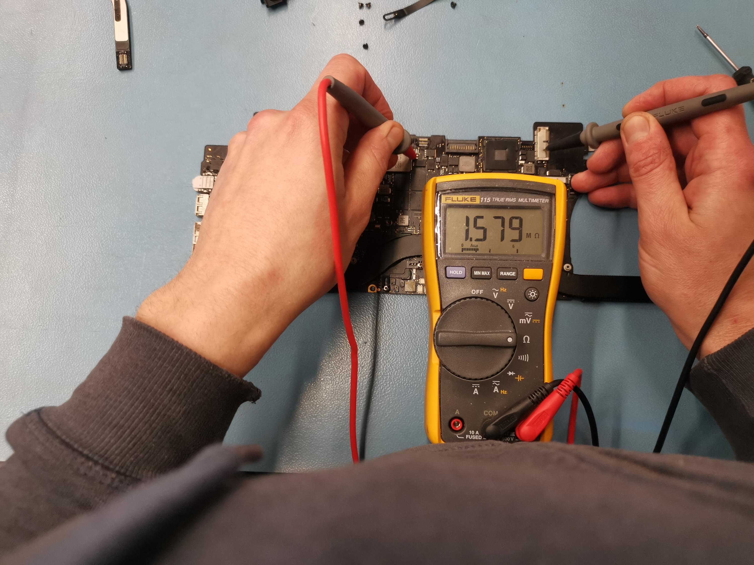

          When MagSafe 2 gets attached only from cold boot light goes to Orange than it starts to fade away slowly until completely off, no fan spin tho. Consequent reattachment of MagSafe 2 power just leads to nothing. Checked resistance as you suggested on F7140 after all that with everything disconnected and it's 1.579. Does that mean that there is a 'leak' to ground now?

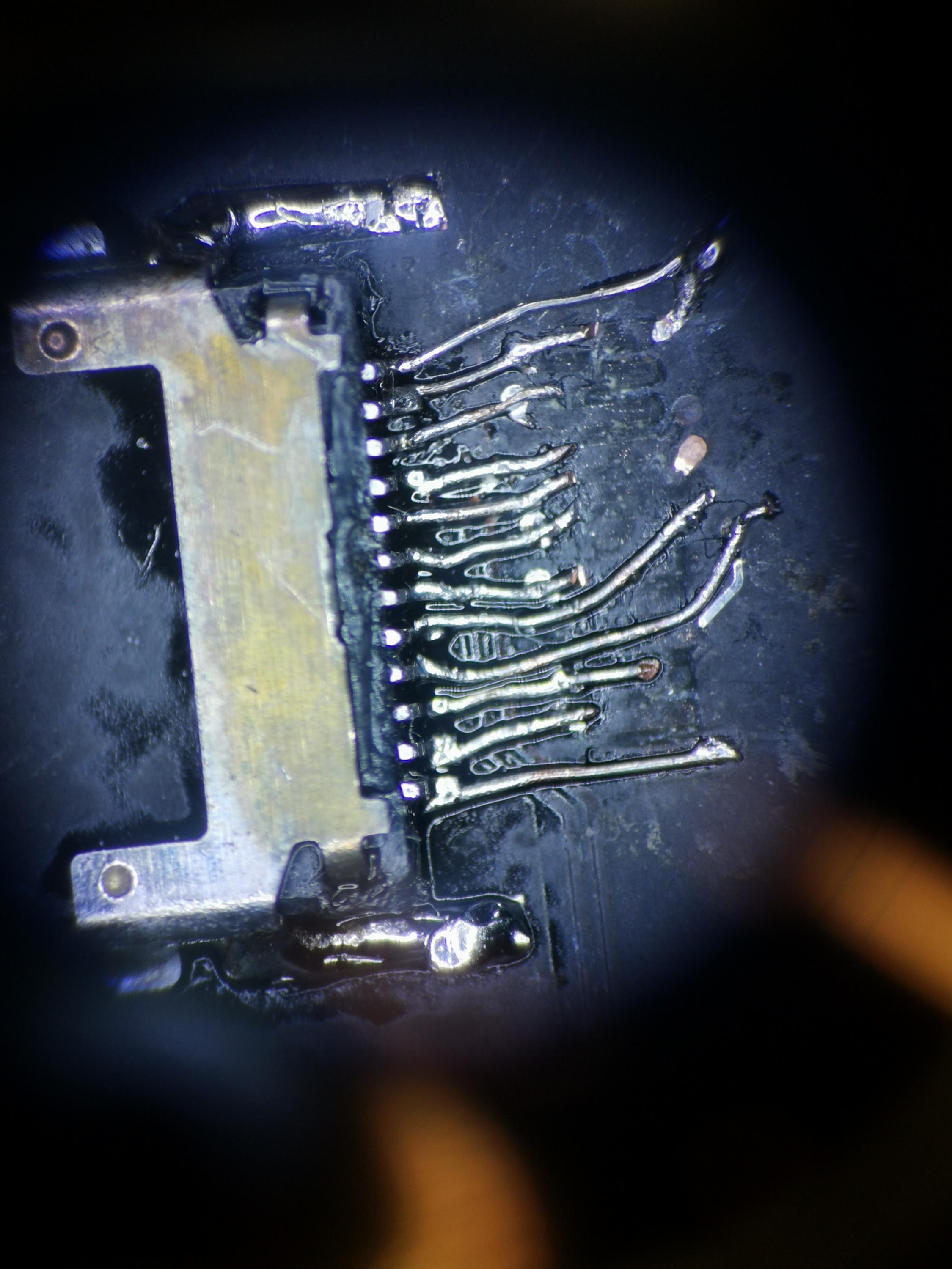

          Reason why I wanted to get this board working rather than my donor board is that it has a dedicated GPU chip, however this donor board had a ripped iSight connector and pads ruined. Got it from someone in this state, don't ask
          After realising that I'm getting stuck with my prefered board I've moved stuff to that i7 only logic board (my donor). Did some microsurgery as decided to attempt to move iSight connector to that donor board. It's a booting/posting board. Just waiting for a heatsink to fully test it..

          I still want to fix that initial board, will be getting more donors for bits and another iSight connector. Luckily desoldered it with no issues. Based on my resistance test - what is best to check further on it? (when I'll get new bits)

            Great pics. The meter shows a 'M' in the measurement so your resistance to ground is 1.579 mega-ohms = 1,579,000 ohms. That is, you definitely do not have a shorted capacitor on this power rail. This is good.
            Next, use the same resistance mode to check if the fuse F7140 is blown or not. Remove all power and check the resistance of the fuse.
            If the fuse is ~0 ohms, the fuse is good. Confirm it.
            If the fuse is blown, check the voltage on the other pin of this fuse.
