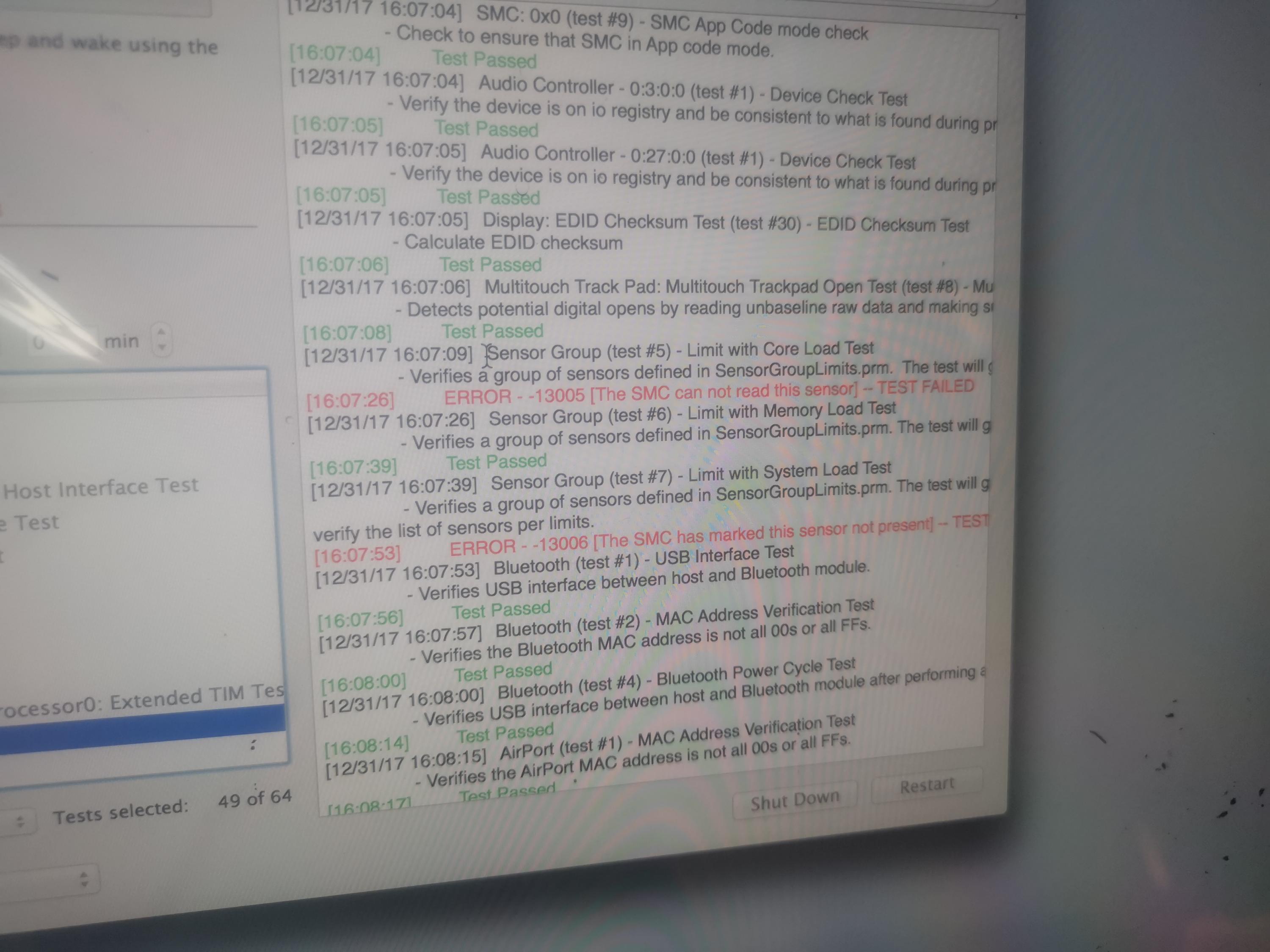

    Hi Guys,

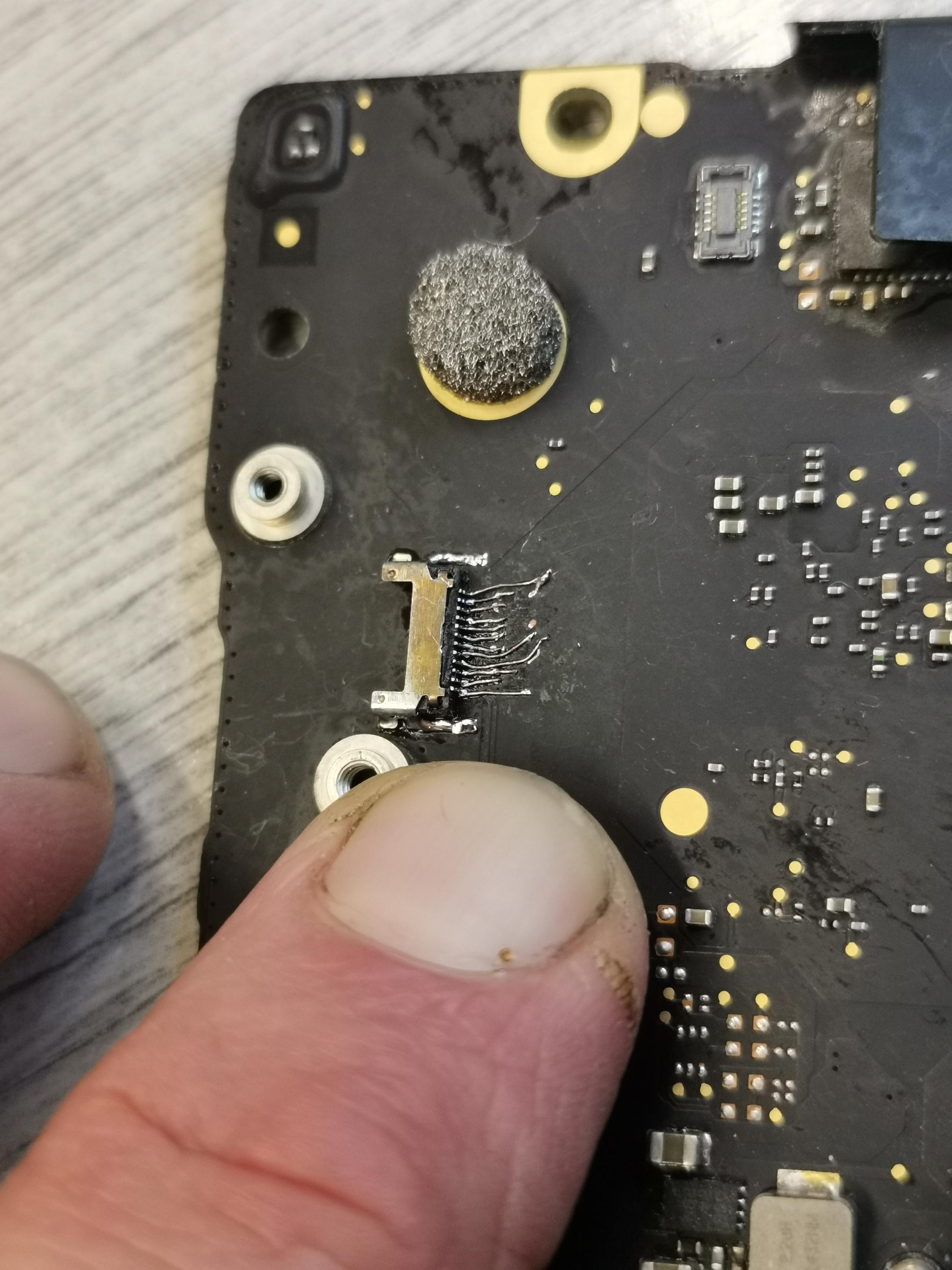

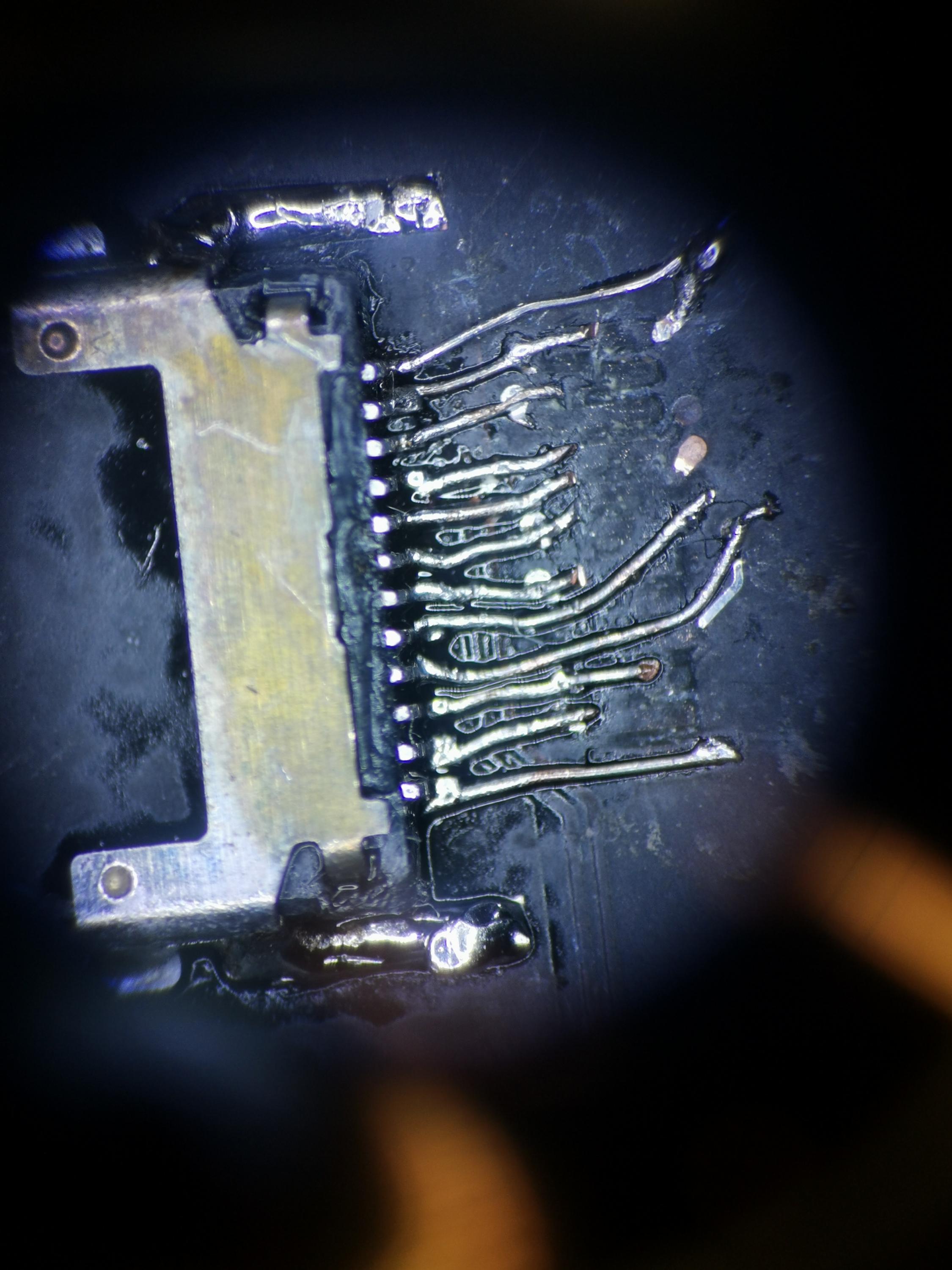

    I've got 2.2GHz i7 Logic board for MBP 15" A1398 Mid-2014 MacBook Pro. Received it with no past history. Did some microsurgery to move iSight adapter to it as it came to me with ripped pads for it and no connector. Have been waiting for a heatsink to arrive to start fully testing when assembled..

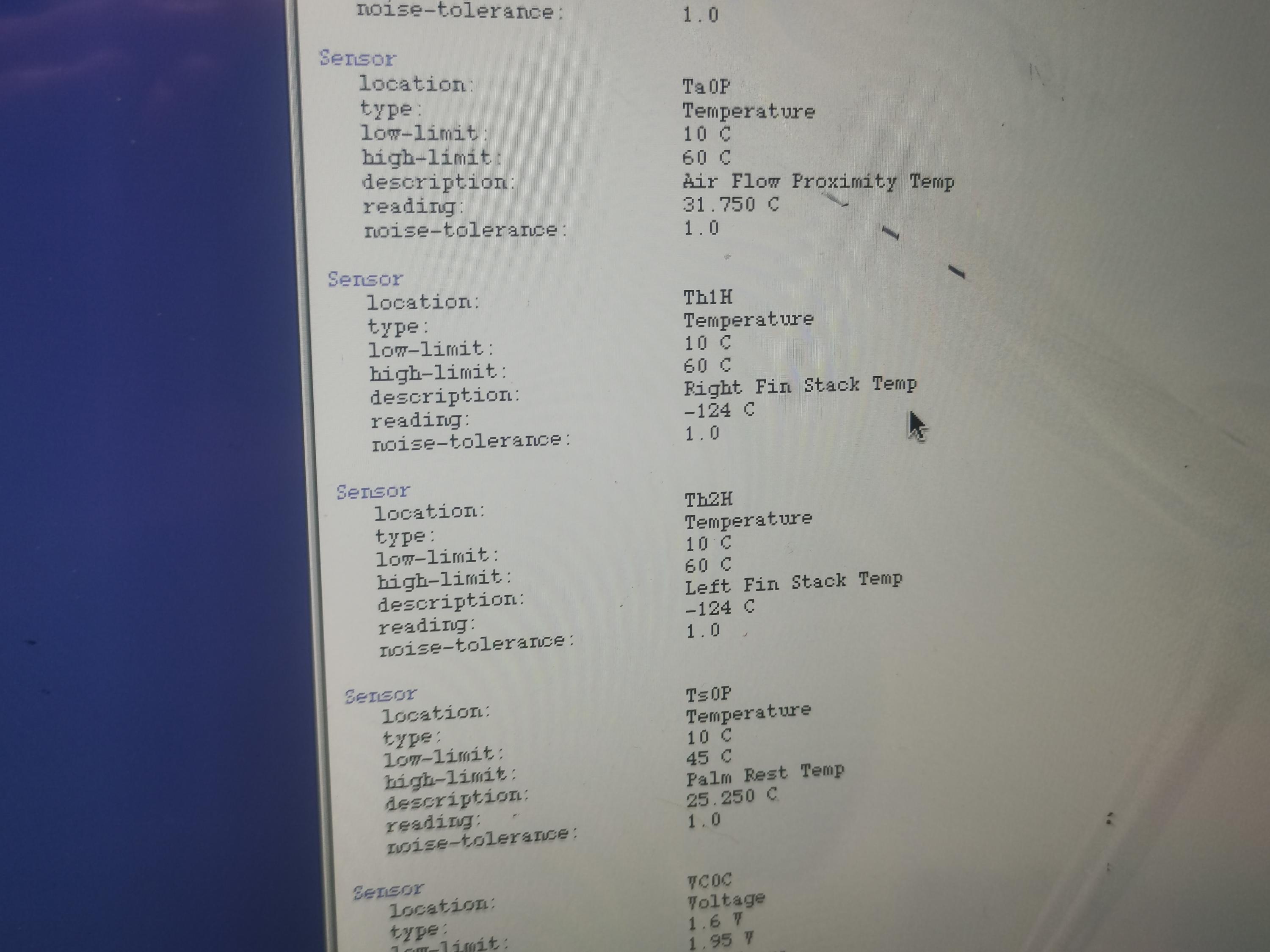

    Everything seems working: booting / charging, however FANS run on full blast (MAX FAN RPMS)
    Thought to check what ASD can point out and it gives no specific clue. It goes to certain point and then machine goes to sleep and does not come back on. Adding a pic in attachments.

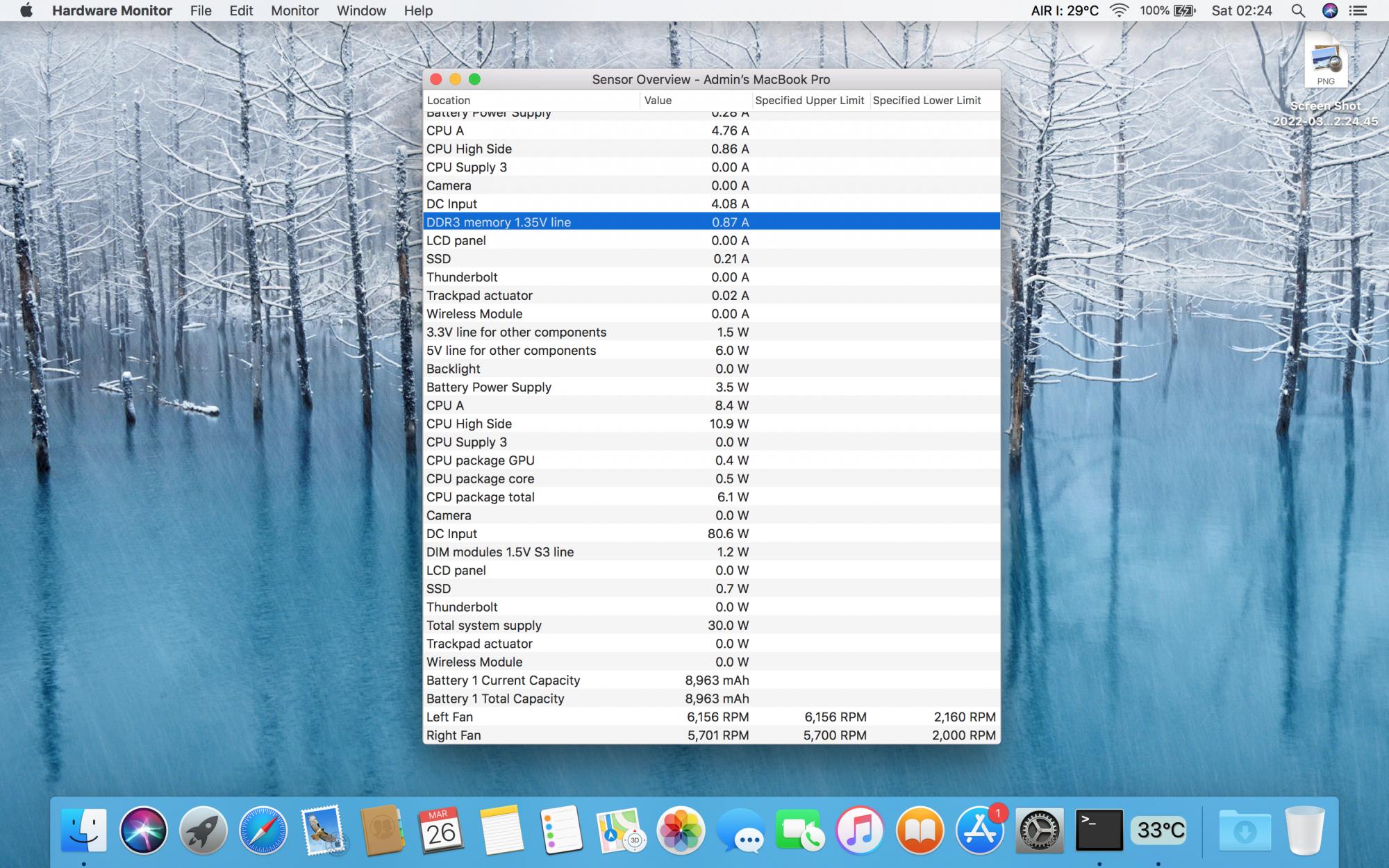

    Later have been searching around previous threads here and someone mentioned HardwareMonitor software, tried it to check - no issues with visible output TEMPS.. also in attachment.
    Any suggestion where to start checking? Got another board from 2014 for spare components - so anything I can replace is available.

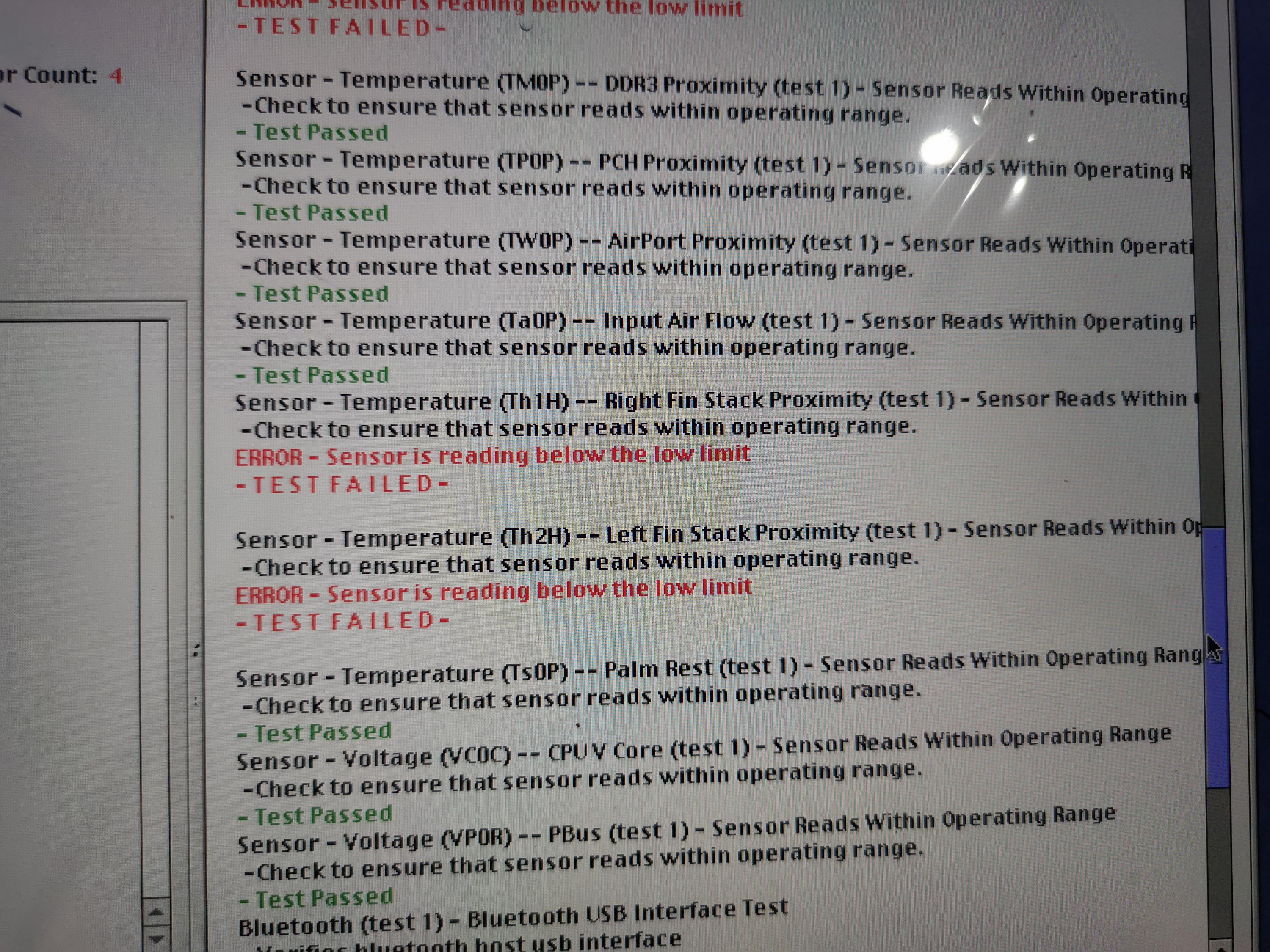

    Later on I've tried ASD EFI version instead of OS ASD, which apparently is more specific on sensors. Result provided in pics.
    EFI ASD reported faults with:
    Sensor - Temperature (TH1H) -- Right Fin Stack Proximity - Sensor is reading below the low limit.
    Sensor - Temperature (TH2H) -- Left Fin Stack Proximity - Sensor is reading below the low limit.
    Further I've checked Hardware Output values:
    TH1H Reading: -124°C
    TH2H Reading: -124°C

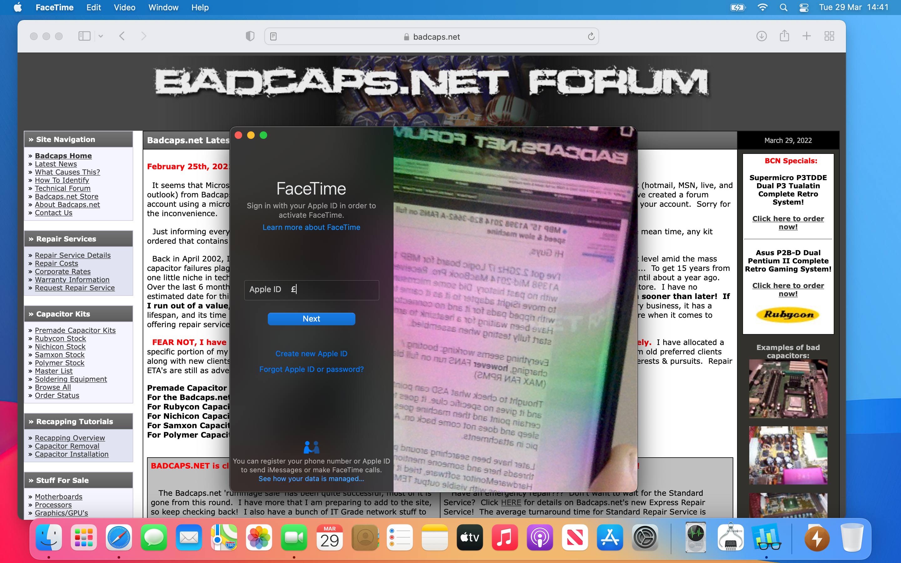

        It's all sorted basically. When you mentioned that J4002 uses same data line/ track I thought to double check what are the pins related to that. Basically due to MBP "panic mode" FANS full blast etc it was preventing me from using/checking camera so I wasn't even aware if I've done my micro-surgery correctly via testing it. It just displayed message - "Allow machine to cool down.."

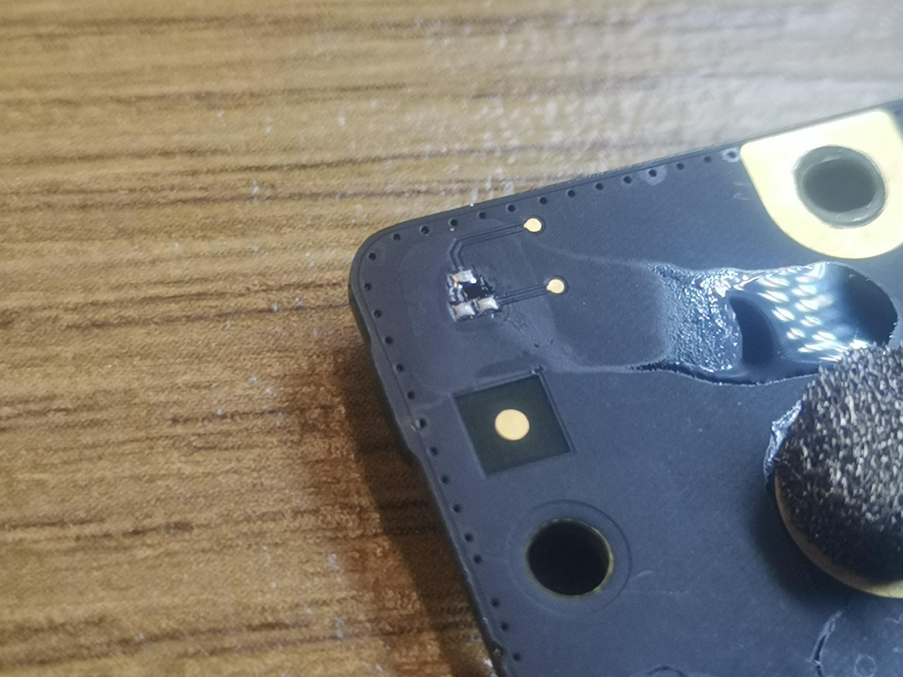

        Anyway.. the issue was - since all pads were ripped off, I've prepared points to attach to after that track. Thought OK it goes there so must do just that : )

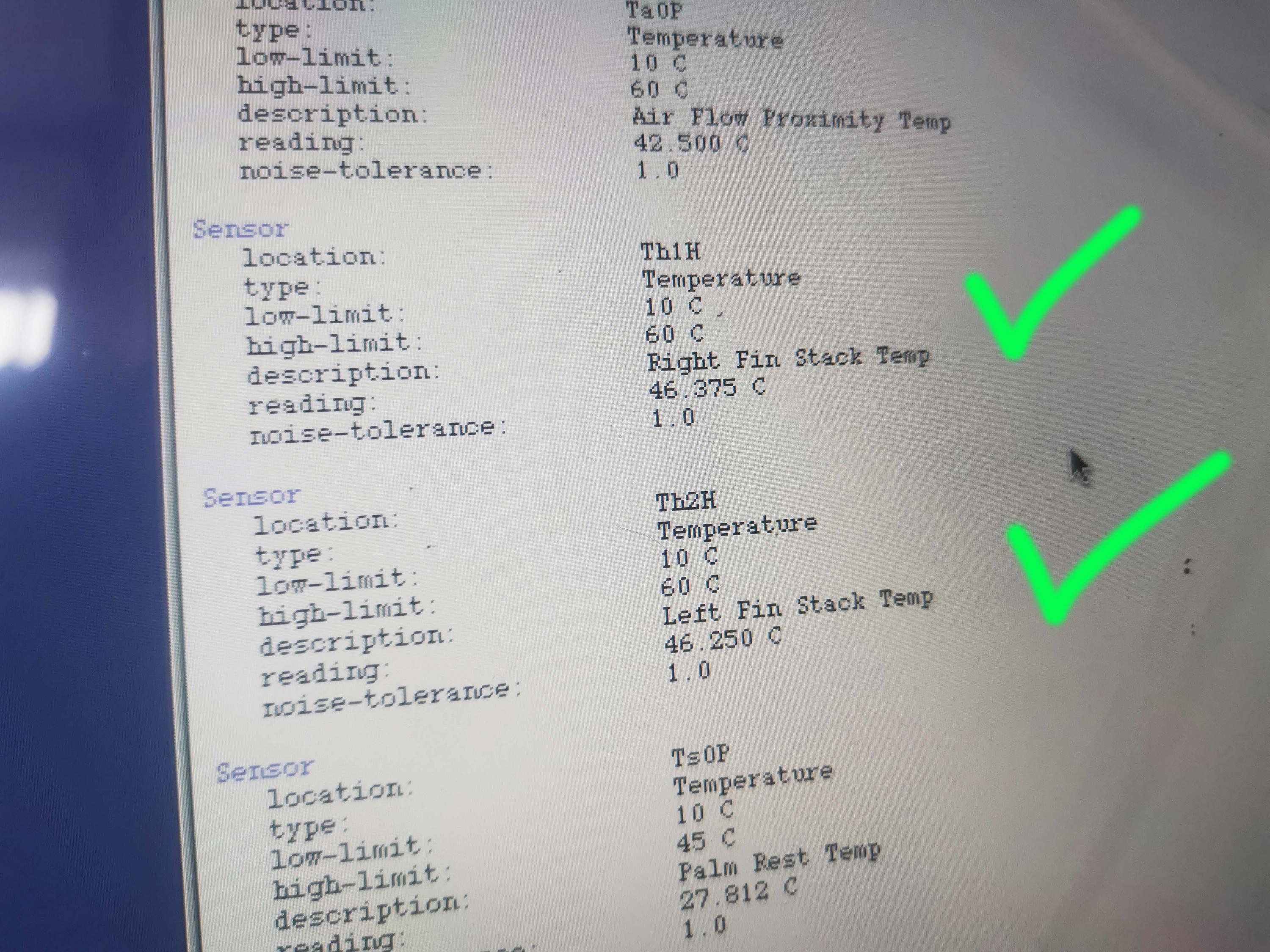

        Later I've restored the track itself to those two data line points behind the pads AND soldered pins onto those. Surprise, surprise TH1H and TH2H started reporting temps to SMC!
