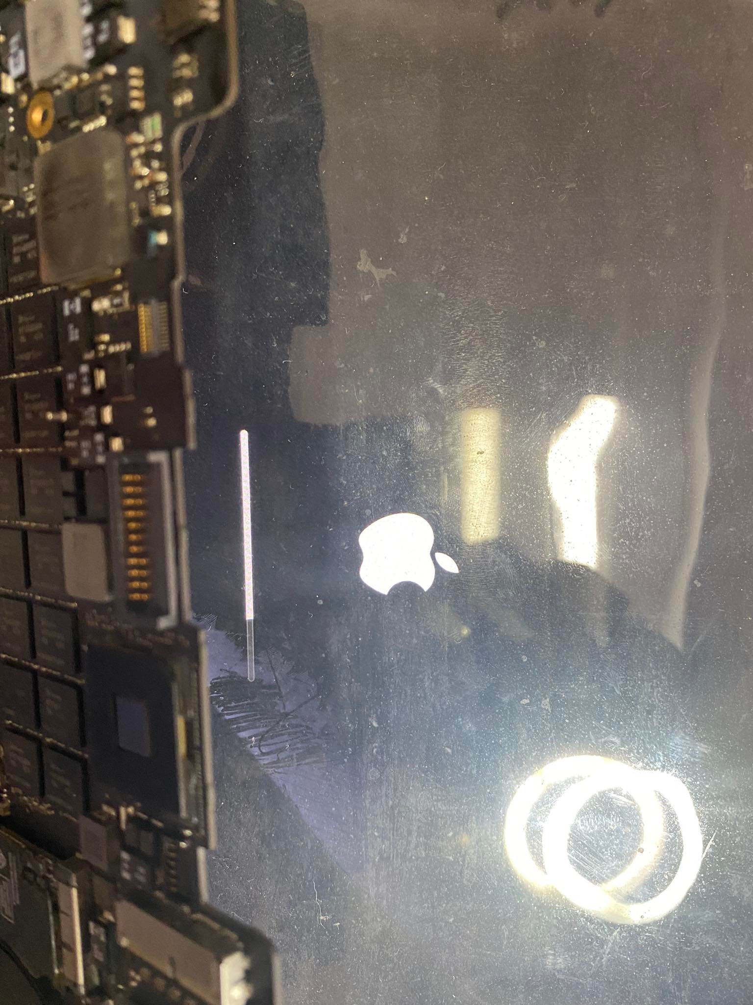

    Hi guys, please help me fix my BIOS dump (clean ME as well if possible), it's slow on loading bar and stuck on apple logo when loading bar 25-50%

          chime on, blank image, nothing on screen...
          try with another GOOD BIOS chip, same...blank display, nothing on screen.
          try using old BIOS dump, image shown, apple logo (slow)...
            Try original dump, without battery!

              I did, when loading bar almost finish, it stuck...

                  Sorry for late post...
                  Amazing...this one working
                  Thanks Ghamidi like always
