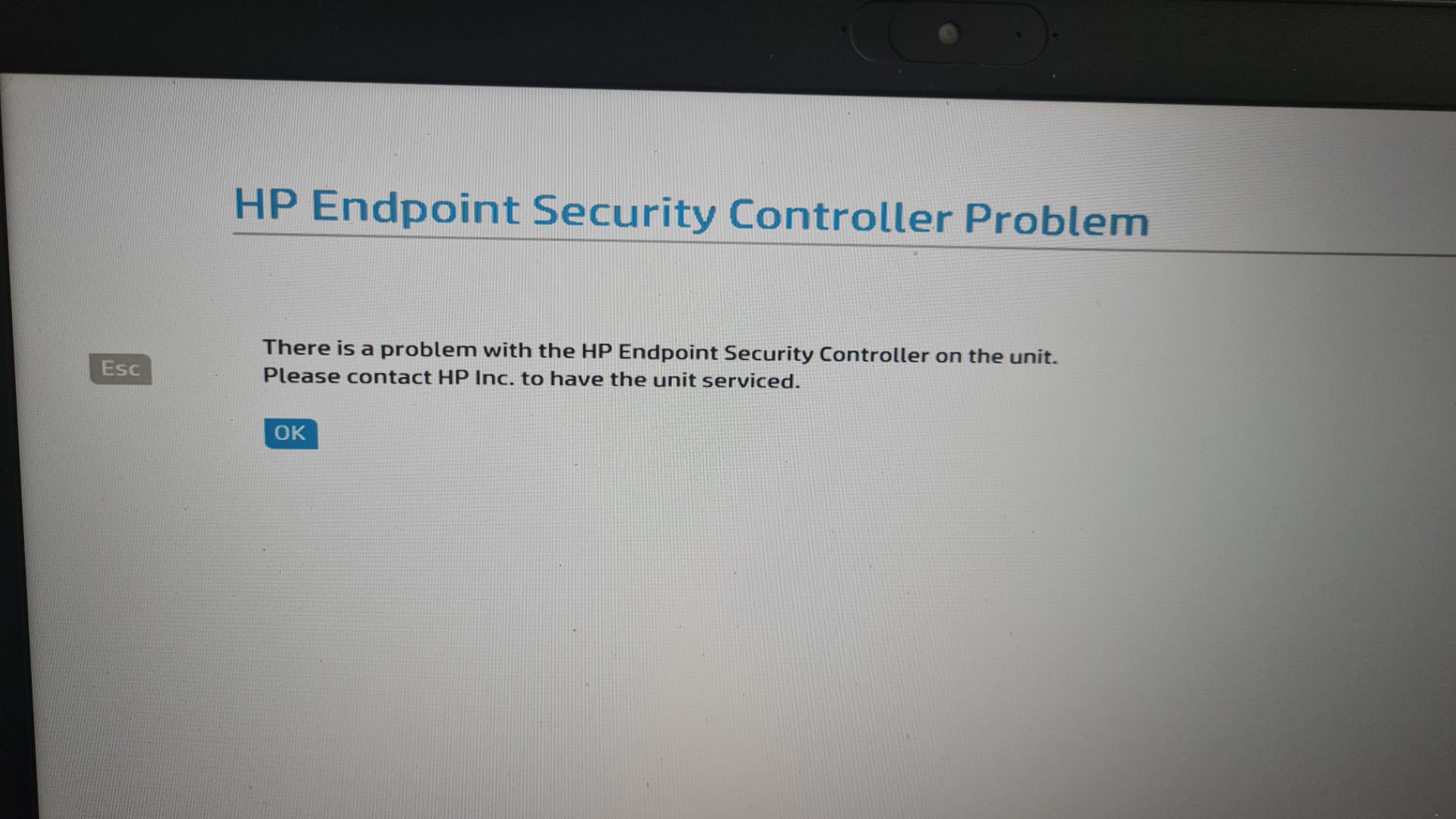

                  Re: hp 450 g7 password
                  Please help me to remove this error
                    Here

                          #72
                          Originally posted by hoaca388
                          Here
                          Black screen

                            #73
                            Black screen
                            Weird !
