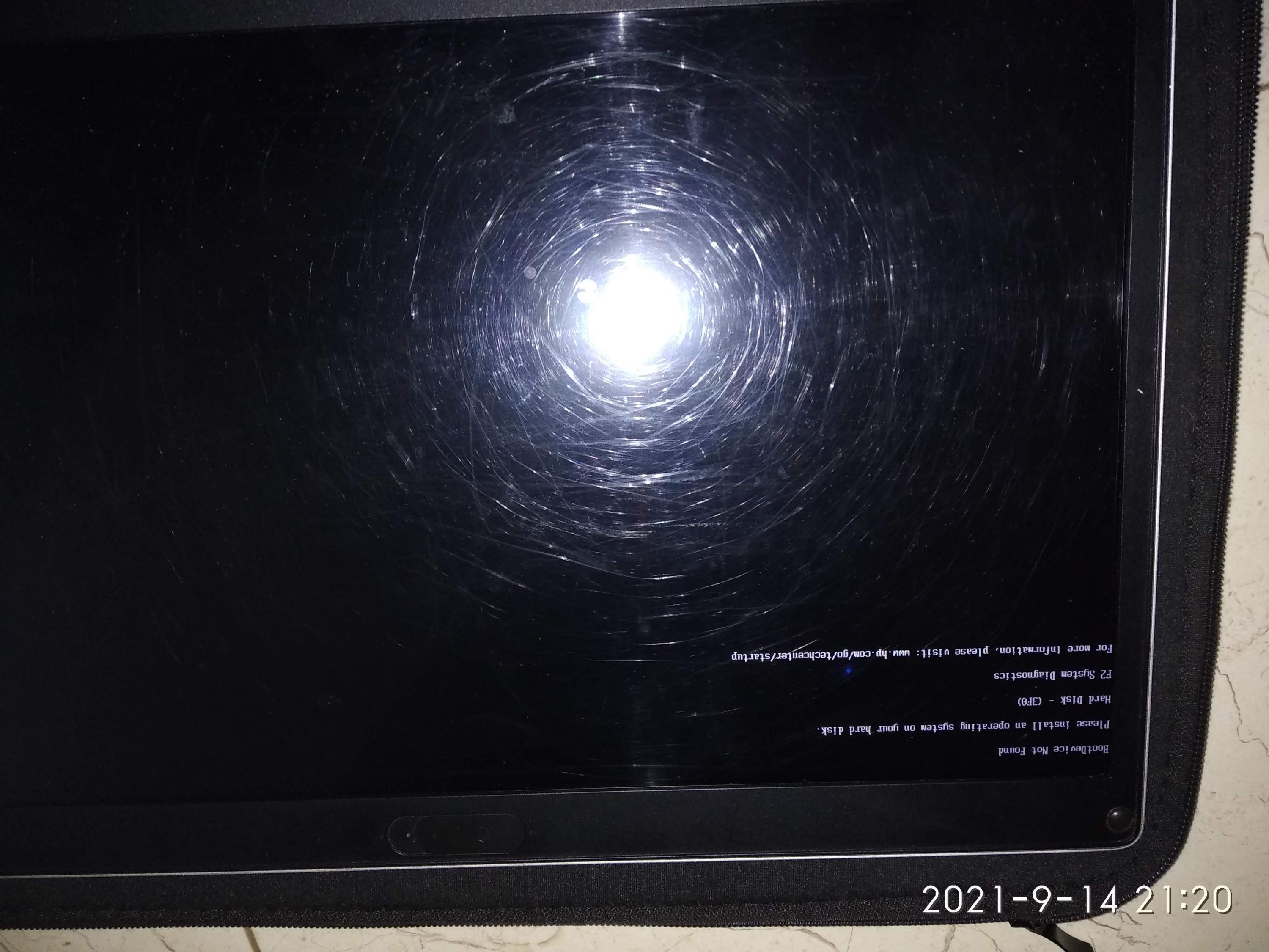

    Re: hp 450 g7
    Originally posted by mdasifbd
    Tried with that file ("450-G7-BackupBiosLocked-2021-09-12-03 NEW.zip").
    But the following errors showing.
    These errors are normal after unlocking, don't panic , log into bios, and reset security settings to default.

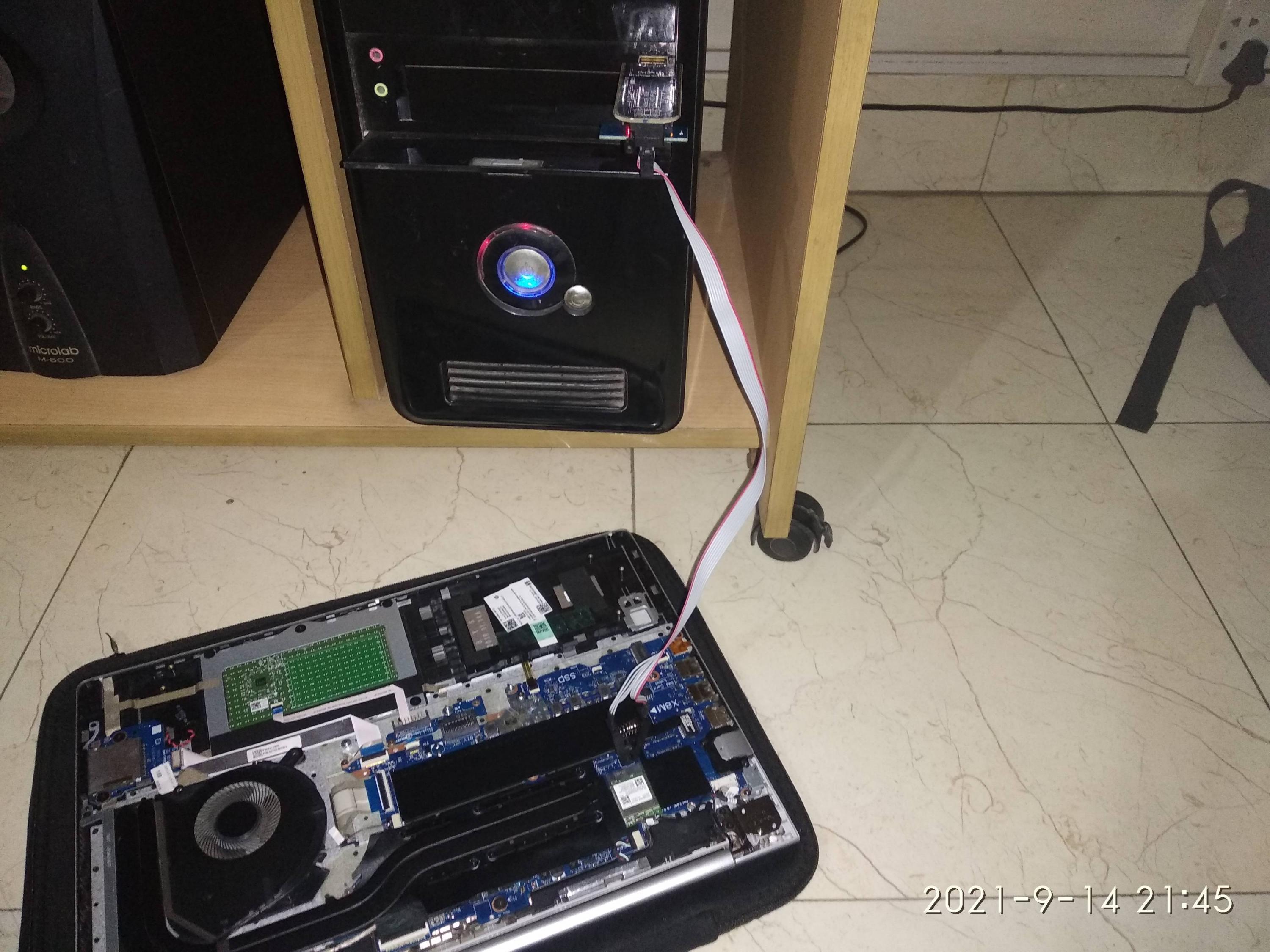

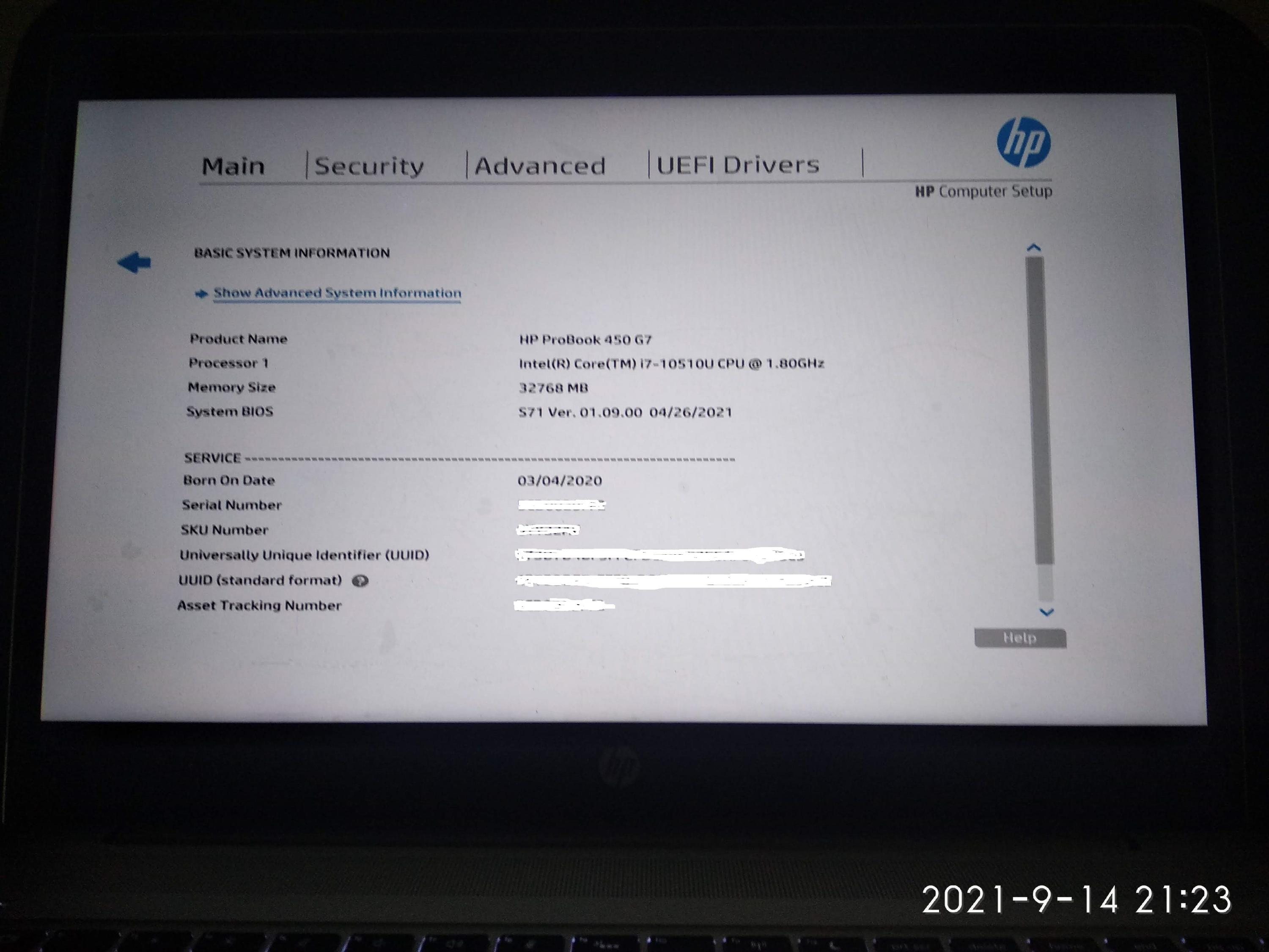

            Re: hp 450 g7
            Originally posted by Vesko356
            Both two files 450-G7-Locked-2021-09-11-01 NEW, and 450-G7-BackupBiosLocked-2021-09-12-03 NEW must be written to the corresponding chips simultaneously and then unlocking procedure will be OK. You're trying to flash only one chip at a time and then to test, but it won't work that way.
            You have done excellent job. Again many many thanks for your effort. Now there is no more "Power-On Authentication". Every function running perfectly.
            Both Main and Backup BIOS had been re-written as your instruction. I did one more thing, made a BIOS backup on pen-drive from HP's site. Also plug-in at the same time for extra caution.
            So HP Probook 450 G7 need to rewrite both BIOS to remove "Power-On Authentication".
            Appreciating your effort.
            Thank you Brother.

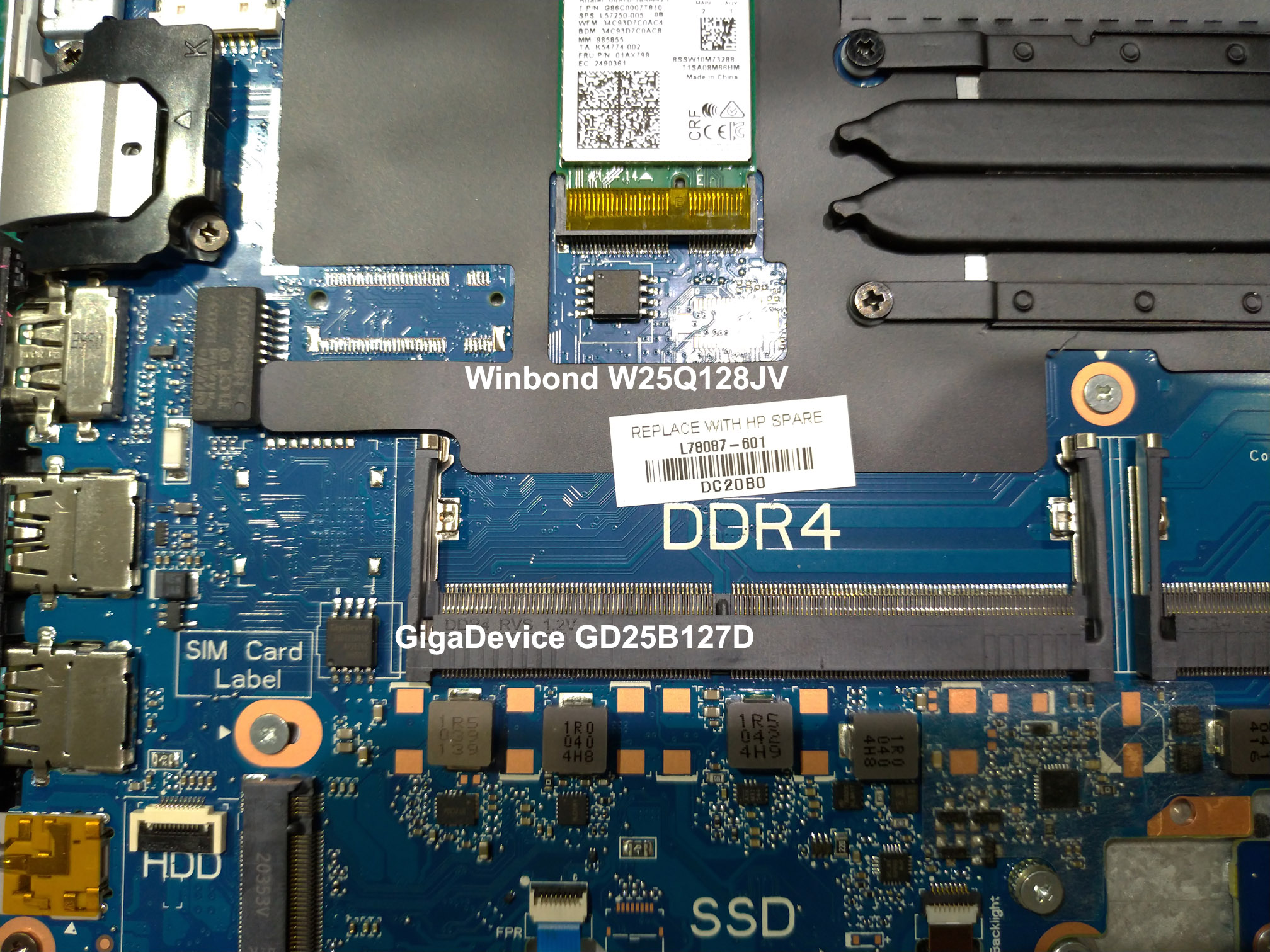

                                        #59
                                        Re: hp 450 g7 password
                                        Originally posted by peste
                                        remove the bios chip from the motherboard before reading or writing it, don't use the clip because it gives errors..
                                        try..
                                        Hi Peste,
                                        Thanks, but no success. The prompt for pass remains the same. So clearing the part of starting with "NvramActiveRegn." (GD125B127D) was not helpful.
                                        So I flashed back original (locked) dumps. Laptop works untouched, as arrived - asking for password. This means, that reading/flashing (with reduced clk) IN PLACE must be 100% OK.
                                        Maybe Im missing something.
                                        Please see attached image and explain, if possible.
                                        There are two chips, both 128Mb (16MB)
                                        - GigaDevice GD25B127D (dump starts with a block of FF values)
                                        - Winbond W25Q128JV (dump starts with various values)
                                        Please:
                                        1) Which of them is the main one?
                                        2) Which of them should be altered by RCUnlocker?
                                        Many thanks for your time.
