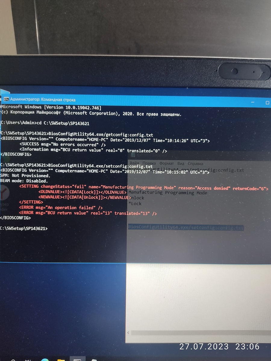

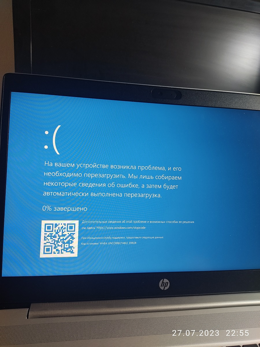

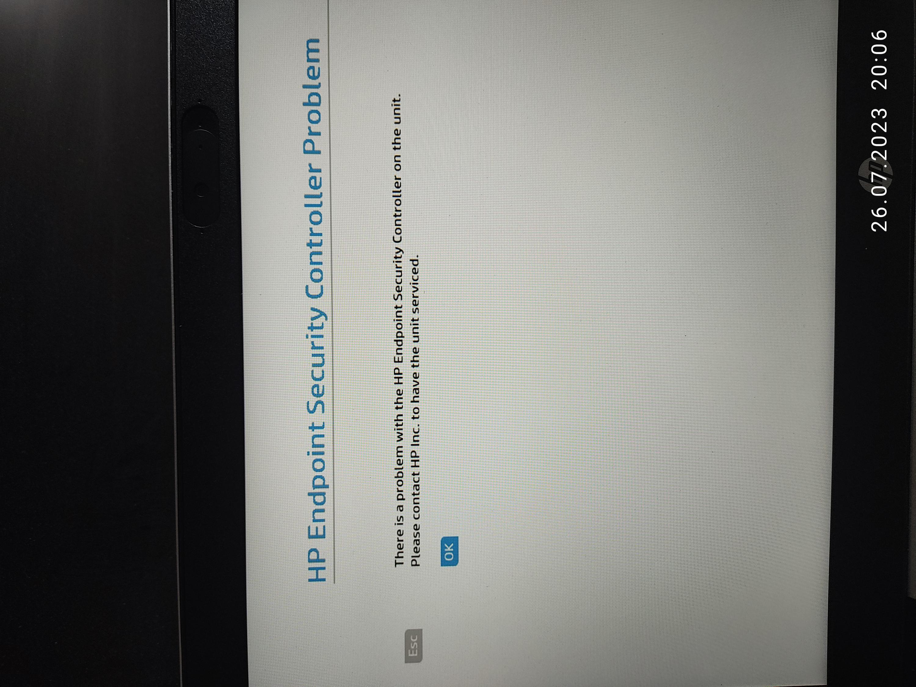

                            • kubat
                              • Jan 2023
                              • 21
                              • Киргизия
                              #114
                              Re: hp 450 g7 password
                              Hello! Help me please. I saved dump both bioses incorrectly and now I don't have the original bios (they have them but they are corrupted, I will add them to the message). Can you give me both any perfectly working bios with cleared MPMs? Or fix my original bios with password clearing?

                                • kubat
                                  • Jan 2023
                                  • 21
                                  • Киргизия
                                  #116
                                  Originally posted by elniñodelcautin
                                  here the bios file without absolute, delete all the information from the ssd or hdd before, deactivate the bios security options when entering the bios for the first time and save changes after you have a clean installation of the operating system and that's it you can update without problem
                                  Hello my dear friend! I flashed this bios, but when I turn it on, there is an error, and the MPM is locked. And the inclusion is long.
                                  • elniñodelcautin
                                    • Jul 2023
                                    • 18
                                    • bogota
                                    #117

                                      #118
                                      Greetings, colleague from the soldering iron
                                      you have to reprogram the two bios, the gigadevice unlocked that I published and the original winbon, it has to be like this to avoid errors since they are matched in information, please program the two chips before the first ignition, remember that the first ignition takes several minutes, (observation) if the power is completely removed, the equipment will take minutes to turn on again
                                      comment if it worked for you
                                      • kubat
                                        • Jan 2023
                                        • 21
                                        • Киргизия
                                        #119
                                        Hello! I flashed both bios. There are no errors when turn on. MPM is lock, BCU utility cannot unlock it. Absolute program has not yet tried, but the blue screen sometimes appears. How i can unlock MPM? I need change: serial, SKU, CT, UUID, MAC.
                                        • elniñodelcautin
                                          • Jul 2023
                                          • 18
                                          • bogota
                                          #120
                                          Your bios does not have an absolute activation, your bios does not have a password if they are the original bios I do not understand why you want to change the bios information, regarding the blue screen do a clean installation of windows if it persists do a bios update or a recovery mode to repair the bios in case you have a problem if the problem persists clean the me region of the WINDBOND bios
