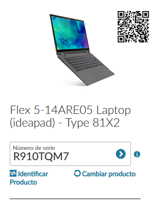

            • Tarco Sport
              • Mar 2025
              • 9
              • Ecuador
              Hello Friends, can someone help with this amd bios, it didn't turn on anymore after a flash from windows
              SN R910TQM7​

                • Tarco Sport
                  • Mar 2025
                  • 9
                  • Ecuador
                  Originally posted by hoaca388
                  Ckeck again serial number , not true.
                  is ok, check please

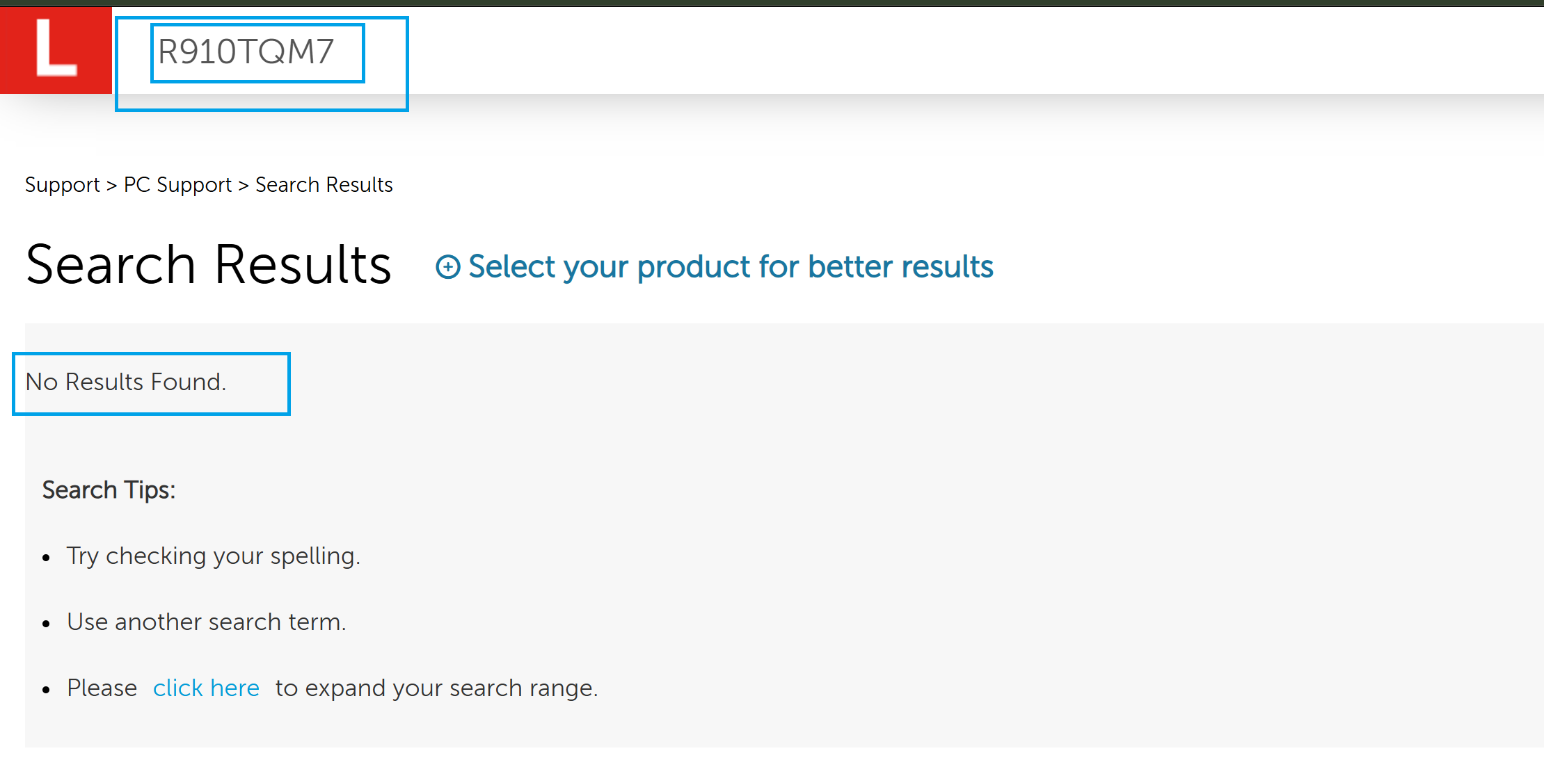

                  • hoaca388
                    Badcaps
                    • Jan 2022
                    • 12533
                    #29
                    Originally posted by Tarco Sport
                    is ok, check please
                    What the hell . Remind you, read chip again, backup fault.
                    Click image for larger version  Name:	2025-04-04 09_31_37-Search - Lenovo Support - Lenovo Support SG.png Views:	0 Size:	96.6 KB ID:	3607458
                    • Tarco Sport
                      • Mar 2025
                      • 9
                      • Ecuador
                      #30
                      Ohhh now I understand what the error is, in your case you are searching in the model section not with the model but with the serial number, you should search with the model which is 14ARE05 type 81x2 and SN (Serial Number) R910TQM7​
