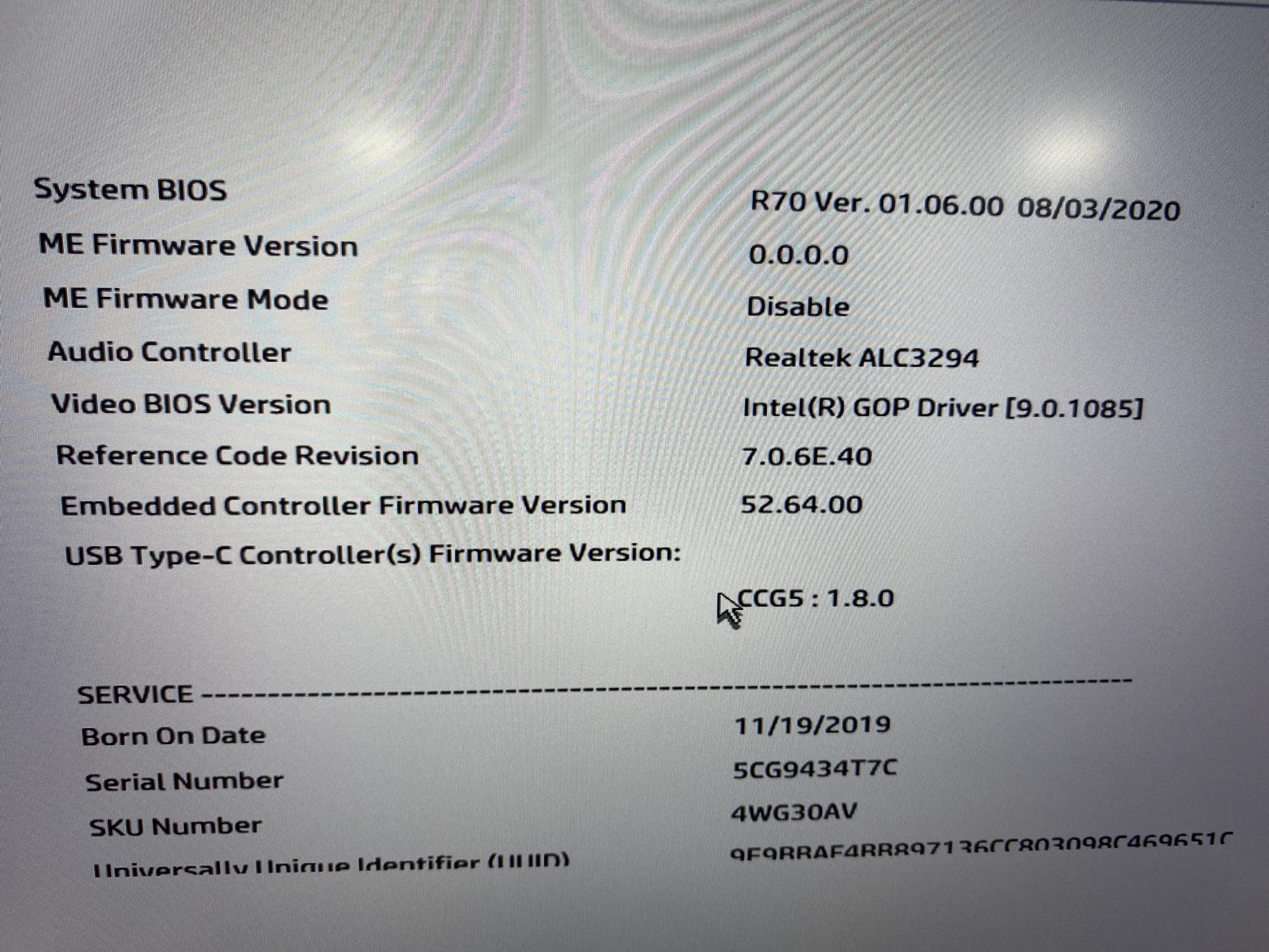

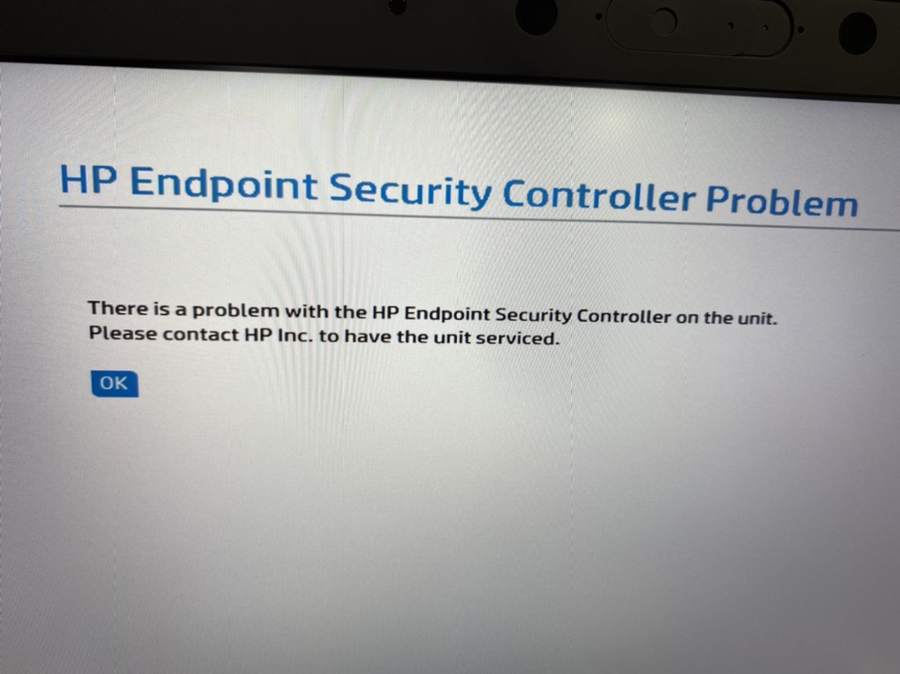

    I got this unit slow start fan always spining loud then got error there is a problem hp endpoint. I try update bios got error on update me version. Any info on this?
    • 22293
    Re: Hp Elitebook 840 g6 error on update me version
    The ME firmware version is showing 0.0.0.0 .Post your bios backups and someone will try to fix the bios with new ME firmware .

              now fan spin keyboard ligth than power of
              • qayyum786
                • Aug 2018
                • 1959
                • INDIA
                send both bios main 32mb? and 16mb
                and if possible send your original backup not that you have clean me already
