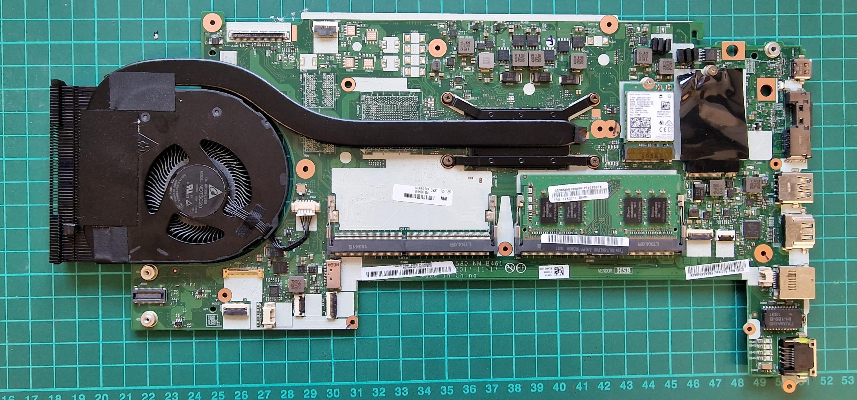

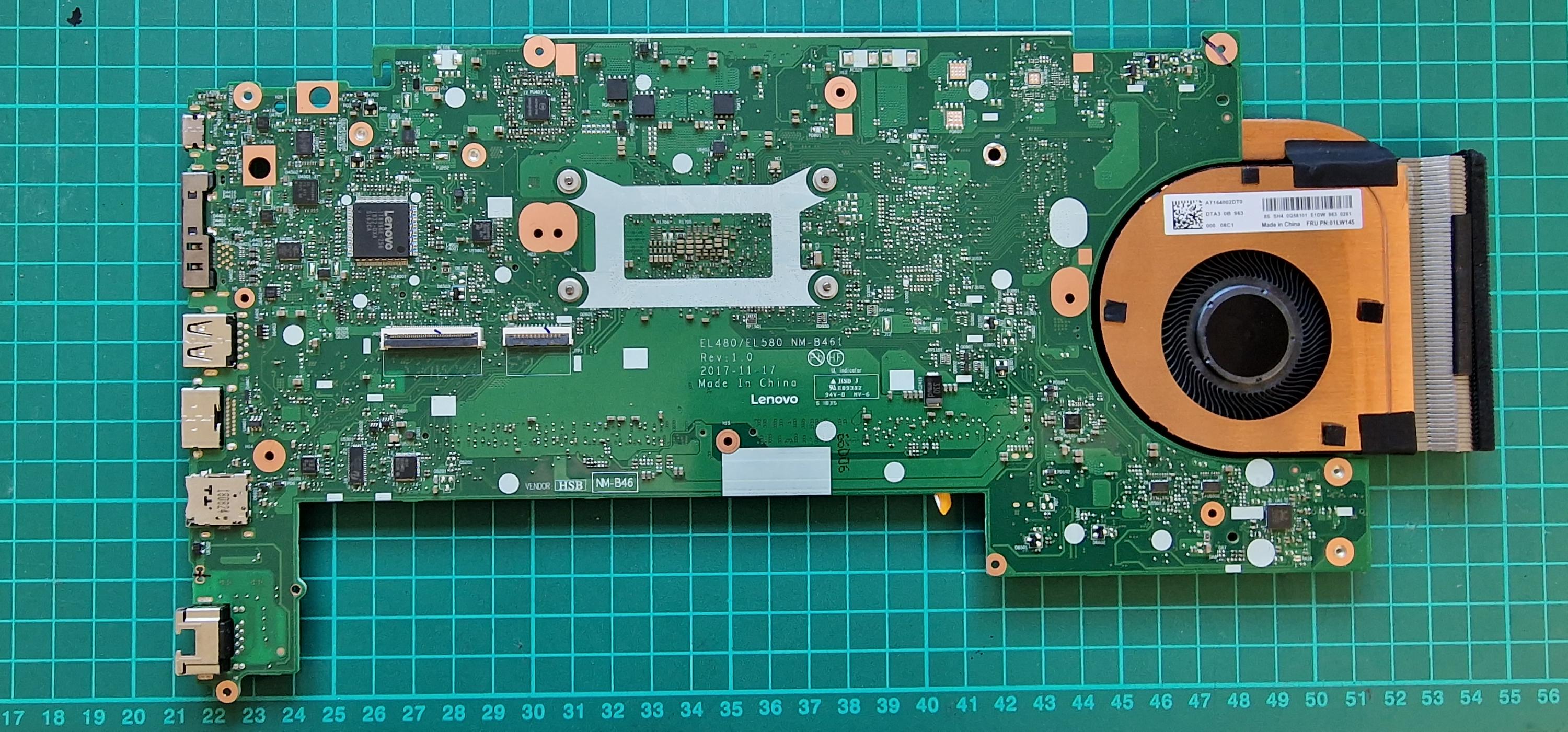

                                    • TJJones94
                                      • Sep 2021
                                      • 7
                                      • Darwen
                                      #1378
                                      Re: LENOVO BIOS AUTO-PATCHER for Supervisor Password Removal
                                      Hi, Im having problems unlocking bios with the provided method, I have several of these unit to unlock. I have included both dump files and and the auto patcher tool that I have downloaded from this thread. The Laptop is a Lenovo ThinkPad L480 with an Intel I5 8250U CPU, The Winbond Chip is W25Q128JVSQ. If someone can get this unlocked and then show me how so I can do the rest of the Laptops it would be grateful.
                                        • 22151
                                        #1379
                                        Is the motherboard model number NM-B461 ,if so it has an ITE IO chip ,not an SMSC MEC .Try flashing the ITE chip.
                                        • TJJones94
                                          • Sep 2021
                                          • 7
                                          • Darwen
                                          #1380
                                          I can confirm that is the Motherboard model, Would the ITE IO chip be on the back side of the board (opposite side to the ram).
                                          Please see attached photos below.
