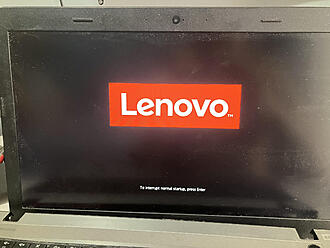

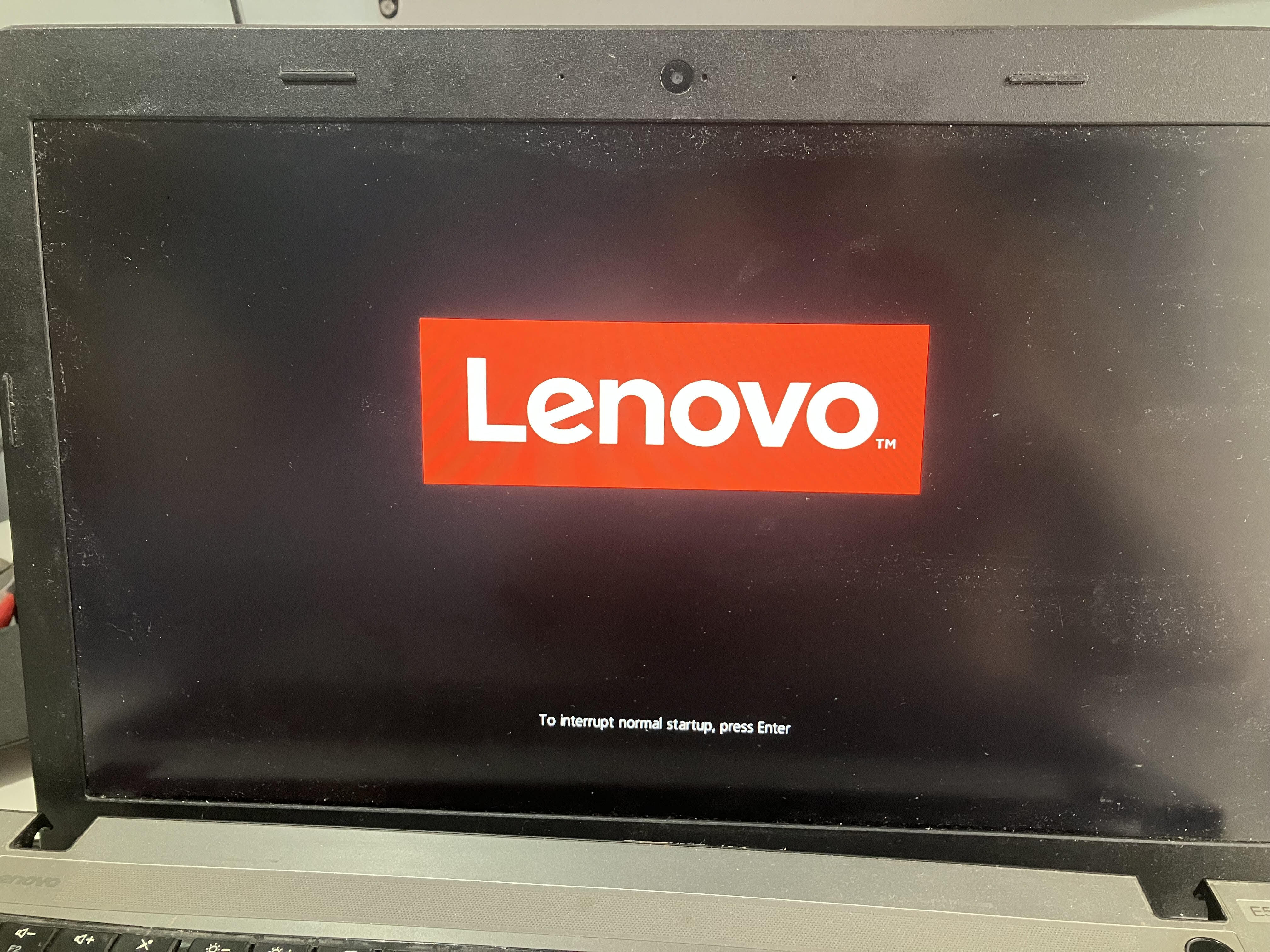

                I am trying to unlock my sypervisor pasword on my lenovo e570
                At firts i did something wrong and i bricked the laptop, but now i have a working bios that works normally but it still has password. I generated the patch using the method on post#1 but when i boot it gets stuck in the boot screen and any input on the keyboerd does nothing. Reflashong the working bios on the laptop makes it work again but it still has the password. The bios dumb i used is a mix of lenovo's latest uptate bios files, and the clean me region posted on the e570 thread. I post bellow both bios'es(patched+working).​
                Board: ce570 nm-a831 ren3.0
                Model num: TYPE 20H5-S00H00 S/N PF-0MLF40 17/02
                Bios chip: winbond 25Q64FVSIQ 1630
                (What is shown when booting with patched bios, waited for a long time,about an hour, and tryied every input with no result, stuck in this image)

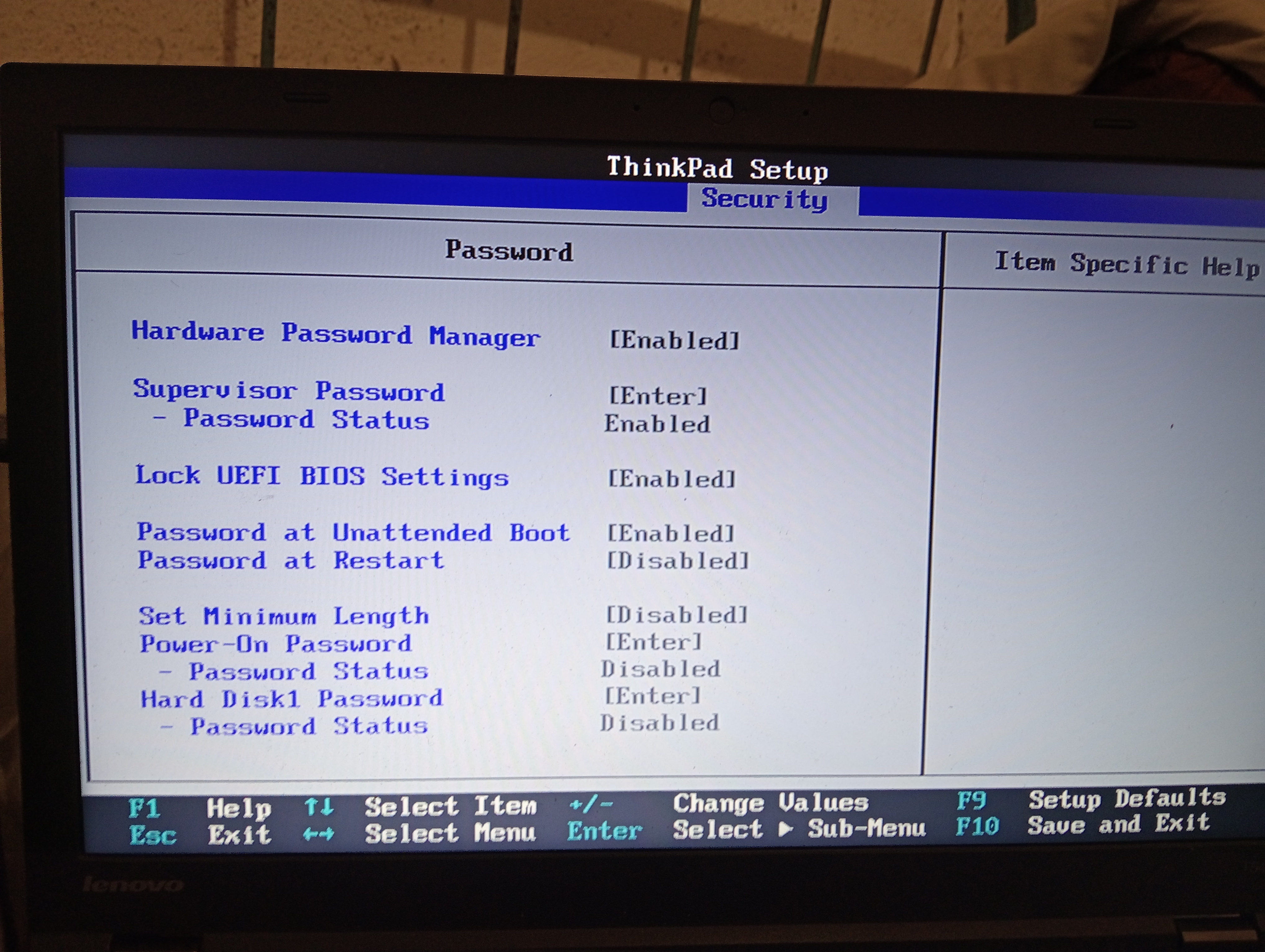

                          I need help to remove this password this bios on lenovo thinkpad t540p
                          thanks
                            • 21403
                            #3893
                            thanks
                            Type the laptop serial number, full name and model, motherboard model, etc.
                            post the contents of the bios chip even if it is corrupted..
                            read the forum rules..https://www.badcaps.net/forum/troubl...before-posting

                                    In the photo of bios is version and serial and model
                                    Lenovo t540p
                                    type: 20bf-s5dk00
                                    serial number: r9-0jx3yr
                                    system serial motherboard is: w1ks62j10er
                                    this bios locker by supervisor password
                                      • 21403
                                      #3898
                                      Lenovo t540p
                                      type: 20bf-s5dk00
                                      you might be able to use the EC bypass https://www.badcaps.net/forum/troubl...54#post3669354
