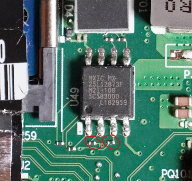

          so I have T480s for whitch I've dumped the bios with NeoProgrammer and used autopatcher to patch the bios (to remove password).
          Now the issue is that when turning on with patched or original bios power button flashes once and cooler spince for a second then stops, no other sign of life only cooler spining for a second every couple of seconds (no sounds, no lights - nothing else).
          Type: 20L8-A01RUK
          S/N: PC-10AERO 18/12
          I'm attaching original (dumped) bios and the patched one. Please help - advise.
          Thank you.​

                            Unfortunately I did damaged the motherboard. 2 components are broken (capacitors if I'm not wrong), and they are very small, so without micro soldering, the board is good for a rubbish bin only...
                            I have attached a picture (not mine), circled in red are the 2 components which are now missing...
                            Thank you everyone for the assistance, unfortunately I'll stop here as I have no chance to solder such a small components.

                                • 22089
                                #3335
                                Probably 33 Ohm resistors. Buy some they`re very cheap or get them from a scrap board. Temperature adjustable soldering irons are cheap too, you can get a kit with the iron,tips and solder for about 10-15 euros.
