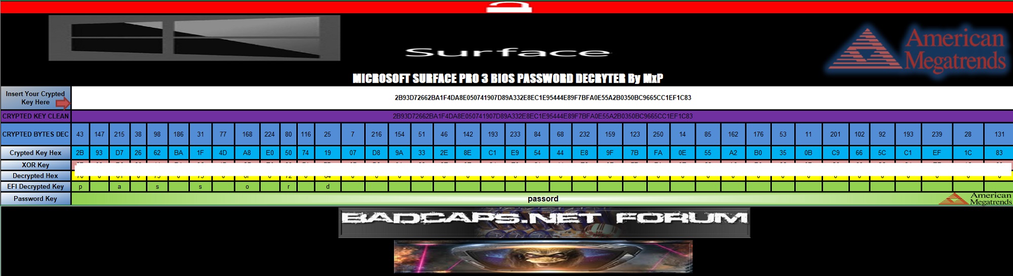

    Re: Surface 3 Clean Bios? (noob)
    hallow max still i dont understand , can u share your tool?
    • cdma-india
      • May 2010
      • 35
      #42
      Cb56bab4b9de4734ff88a19781a44531
      5e3d236883295cd7196fdb733939dbad
      37e229393fb7027b3f5cb2b875d719fc
      217591c1b91d2599a0acfb74a3deb492
      11b9c1358b
      some one will decode this?

        #43
        post your dump here ,the key finish by 1c 83 (01)

                #47
                Have you got a XOR key ? Cant calculate without key. But why you need to calculate , just fill all of this string in dump with 00 (zeroes).
                Try HERE (you`ll need a XOR Key), but in almost all cases password is HASHED.
                    Originally posted by keczuk
                    Please give a link for this site:
                    https://toolslick.com/math/bitwise/xor-calculator
                    EDIT: The ASCII result is reversed .

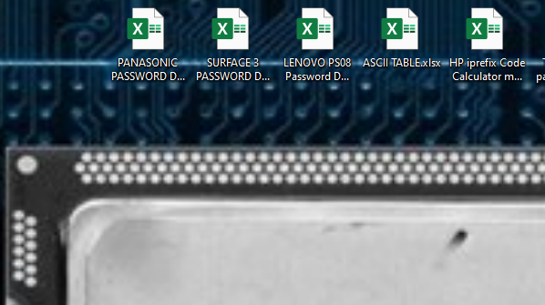

                          #52
                          u FEEL better ? or ?? it's not funny.
                          There is nothing funny
                          just use her brain and the info on the page.
                          Everything is indicated here.
                          You have all the links to find and understand the principle of operation.
                          Too easy to share my files that I took hours to create.
                          They are provided in another tool which is not yet available.
                          If you want to understand, search a little.
                          Otherwise just ask for your password
                                  Hello all. I recently acquired a small army of surfaces and they're functional, but they have a bios password. I've been trying to figure out how to do it myself since there's so many of them, but I'm stuck at the actual decrypting part. I followed the guide from the Panasonic bios recovery on github, but I'm unsure of where the author got the second hex string from. Thanks for any and all help and I have attached a bios file from one of the devices.
                                  Code:
                                  00000000000000000000000000000000
                                        00000000000000001A93F22641BA2C4D
                                        8BE071743E07D89A332E8EC1E95444E8
                                        9F7BFA0E55A2B0350BC9665CC1EF1C83
                                        01
                                    @joshuah459
                                    If you have a bunch of these, there's a probability that the supervisor password may be the same in all of them, for this one it is (pswrd is case-sensitive):
                                    password = ADP@LSC
                                    There's a GitHub post with the information you are looking for, it's related with a Panasonic ToughBook laptop, you need the XOR key and all you have to do is XOR the "password-block" (you extracted from AMITSEVAR) versus the "xor-key", you will get the result which will be in Hexadecimal numbers (0-9, A-F), then just do the HEX conversion to ASCII to get the password.
                                        @przemek_79
                                        Discard the 00h NULL bytes and this translates to:
                                        password = rj45b105
                                        ...just XOR the contents of AMITSESetup variable block contents versus the XOR-key.
