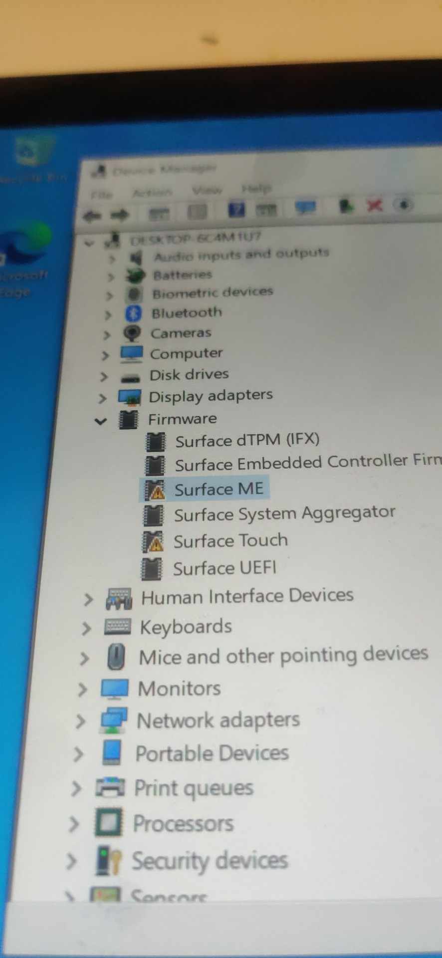

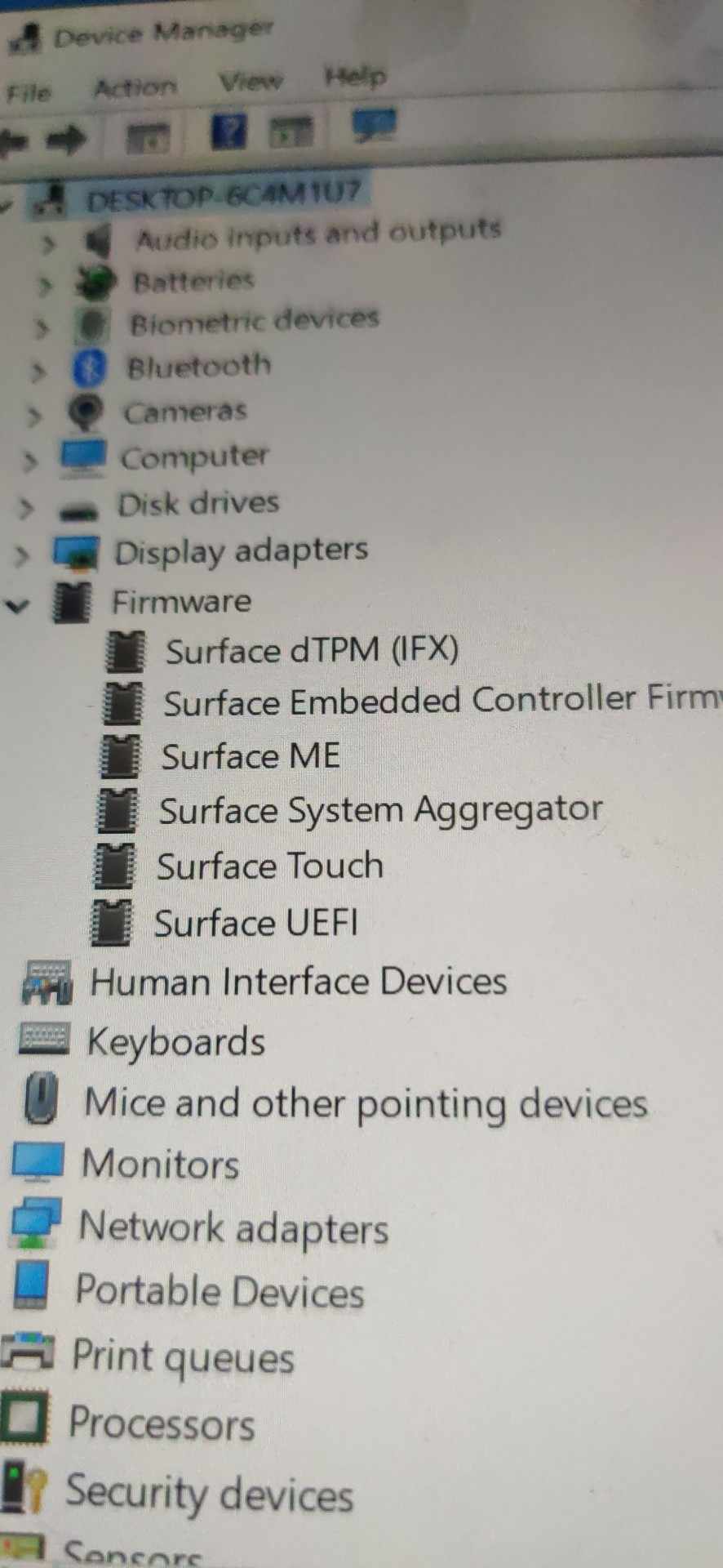

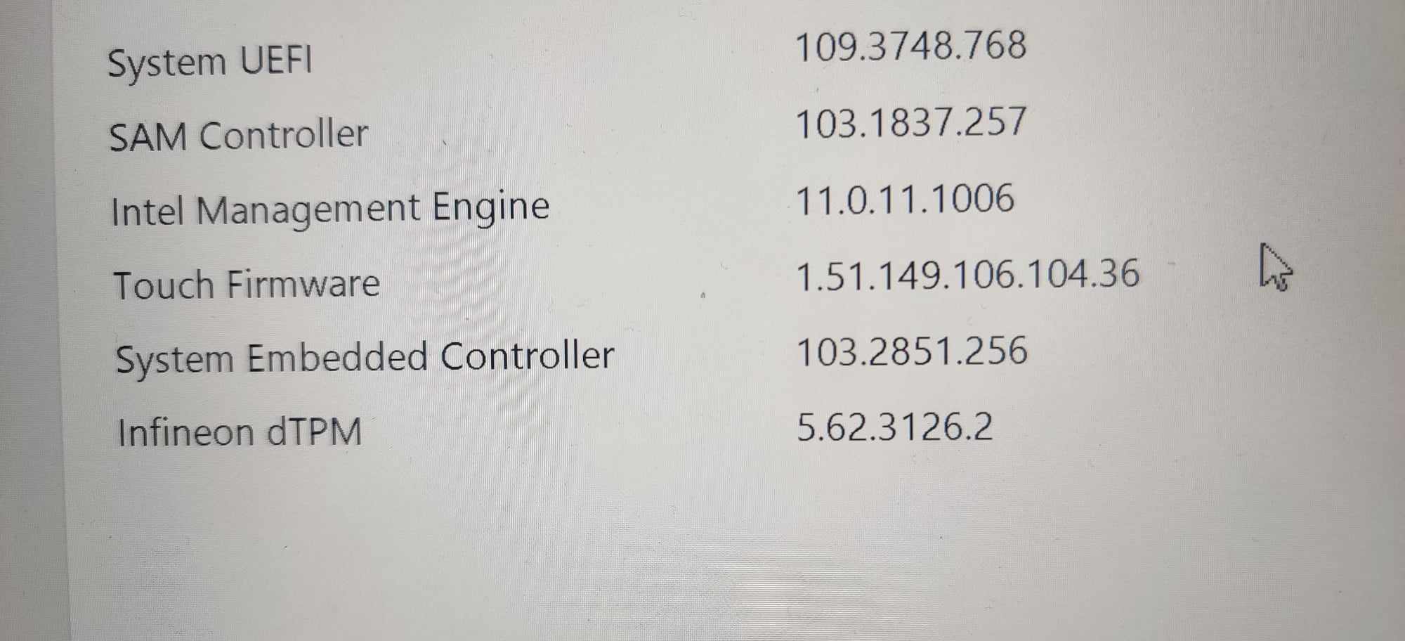

    Hey. Sometime ago i bought broken surface pro 4 supposedly it was dead. But turns out it was just a faulty charger. Although when it powered on and after all updates, touchscreen didn't work it also doesn't work in UEFI. On my original bios in device menager it shows yellow triangles on Surface ME and Surface Touch, hid-compliant touchscreen was missing. I already replaced touchscreen and touchscreen board, i've broken the orginal screen when trying to open surface. I already tried diffrent bios files from internet. With the latest one i was able to install the drivers for Surface ME and Surface Touch triangles disapered but hid-compliant touchscreen is still missing and the touchscreen still doesn't work in windows and in UEFI. I'm uploading my orginal bios file i think its corrupted i cant get it open in FIT, i'm also uploading the almost working bios file and some images. If anyone is able to help me, i would be much gratefull.

      Your BIOS is missing the ishc part, which is responsible for the operation of the touchscreen. I’m also trying to solve this problem (you haven’t succeeded yet?
