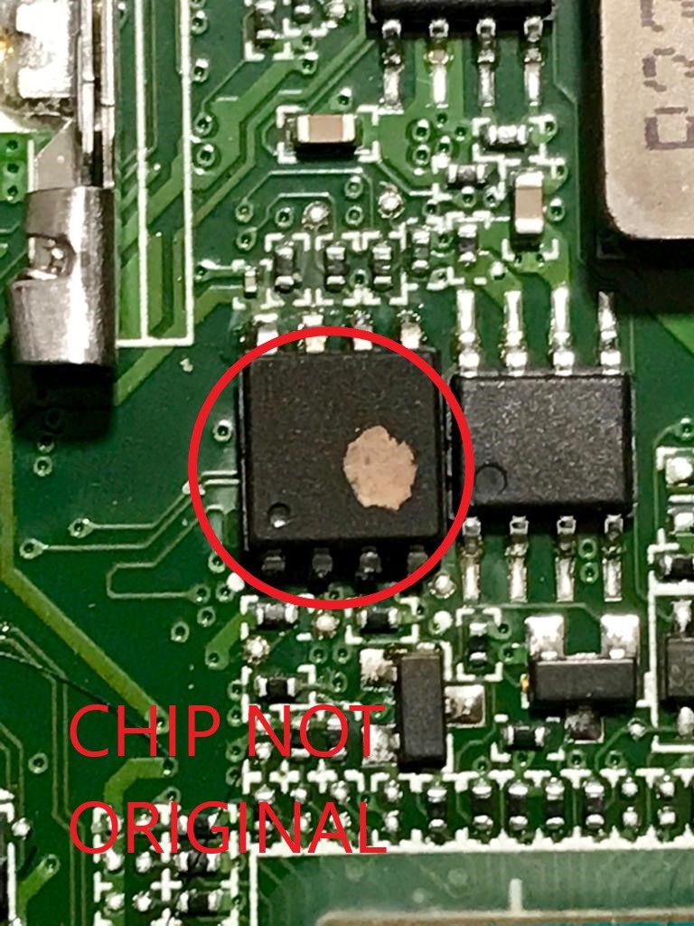

    PLEASE NEED BIOS AN EC ASUS GL503V MAIN dabklmb1aa0
    Hello friends someone help me, I need bios and ec asus GL503V the owner says that I took it to Asus because I turned off the equipment in the middle of an automatic update of the bios since or knew what it was, when checking it I see that there is a chip that it is not the original one they put a bigger one where the ec goes, the query is can you use another chip different from the one that originally came? the equipment does not give an image they only turn on the keyboard lights nothing overheats attached images ...

            No funciona Claudio me parece que el problema esta en el chip ec ya que lo reemplazaron y colocaron otro chip winbond de otro tipo y voltage me parece que es ese el problema arriba puse imagenes... lamentablemente no tengo ningun chip de ese tipo (25q40ewnig) crees que sea ese el problema?
            Please write in english or otherwise you will be warned for that. This is an english forum. Use google translate if you need.

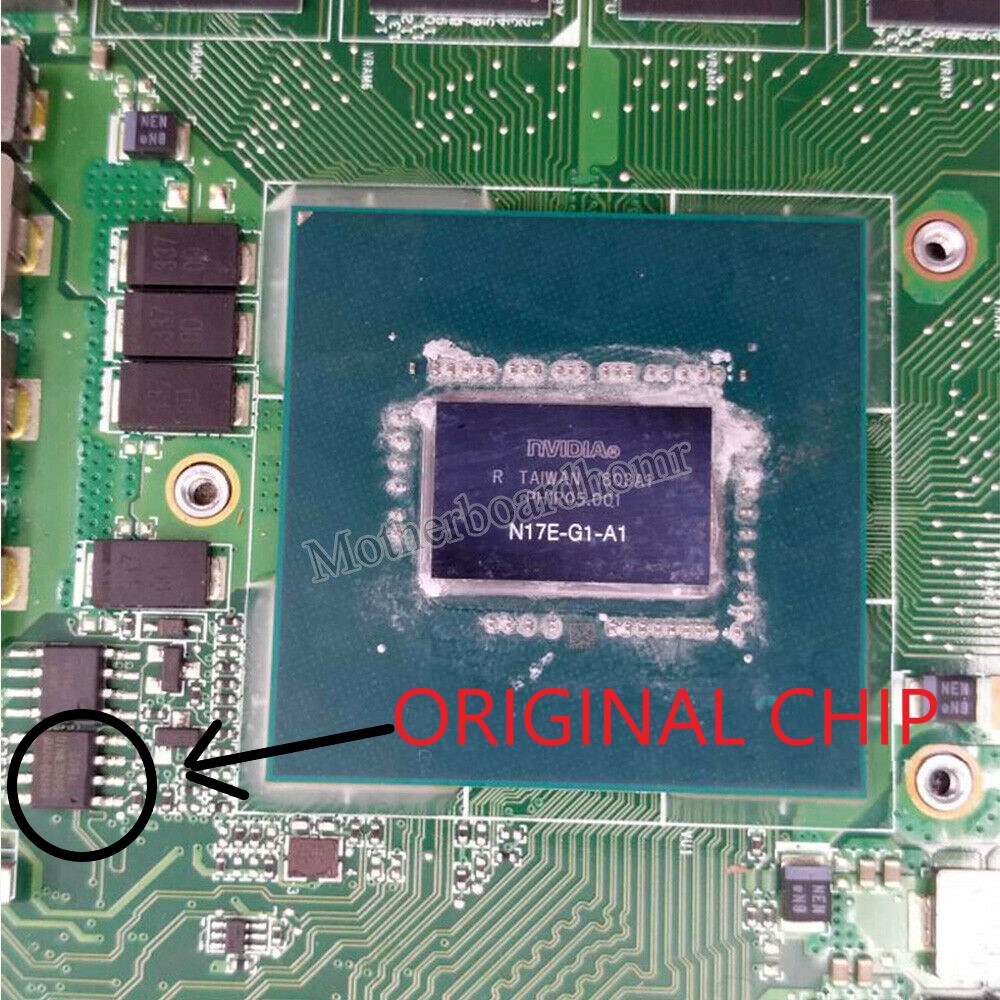

            The ec chip replaced are the same specs? It´s a new (blank) chip or used from other laptop?
            This chip "25q40ewnig" maybe it´s a VGA bios (your laptop have a gtx1060).
            EC chip is the ITE SIO
            I attached the EC file for your laptop.
              Ok, I understand I thought I could write you in Spanish, No it does not have the same specifications so I put the images so the team arrived, instead of arriving with the 25q40ewnig chip someone removed it and put a larger chip as I showed in the images. .. and I don't have a 25q40ewnig chip, I thought that the ec was that chip (25q40ewnig) but you tell me that it is the vga chip that gives meaning to the failure, but I don't have an identical chip to write this chip .. .

                This chip that you talking, they don't be the same as original. It can be larger or other manufacturer, but need to have same specs as original.
                Post backup from this chip if you can.

                  Ok, Claudio thank you very much I appreciate your help, finally I ordered the chip on aliexpress here in my country I could not find it so I will wait for it to arrive, do you have the firmware of the graphics card that goes on this chip or do you know where to get it?

                      Ok, friend, I already solved this problem, your repaired file works perfectly, finally I bought the vga bios chip on aliexpress, and I found the firmware of the NVidia GeForce GTX 1060 6GB, in another forum, I programmed it and finally it went on and it was ok, I will leave the file here in this thread, this file was from an asus GL703GE, and it worked on my GL503V. note this file is from the graphics card (GTX 1060 6GB)

                                  Hello, mine was a special case, someone had removed the original chip from the bios of the graphics card... you must reprogram the bios with a functional file, first you must identify the exact model of your motherboard and look for the file.
