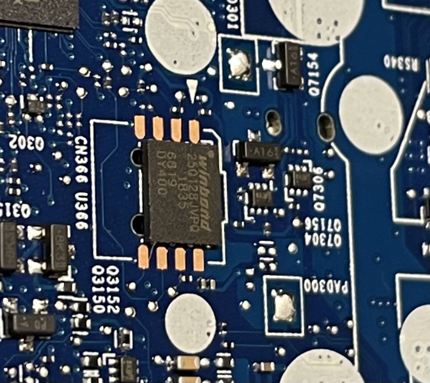

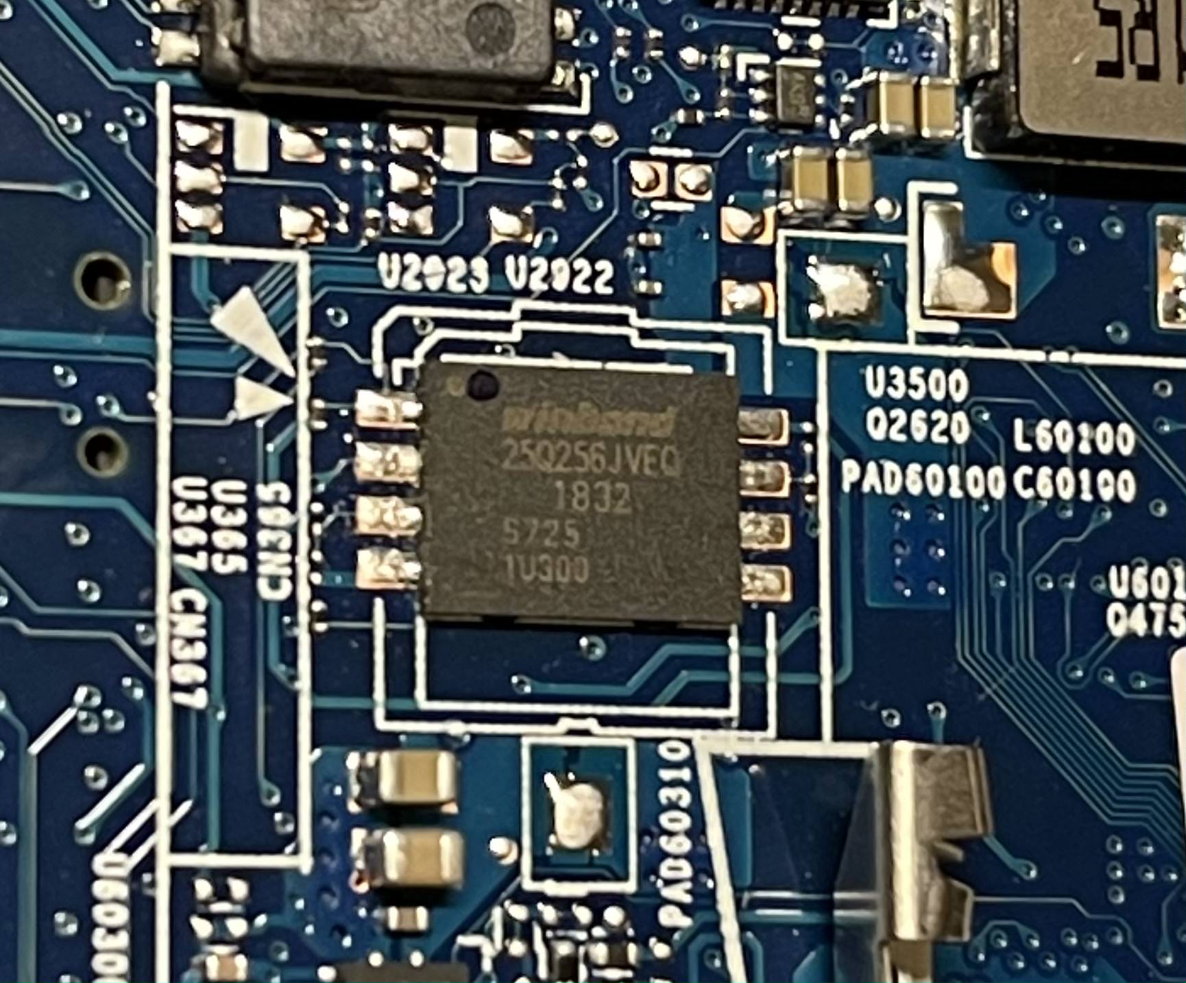

                                • HomingPigeon
                                  • Dec 2021
                                  #56
                                  Re: Hp ellİtebook 840 g5 bİos password
                                  Hey Techies-
                                  HP Elitebook 840 G5 - picture attached.
                                  Device background:
                                  I purchased this laptop from a third party, online. Unfortunately, there is an enterprise password lock on the bios and, possibly, region lock as well. The laptop appears to need to connect to a network on startup.
                                  There are two bios chips.
                                  • front of MB near the first RAM module - winBond - 25Q256JVEQ - 1832 - picture attached
                                  • back of MB alternate side of the front BIOS chip - winBond - 25Q128JVPQ - 1835 - picture attached
                                  I own a rework station and a CH341A bios chip programmer. I plan to remove chip/s and post contents here. Before I begin, I have a few questions:
                                  • Do I need to remove, backup and write over both bios chips?
                                  • Is there a tool provided that will work to remove access rights, both password and region. ie HPUnlocker or RCUnlocker?
                                  Long time lurker, first time poster. Thank you in advance for your help, this community is much appreciated.
                                  • peste
                                    • Dec 2016
                                    • 12811
                                    • ROMANIA
                                    #57
                                    Originally posted by HomingPigeon
                                    Hey Techies-
                                    Device background:
                                    the password is in the 32MB bios chip (25Q256JVEQ), and can be deleted with HPUnlocker, don't forget to make a copy of the bios chip before writing.
