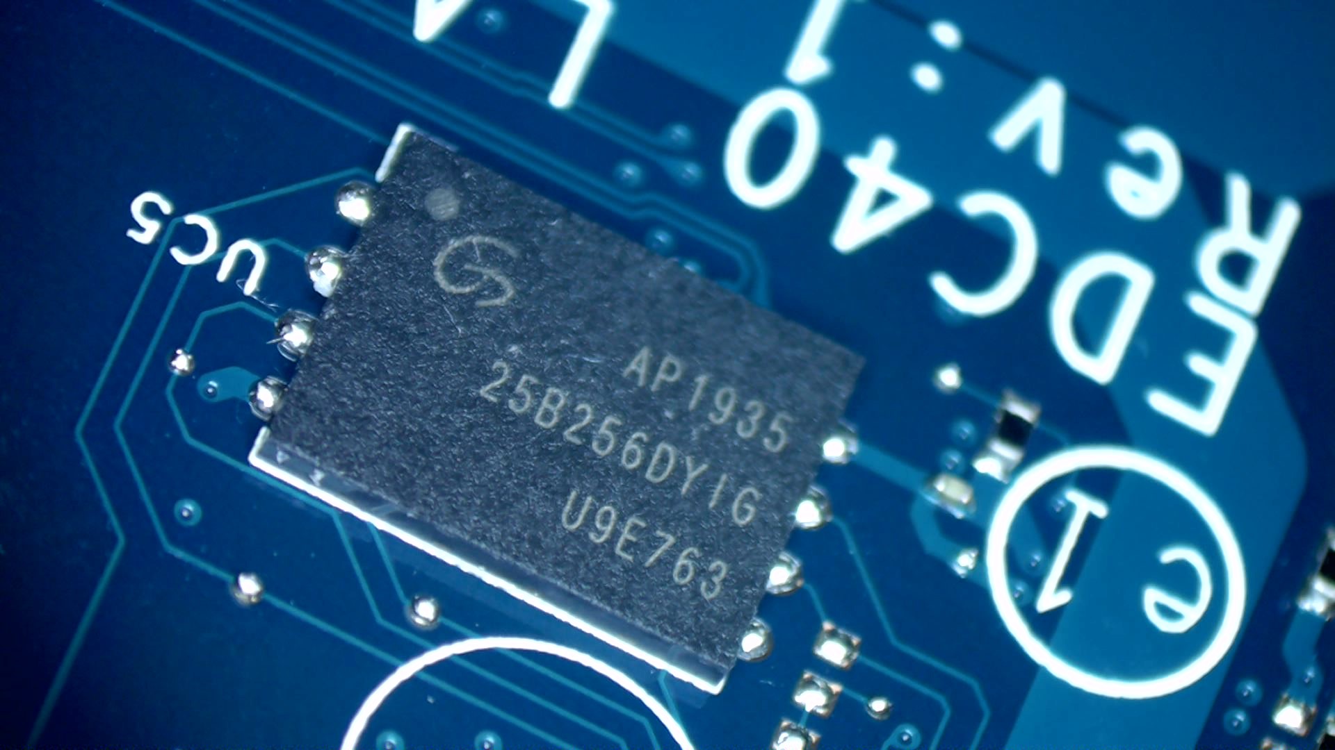

    There is a chip on the back market as UC5, could this be it

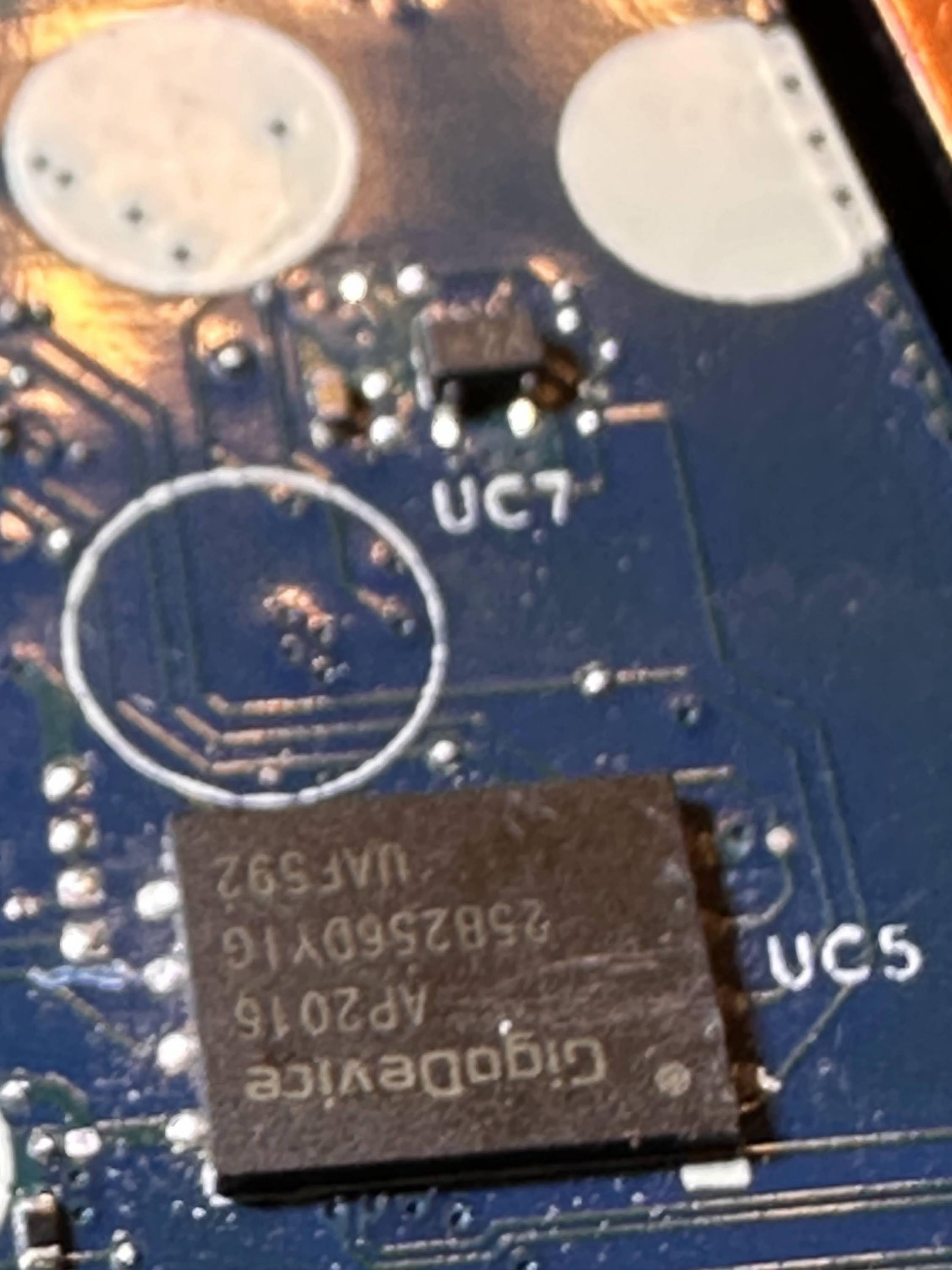

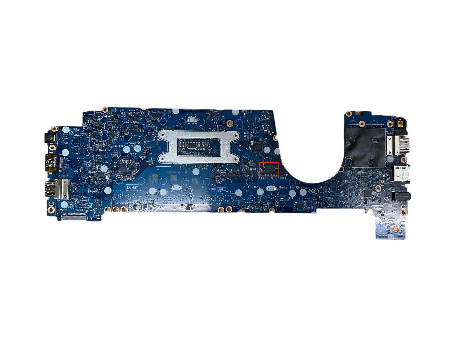

      Re: Dell Latitude 7400 Bios Password
      Originally posted by LeonCass78
      not present on my board.
      the other side
        yep, that's the one

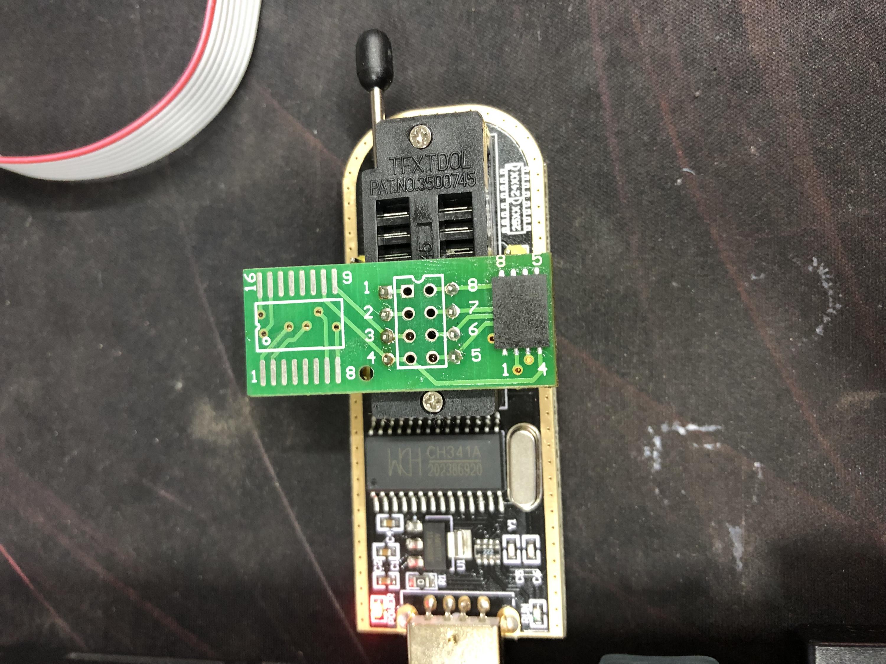

              I was afraid i did it wrong...
              I have a Gigadevice 25B256DYIG bios chip and tried multiple versions of AsProgrammer and NeoProgrammer, but none has been able to properly detect the IC. This chip is also not an option to add manually.
              What Ch341a programmer did everyone else use to pull the backup? nothing has worked so far. Thanks!
                That's right, this chip, then the remaining problem is that you have to read the chip successfully. I don't use the CH341a programmer so I can't help you

                    #469
                    Hello. Bump.
                    Still awaiting recommendations on a eeprom reader and software used to backup bios on Gigadevice 25B256DYIG chip. Anyone had any luck with a Ch341a?
                    Is it possible or easier to program a replacement eeprom chip from another manufacturer other than 25B256DYIG?
                    My Dell 7400 Board:
                    edc40 la-g871p
                    rev : 1.0 (a00)
                    • qayyum786
                      • Aug 2018
                      • 1959
                      • INDIA
                      #470
                      yes
                      use asprogrammer
                      let the programer select the chip by it self
                      it will pick if not exact but compatible one
                      you click on read and save it
                      make sure the chip is attached in a proper way other wise it will give you an error
                          Hello. Bump.
                          My Dell 7400 Board:
                          edc40 la-g871p
                          rev : 1.0 (a00)
                          Hello i am using the Ch341a for reading bios. I use neoprogammer.

                                    • LeonCass78
                                      • Oct 2022
                                      • 9
                                      • Hampshire
                                      #478
                                      yep, that's the one
                                      I removed the UC5 chip and was able to read it, see attached
