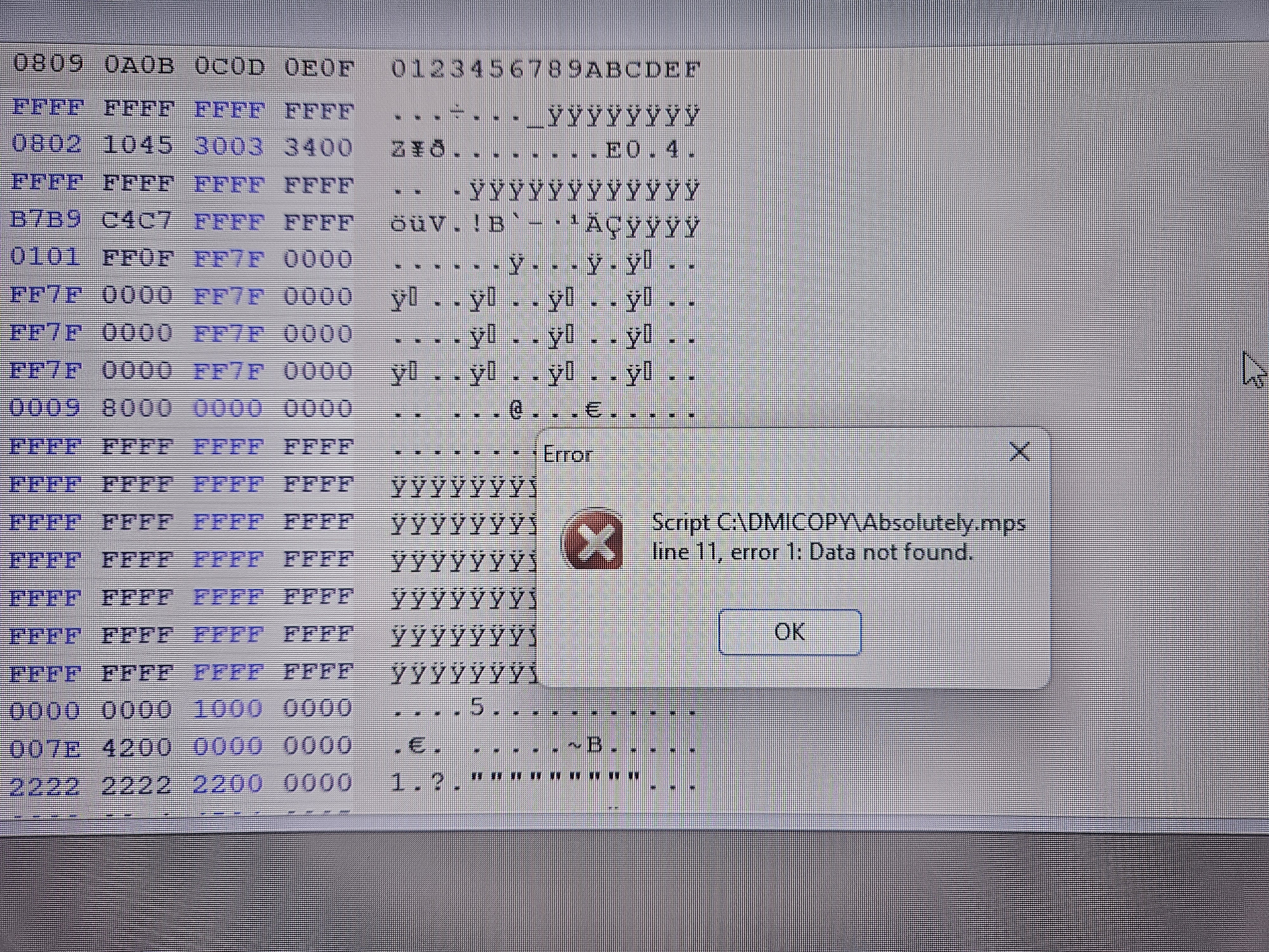

      When I run absolutely.mps I get this error in the pic below. Yes, bios file has been put in same folder and renamed locked.bin
        • 21968
        try this bios

            This worked perfectly.
            On initial boot it restarted several times which is normal, then it booted straight to bios setup and i permanently disabled Absolute Persistence.
            i then reloaded Windows and everything seems to be working perfectly, I'm actually responding to you from the same laptop.
