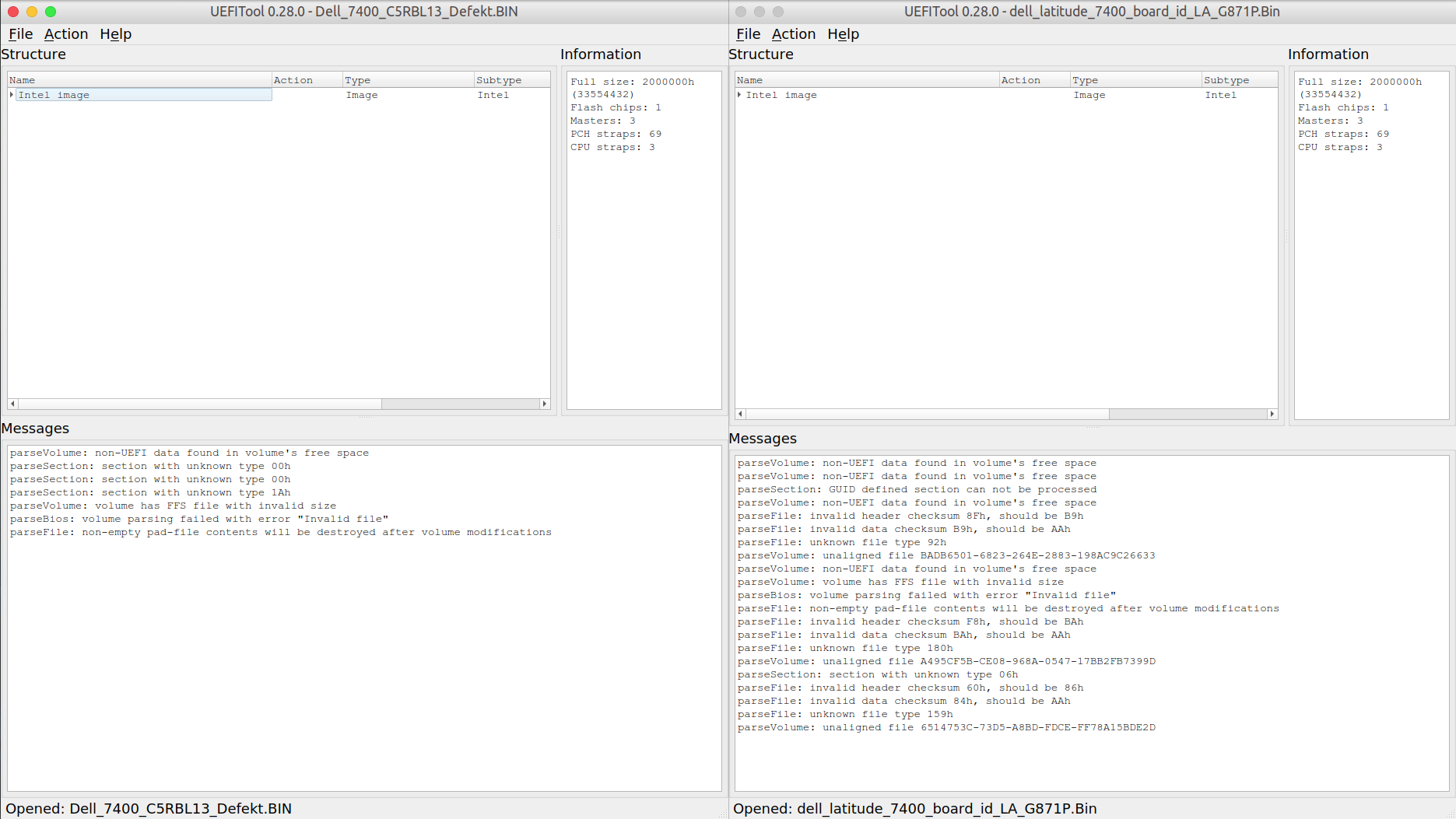

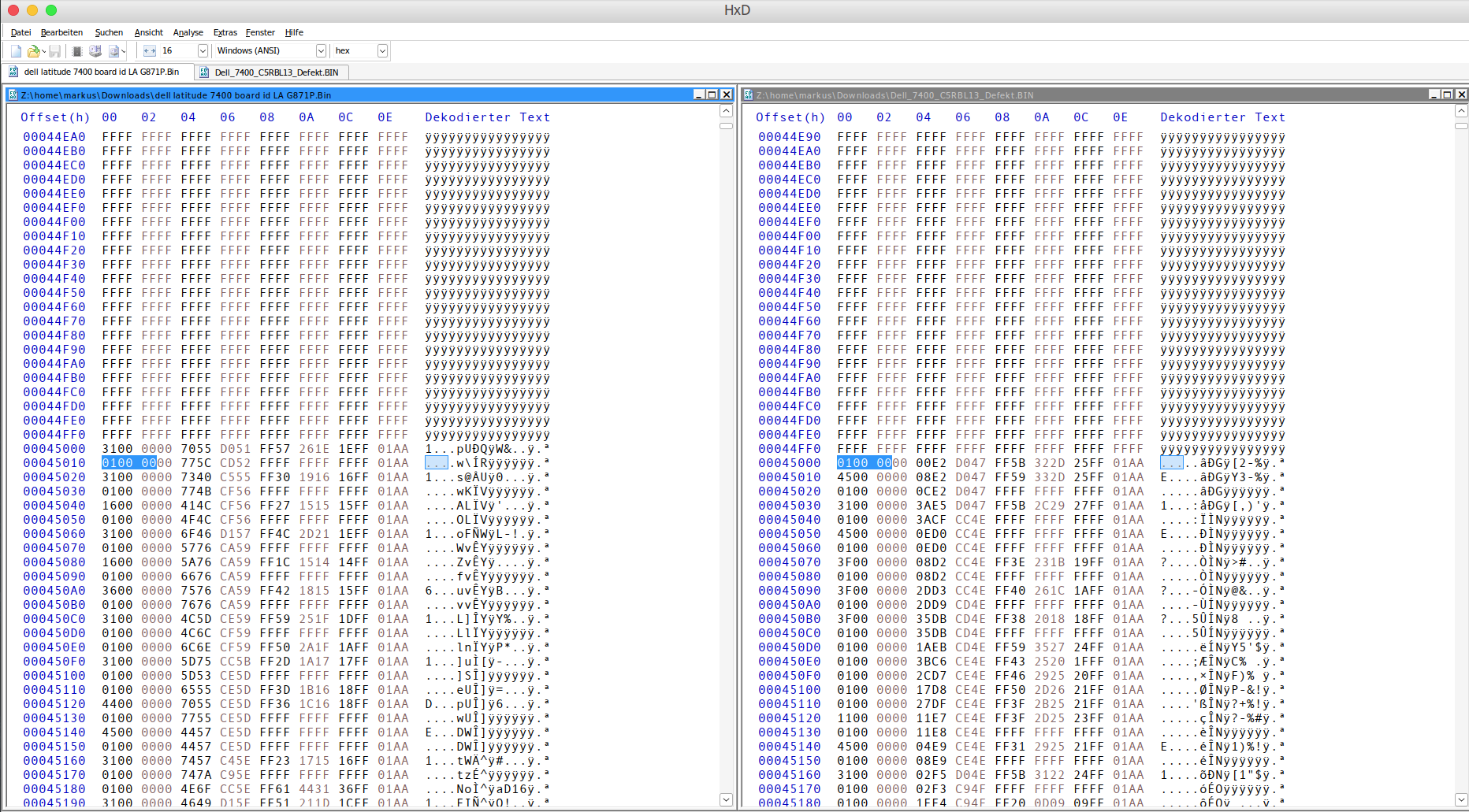

                              #555
                              Oops, I once compared your original uploaded file with a file from me without a PW and in my opinion it is defective.
                              There are too many inconsistencies listed.
                              The second picture should show yours with PW on the left and mine without PW on the right.
                              Now you need a new BIOS file, I can build a new one, but from experience it's unlikely that that will solve the problem.
                              Second choice is a ME region cleaned file, Dell is not that picky.​
