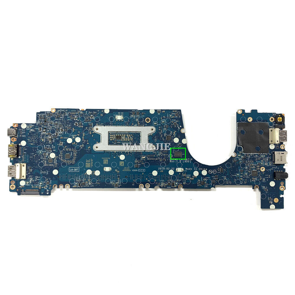

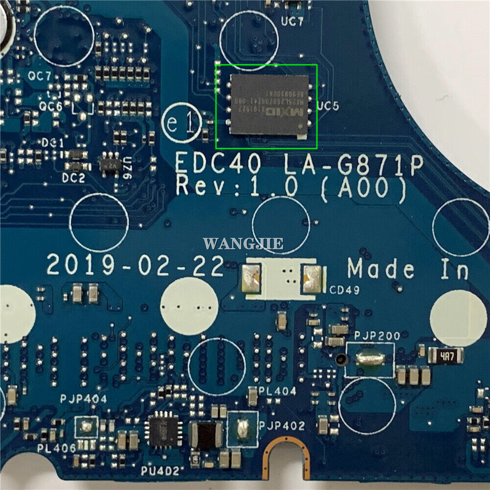

                        this is not the main bios find the 32MB chip .

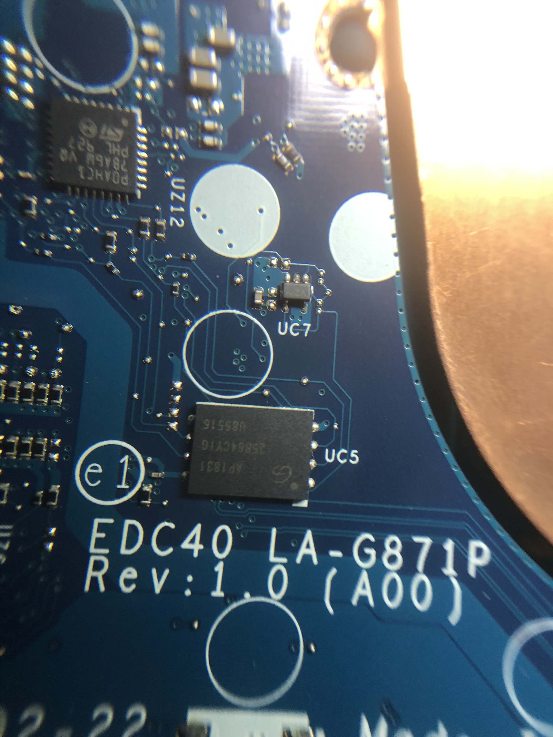

                          sorry i can not find the 32mb chip on the motherboard. My motherboard code is EDC40 LA-G871P rev 1.0
                          This is the 8mb chip - UC5, file above is 16mb - UC6
                            this is still not the main bios. refer to this picture. read post #510!!

                                TRY.
                                1st boot, press F2, write service tag, disable Absolute, save (Apply changes), restart. 2nd boot press Alt+F to exit manufacturing mode

                                  It works. Many thanks for your help πŸ˜€
