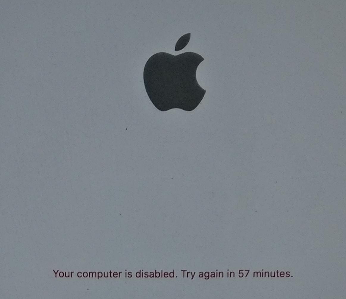

                    Hi,i also have an A1466,820-3437-B macbook air with efi lock and also very slow to boot,please unlock for me this file and create a clean me file plizz.
                    Thank you in advance.
                      It's here

                          HI,ive tested the file the machine is booting fast but, says its disabled i try again after after 60 mins.Still has efi lock please help
                            reset PRAM
