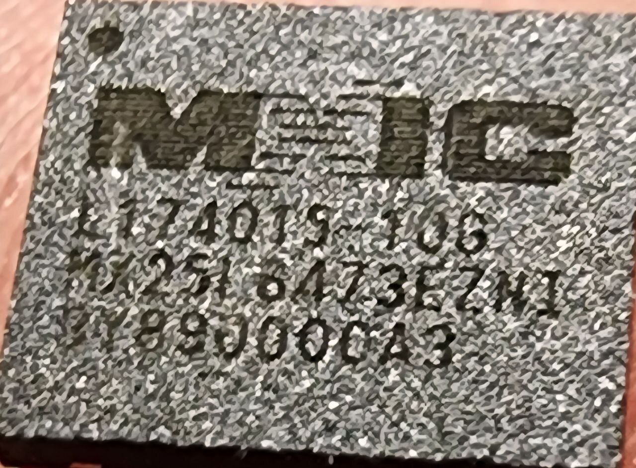

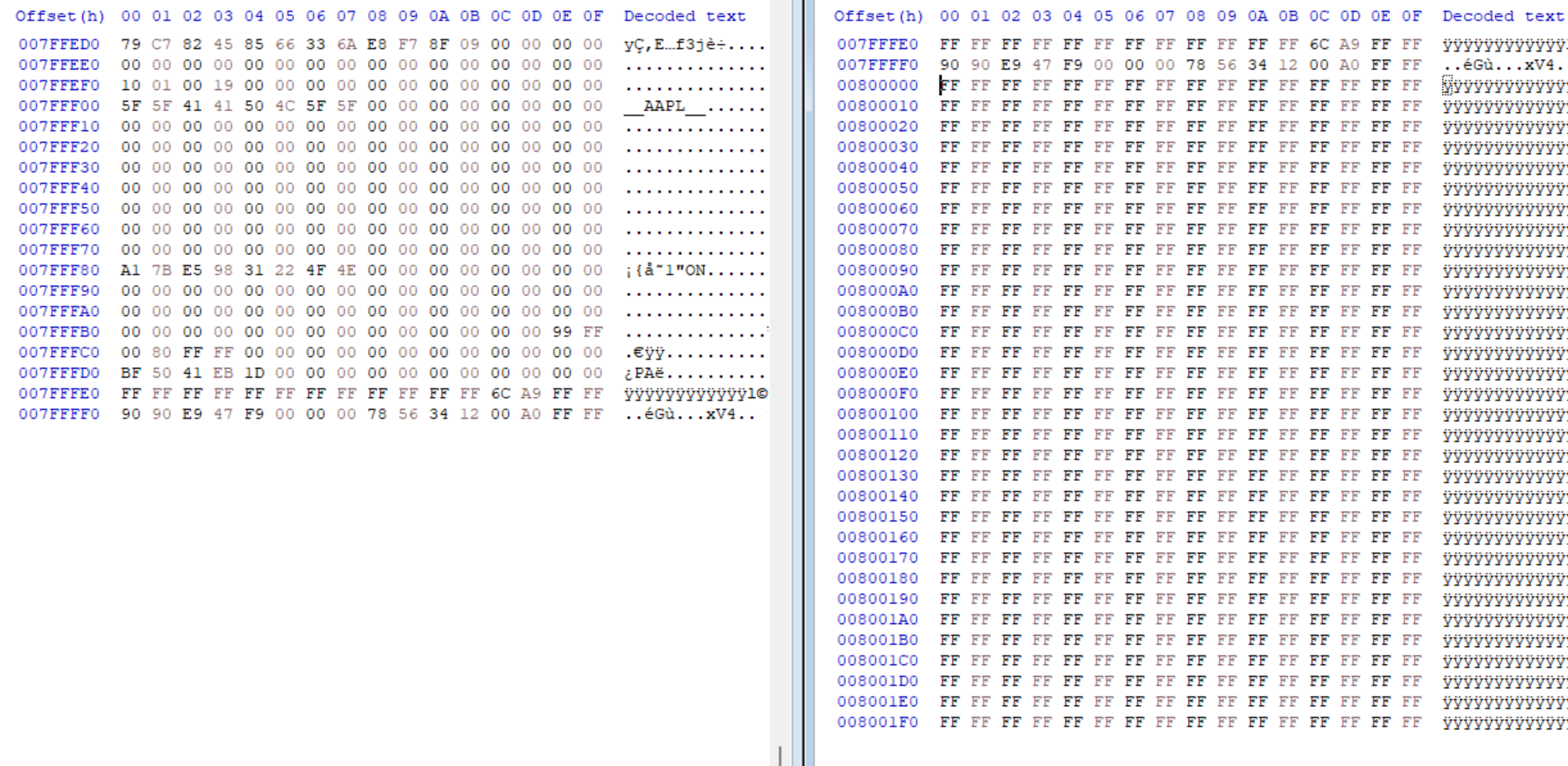

      Hello All,
      I made a mistake when recovering from a broken bios chip. I followed the instructions from page 1 and didn't realize it's a different EMC number. Mine is a 2925 and the one I put on was for a 2632. So I'm assuming that's why I'm getting a black screen. Is the EMC number something I need to change in the hex editor and reflash or is it completely different? I already followed the guide to put in my SN and fix the checksum.

        Originally posted by techguy97
        Hello All,
        post the contents of the bios chip even if it is corrupted..
        post S/N, full name and model, motherboard model,EMC,etc.

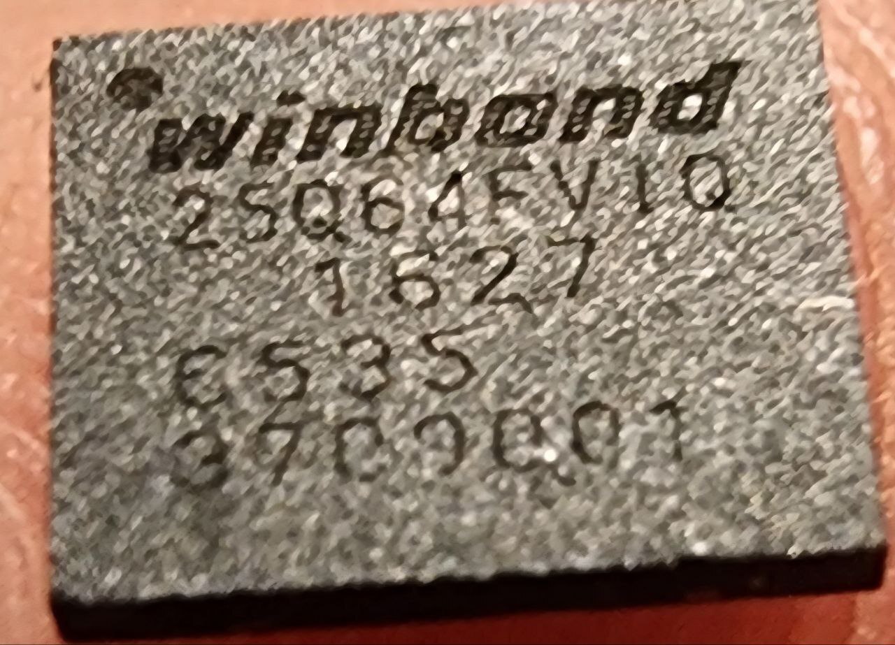

              #206
              Originally posted by peste
              the bios you posted is longer...be careful how you write this..
              Looks like the bios chip I have is larger? There is extra space compared to what you sent. Will the mac still read it right or do I need a different chip.
              Last edited by techguy97; 06-24-2025, 11:04 PM. Reason: The Winbond is the dead chip
              • peste
                • Dec 2016
                • 13599
                • ROMANIA
                #207
                no the chip is bigger, the contents of the chip are longer than normal....I think you copied it with errors...write the bios from the post above on the original chip...
