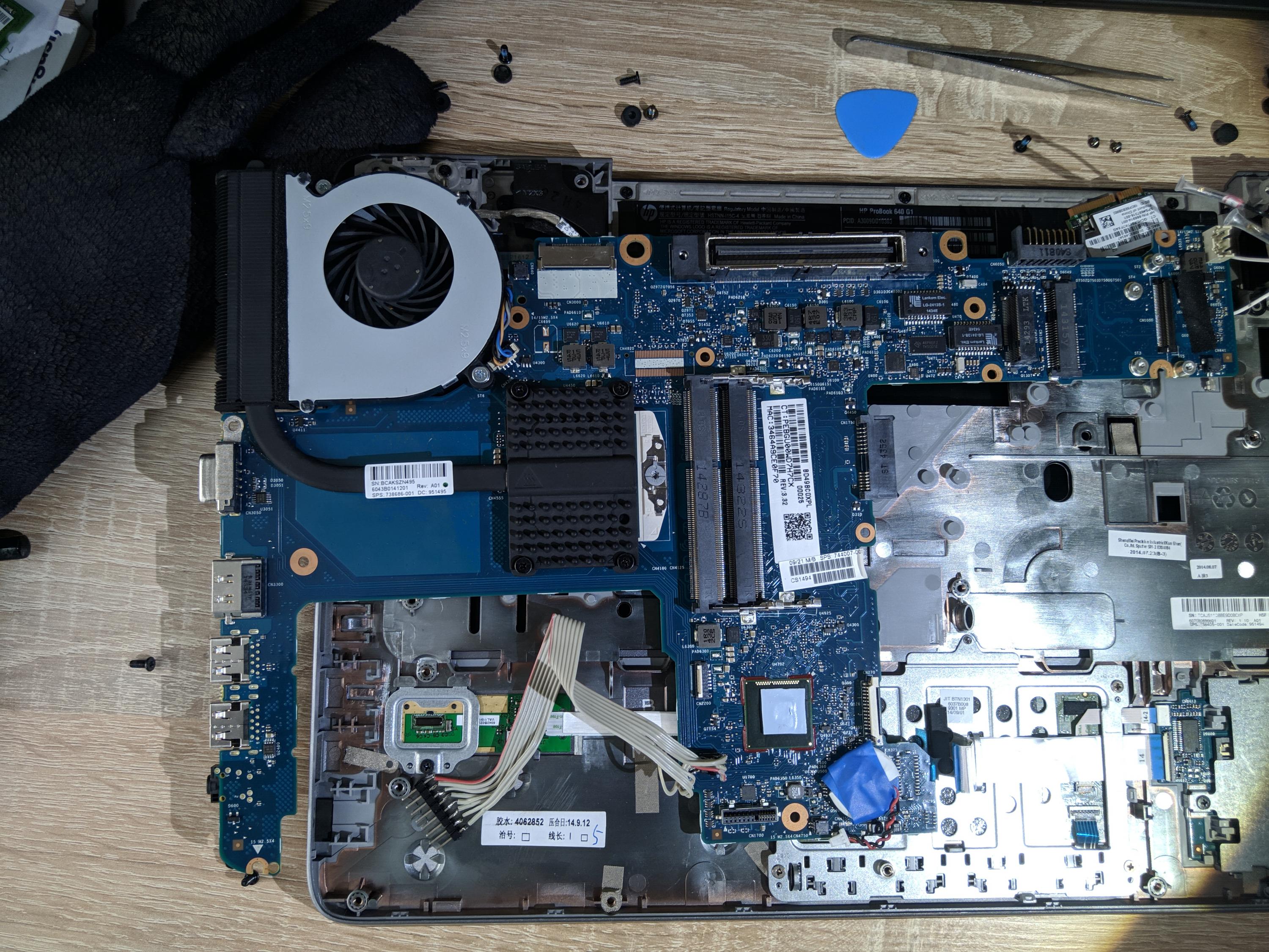

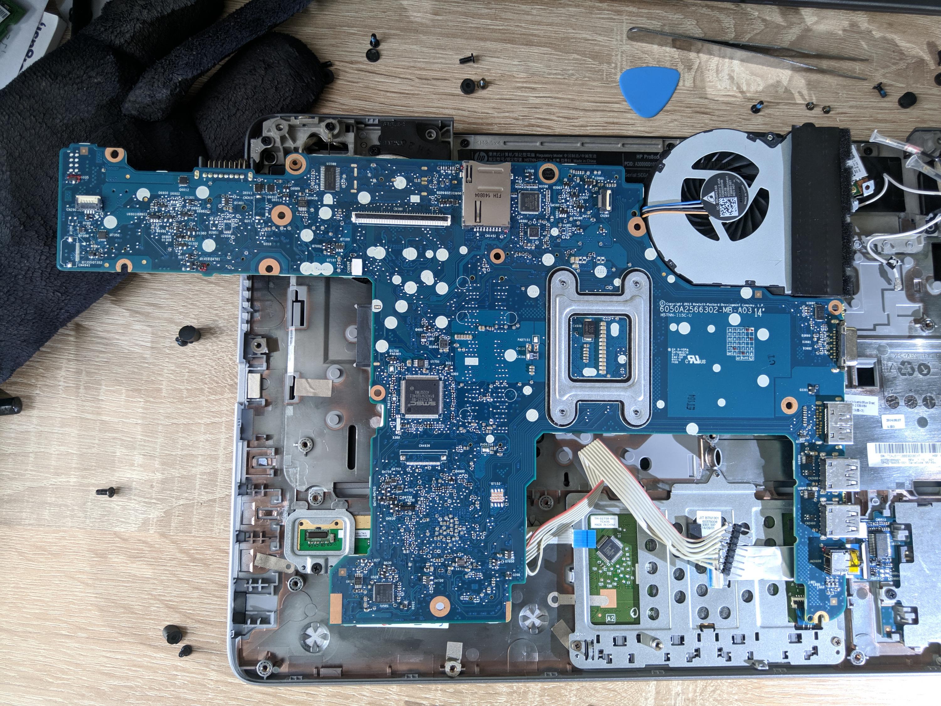

                                      • profiler
                                        • Jan 2022
                                        • 4
                                        #239
                                        Re: HELP BIOS HP 640 G1 corrupt
                                        Originally posted by FP1975
                                        Good evening,
                                        my problem is the following: the screen stays black, the pc launches, I have flashes on the caps key (5) and the fan is running at full speed. I'm thinking a corrupted bios. Here is the extracted bios.
                                        Thank you in advance for your help.
                                        I have exact the same problem. I tried to replace the ME Region.bin and reflash the modified outimage, but it does not change anything.
                                        Model: HP Probook 640 G1
                                        Mainboard: 6050A2566302-MB-A03
                                        Extracted BIOS and board images are attached.
                                        Thanks for help!
                                        • Vesko356
                                          VIP Moderator
                                          • Aug 2018
                                          • 4386
                                          • Bulgaria šŸ‡§šŸ‡¬
                                          #240
                                          Thanks for help!
                                          You must post the serial number.
