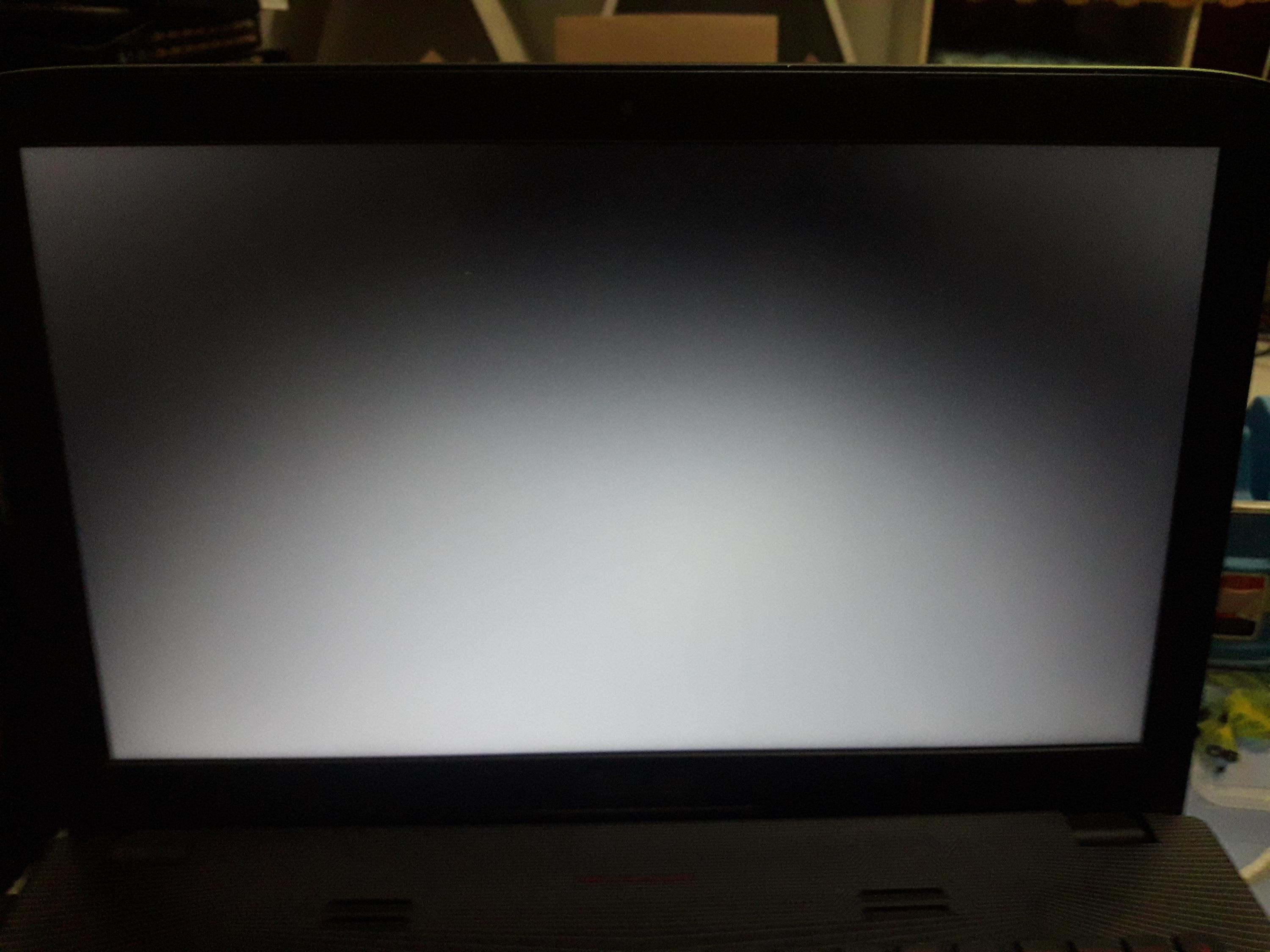

                After a while..the laptop have another symptom..its run for around 30 minutes suddenly no picture but have backlight..

                      Tested the bios..but still the same problem no picture have backlight. Any suggestion?

                                        Re: need bios for asus rog GL552vx
                                        Originally posted by SMDFlea
                                        Try this one .
                                        Its work for awhile..boot up installed windows..
                                        then black screen with backlight..reboot..fan spinning black screen.
