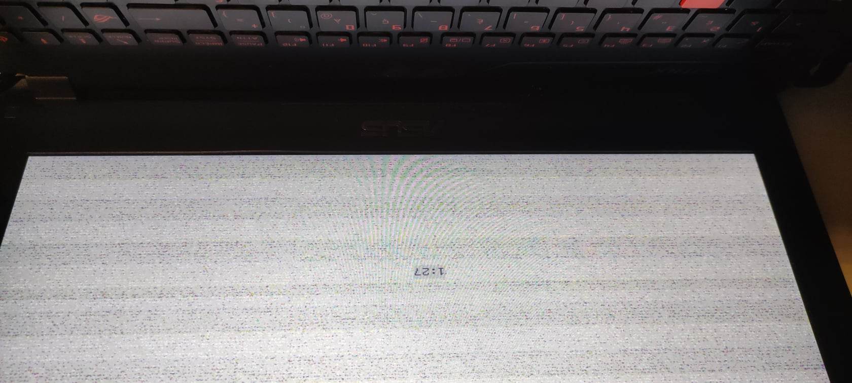

                      asus gl502vs display error
                      hello i buy a asus gl502vs and i get this error( picture )
                      Does someone know about this please?
                      I don t understand why there is a countdown
                      Thanks for your answers
                        • 22415
                        Re: asus gl502vs display error
                        Post the laptop serial number

                          • stephanelie974
                            • Oct 2022
                            • 3
                            • La Réunion
                            Hello I m sorry I can t connect due to my location. I think it s the serial number.

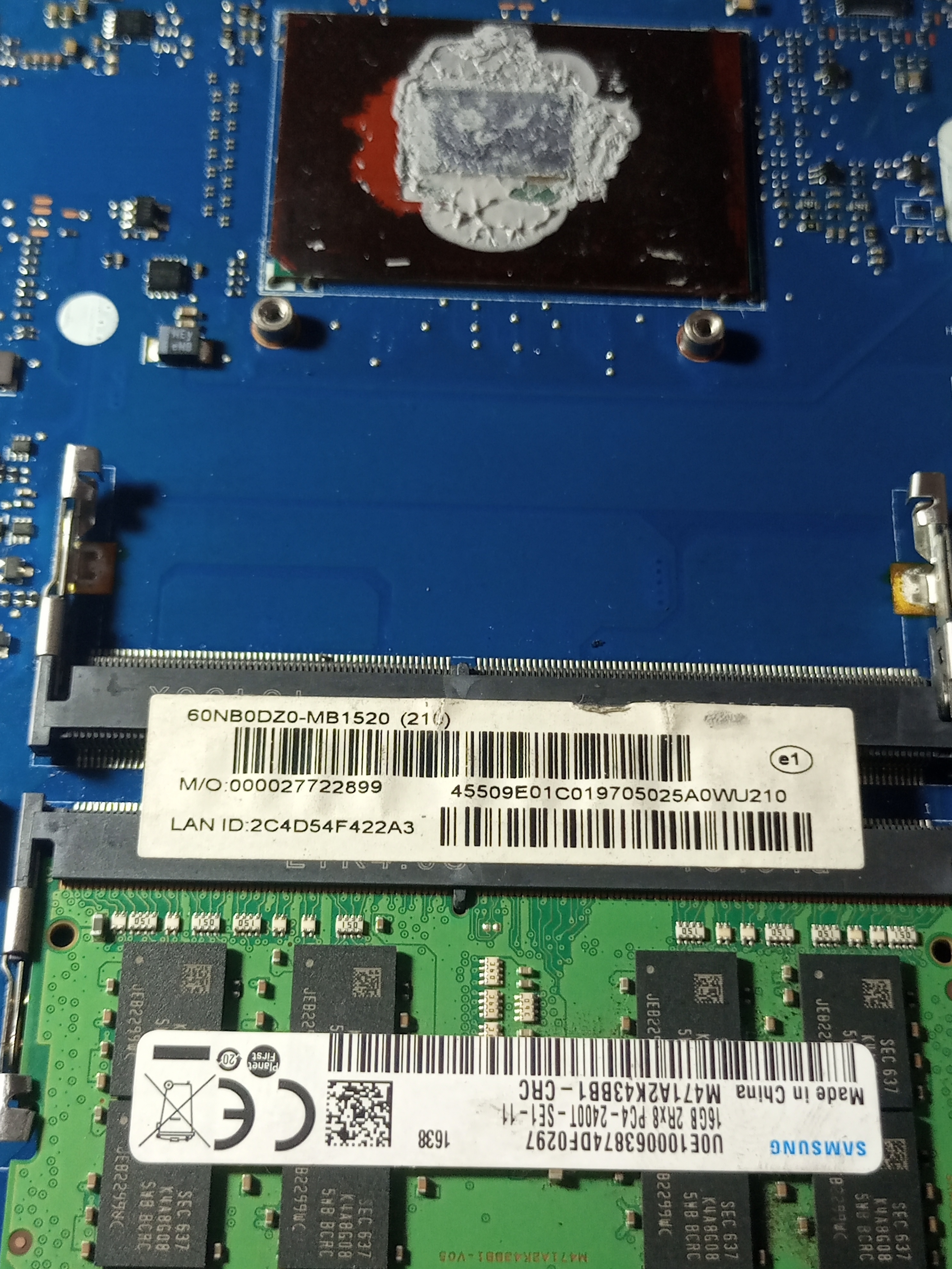

                              Good Day.. Do you have a good copy.. Of asus GL702VSK REV 2.1
                              UNIT model number GL702VS-GB059T
                              SERIAL NUMBER. H2N0WU066376077
                              Thank you very much for helping

                                You MUST:
                                • Read BIOS guides, methods, resources and tools
                                • Try the method at BIOS guides, methods, resources and tools before requesting help
                                • Explain you were not able to succeed with the methods at BIOS guides, methods, resources and tools
                                • Use search function in case someone already answered your request
                                • Post under a related thread if it exists
                                • Provide the full machine model number, serial number (or Service tag, SNID) and the board model number (see https://www.badcaps.net/forum/showthread.php?t=88758 ) ,The serial number, make, full model number, motherboard model and revision (except QR codes) must be written/typed at your request as per the rules. Not as a picture, part of the file name and so on.
                                • Name your thread with make, full model numbers and request
                                • Provide a BIOS/EC dump if possible
                                • Attach files directly to your post instead of linking to external websites
                                • Post what the problem is, be specific - black screen, no boot, running slow, password. Do NOT post "clean me", "clear bios", "clean bios", "fix bios", "bios need" or other such terms

                                  Thank you for your reply sir,,,
                                  this is the back up file of asus
                                  board number GL702VSK rev 2.1
                                  serial number H2N0WU066376077
                                  MODEL GL702VS-GB059T
                                  problem ..No display
                                    GL702VSK

                                        Originally posted by hoaca388
                                        GL702VSK
                                        No display light indicator on power button only.. If press power swithch fan on but still light on power indicator.. Saying cant power off.. Maybe no good bios.. Old one bios iis no display. Fan spin.. Can on and off on switch
