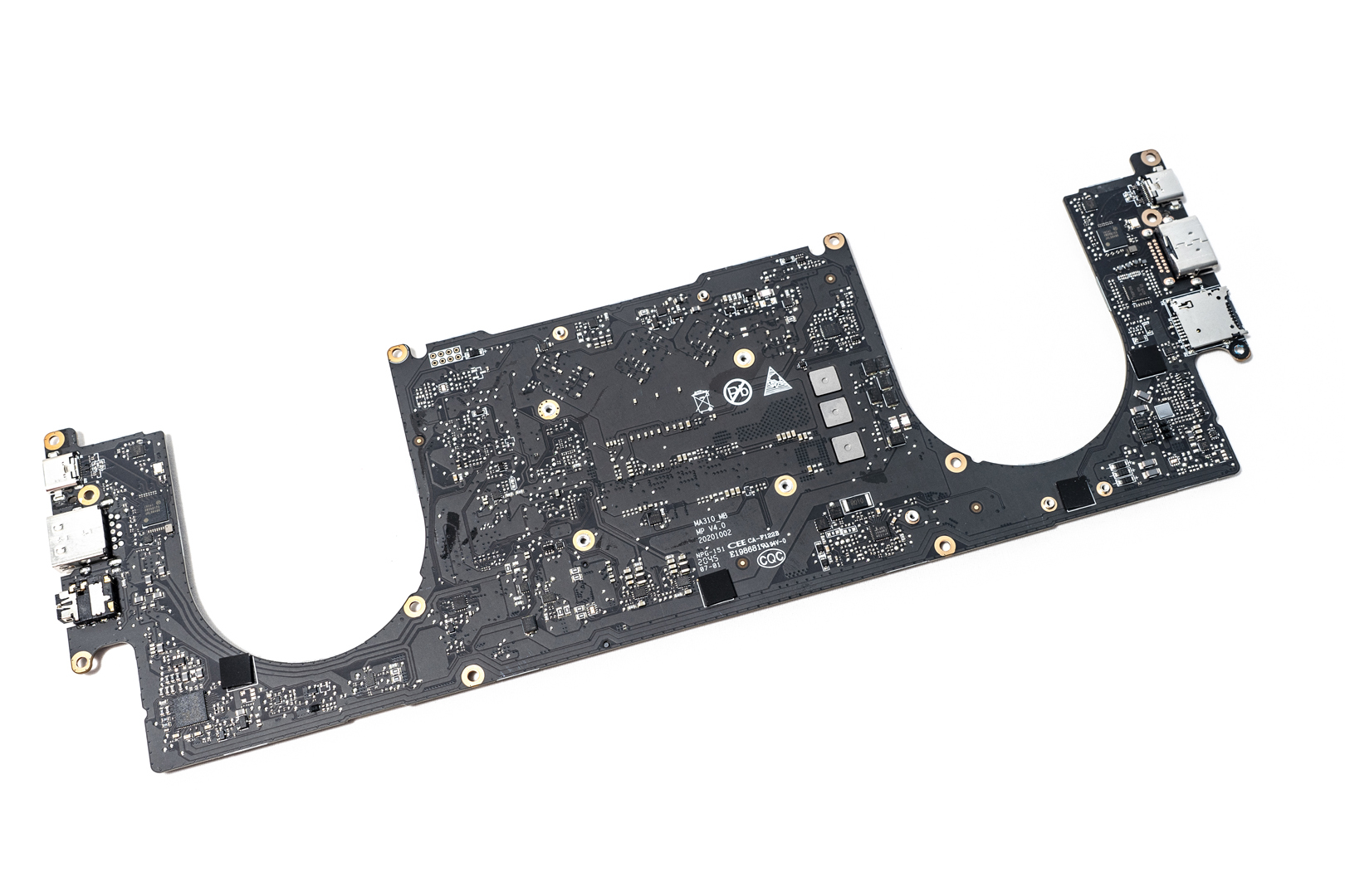

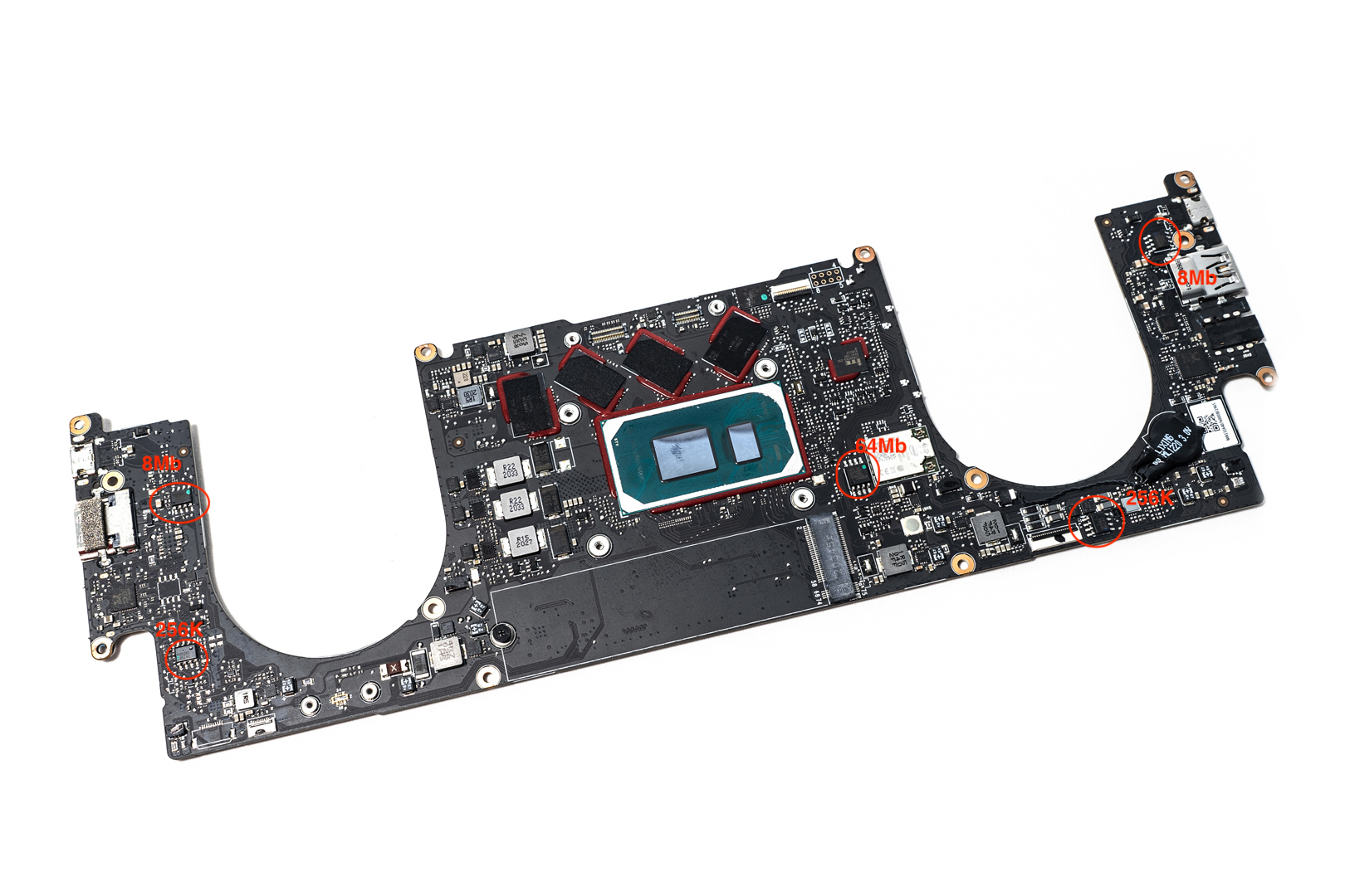

                                    I'm a bit in a fog with RZ09-03571EM1
                                    MB MA310_MB MP V4.0
                                    S/N: BY2124M14000807
                                    - bios chipset is 64Mb (MX 25L6436F) and bios file extracted from update is 32Mb
                                    - bios chipset dump is looks like EC bios having no volumes and can not find any other bios chipset on motherboard.
                                    Click image for larger version  Name:	_FIN4829.jpg Views:	0 Size:	520.6 KB ID:	3505409
                                    Click image for larger version  Name:	_FIN4843.jpg Views:	0 Size:	1.03 MB ID:	3505410

                                      #119
                                      few minutes after my previous post I see it:
