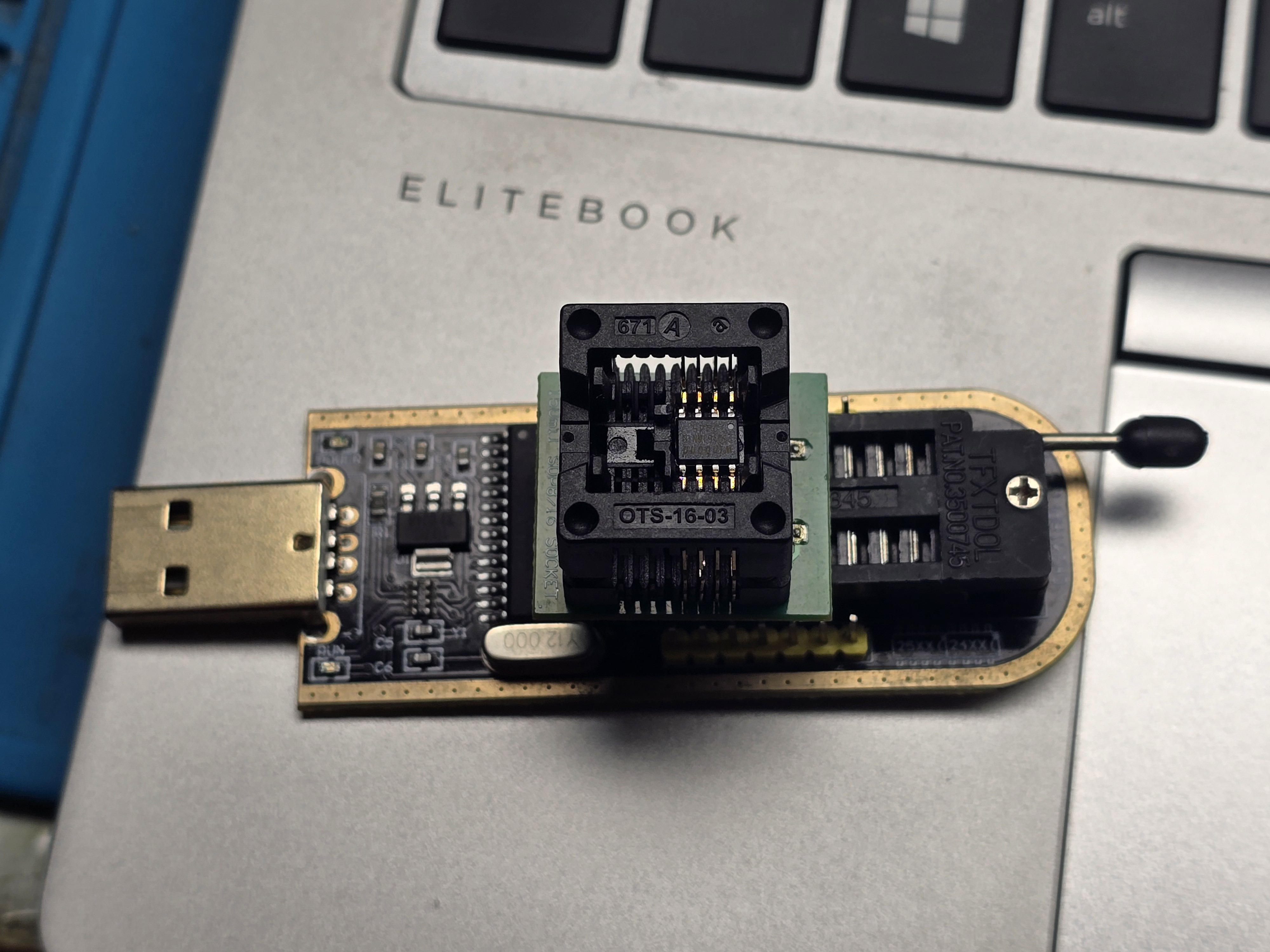

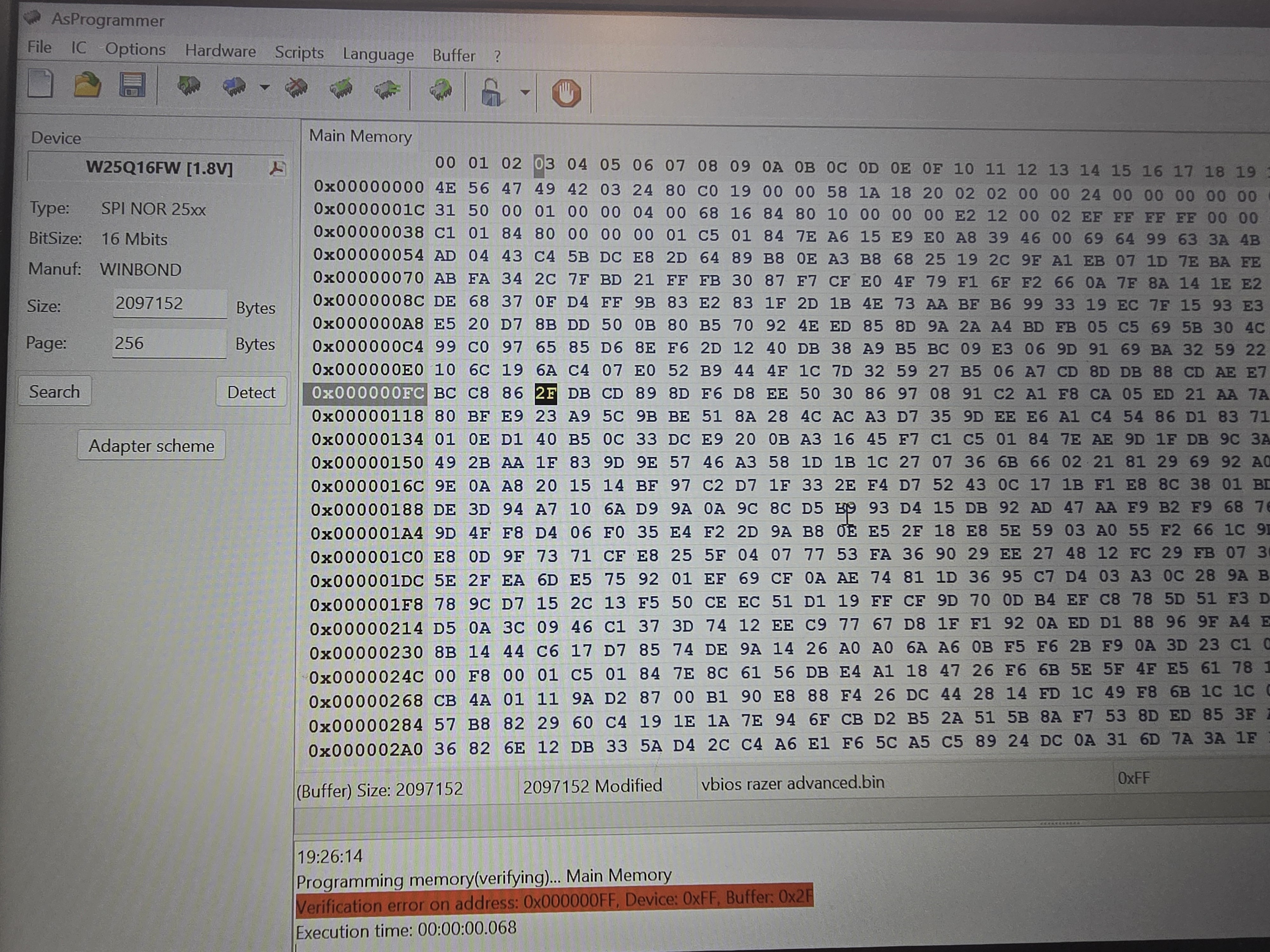

        Hello everyone. I tried flashing my vbios chip Winbond 25Q16JWNIQ but I get this error every time. The chip is connected correctly. Please help!

          #184
          The chip is 1.8V , do you have a 1.8V adapter ?

            #185
            Yes , I have use 1.8v adapter , flashed succesfully butGeorge Barn upload wrong file I think :/ Can someone check mine please?

            #186
            Yes , I know this website but there is .rom files , my vbios is .bin file . I'm confused but definitely I desoldered correct chip
              • 25677
              #187
              rename rom to bin
              • auszylow
                • Jul 2023
                • 22
                • United Kingdom
                #188
                Size is different .rom file is 976kb , mine is 2mb
                  • 25677
                  #189
                  That`s right. The file should be padded out to 2MB using a hex editor. Post the file

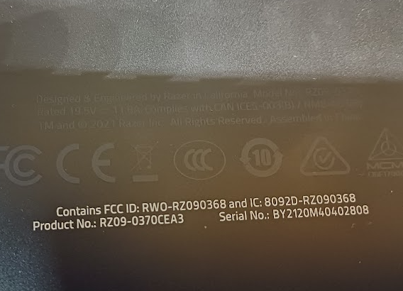

                      need help, razer laptop rz09-0370cea3 mb pi411_MB V4.0 SN by2120m40402808
                      i have voltage 3.3 on IO controller and 3.3 on power key but laptop dont power up, only take 1ma current
                      i check for shorts and all lines are ok, i hope is bios problem, here is sn and old bios, thanks

                            #194
                            What you posted is the 8MB EC backup. The bios is 16MB ,there is a full bios image at Razer support - https://rzr.to/ymagCg ,extract it with 7-zip or WinRAR to a folder. The bios is named P1106.rom

                              #195
                              thanks ill try, first time i have Winbond W74M12 chip, ill try with generic 25 series chip, i hope they dont use lock keys on this chip, i have xgecu and rt809 programmers
