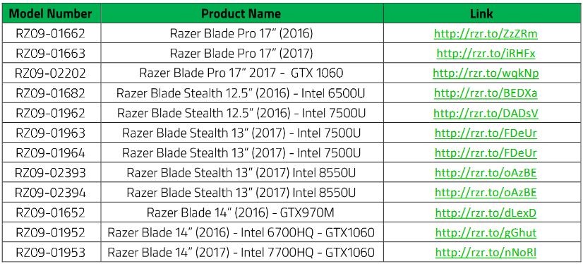

    Razer RZ09 Bios
    Razer RZ09 Bios ,extracted from official Razer bios updates.
    RZ09-01652 RZ09-01662 RZ09-01663
    RZ09-01682 RZ09-01952 RZ09-01953
    RZ09-01962 RZ09-01963 RZ09-01964
    RZ09-02202 RZ09-02393 RZ09-02394

            RZ09-02385 RZ09-02386
            RZ09-02705 RZ09-02810
            RZ09-02812 RZ09-02886
            RZ09-02887 RZ09-02888
