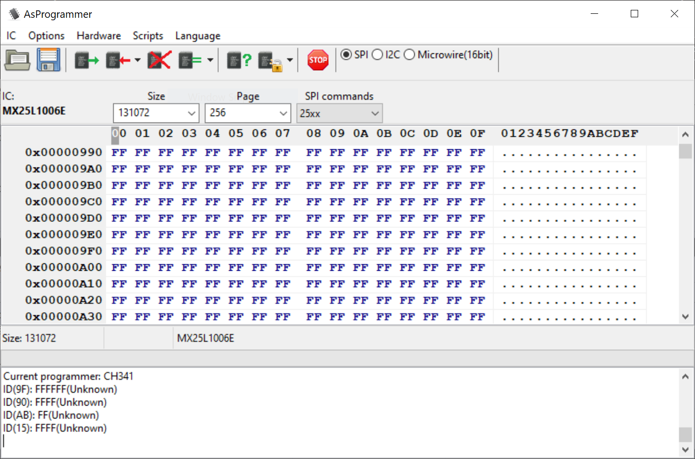

    My programmer can't read or write that chip. I think it needs more voltage that the 3.3v it uses. Here is the datasheet for U49.
    what programmer do you have?
    • scarabson
      • Mar 2020
      • 12
      Re: Razer RZ09 Bios
      This CH341a programmer is what I have
        I think that your programmer supports this chip. you can use the AsProgrammer software and select mx25l1006e. this chips is 3.3v
          Yeah that's what I've been using but I cannot get the chip to read. I have selected the correct chip from the dropdown menu but still no luck.
          • Claudiomfa
            • Nov 2015
            • 455
            • Portugal
            Re: Razer RZ09 Bios
            Possibly your chip may be dead. You can use chip MX25L8006E if you have one in stock

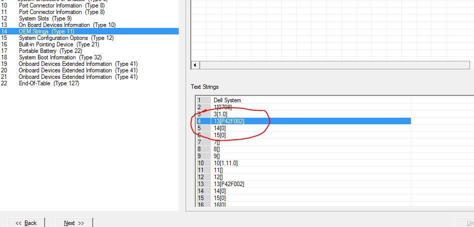

                                  The bios you posted is from an Alienware 15 R2 (P42F002)

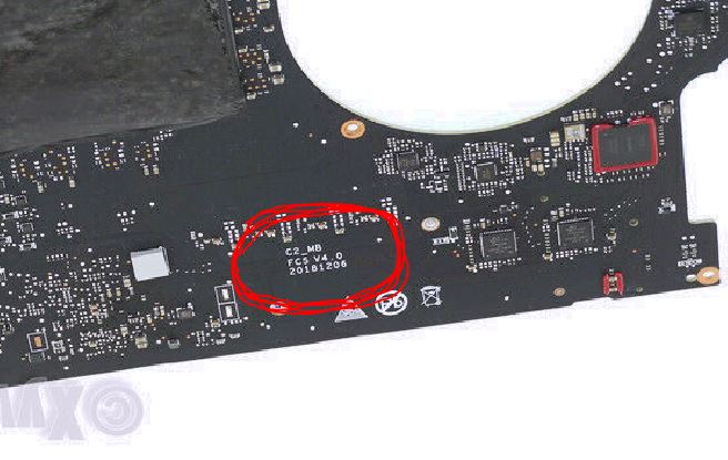

                                    Thank you for reply. The bios has been taken of razer 15 2019 . it has been dismantled by myself and it is defiantly not an Alienware. but whatever do you have any idea how to solve that. razer or Alienware. !?
                                      • 22151
                                      #38
                                      Re: Razer RZ09 Bios
                                      Check the motherboard part number, "C2_MB FCS V4.0" .If thats what it is then try the 02886 bios at post #6 .
