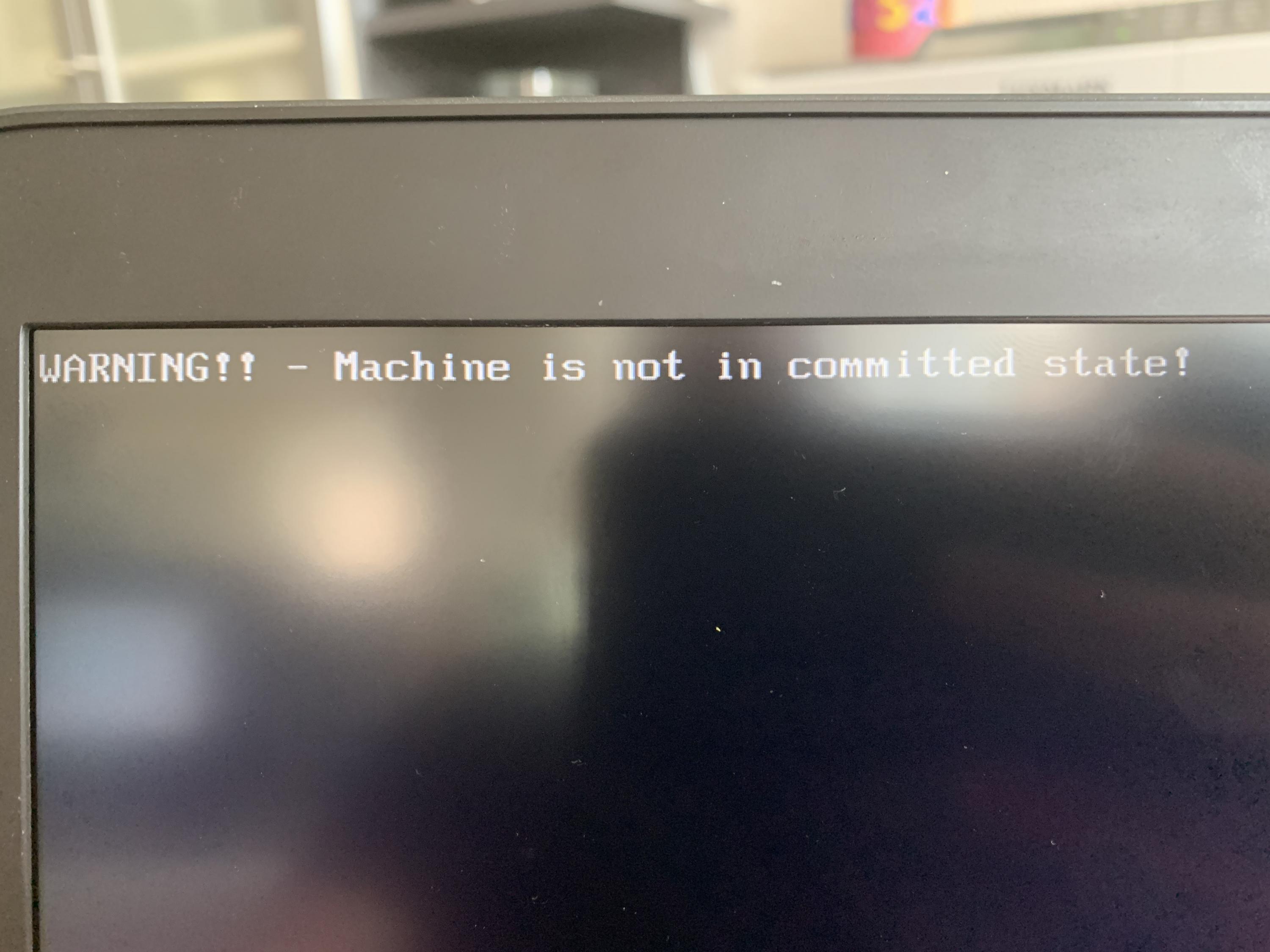

                          I have a similar problem. I have an HP ProBook 650 G2. Unfortunately I don't have a dump from this notebook. I have uploaded a biosfile from the Internet with the ch341a. The notebook now starts up again but I cannot change the SKU, SN ...... because it is in MPM "Lock" mode. I've tried several things but nothing has worked so far. I would have all the data like SKU, BoardID and model. Maybe you can feed the existing bios with the appropriate data and I will then flash the customized biosfile.

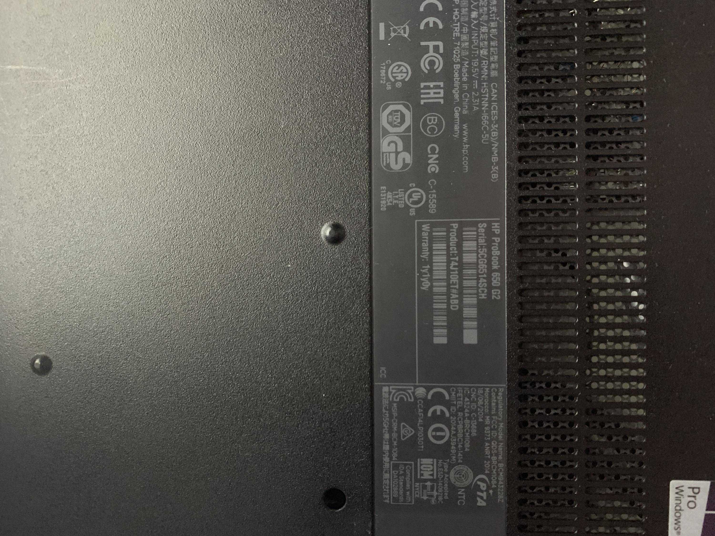

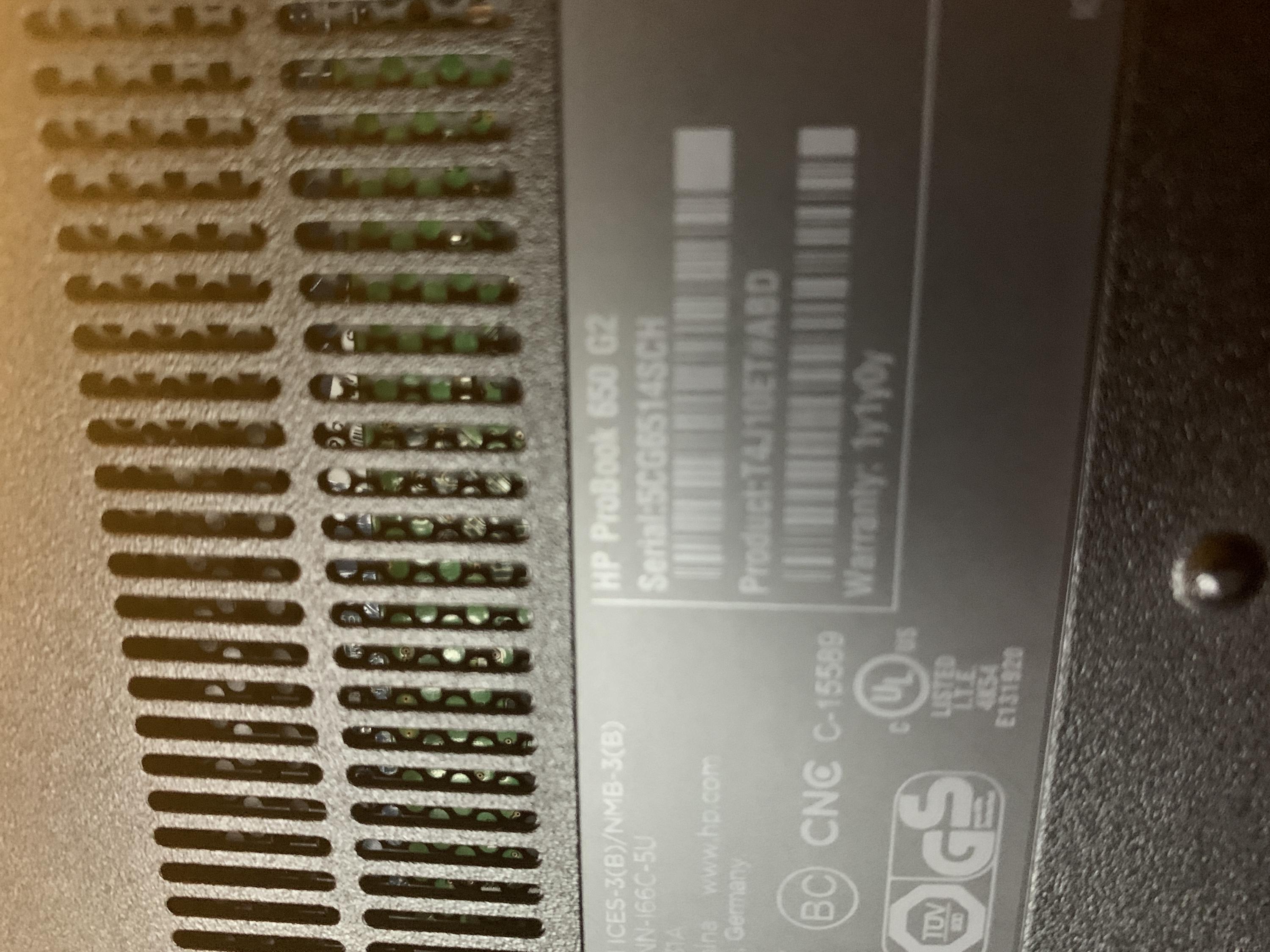

                            Can you give us your serial/pcid/BID !maybe we can know your right bios
                            • BADJACK80
                              • Mar 2020
                              • 21
                              • Erde
                              Re: HP Probook 650 G2 won't turn on after bios chip replacement
                              SN/ 5CG6514SCH pcid = T4J10ET#ABD BID/ PFKCQ00WB561EA

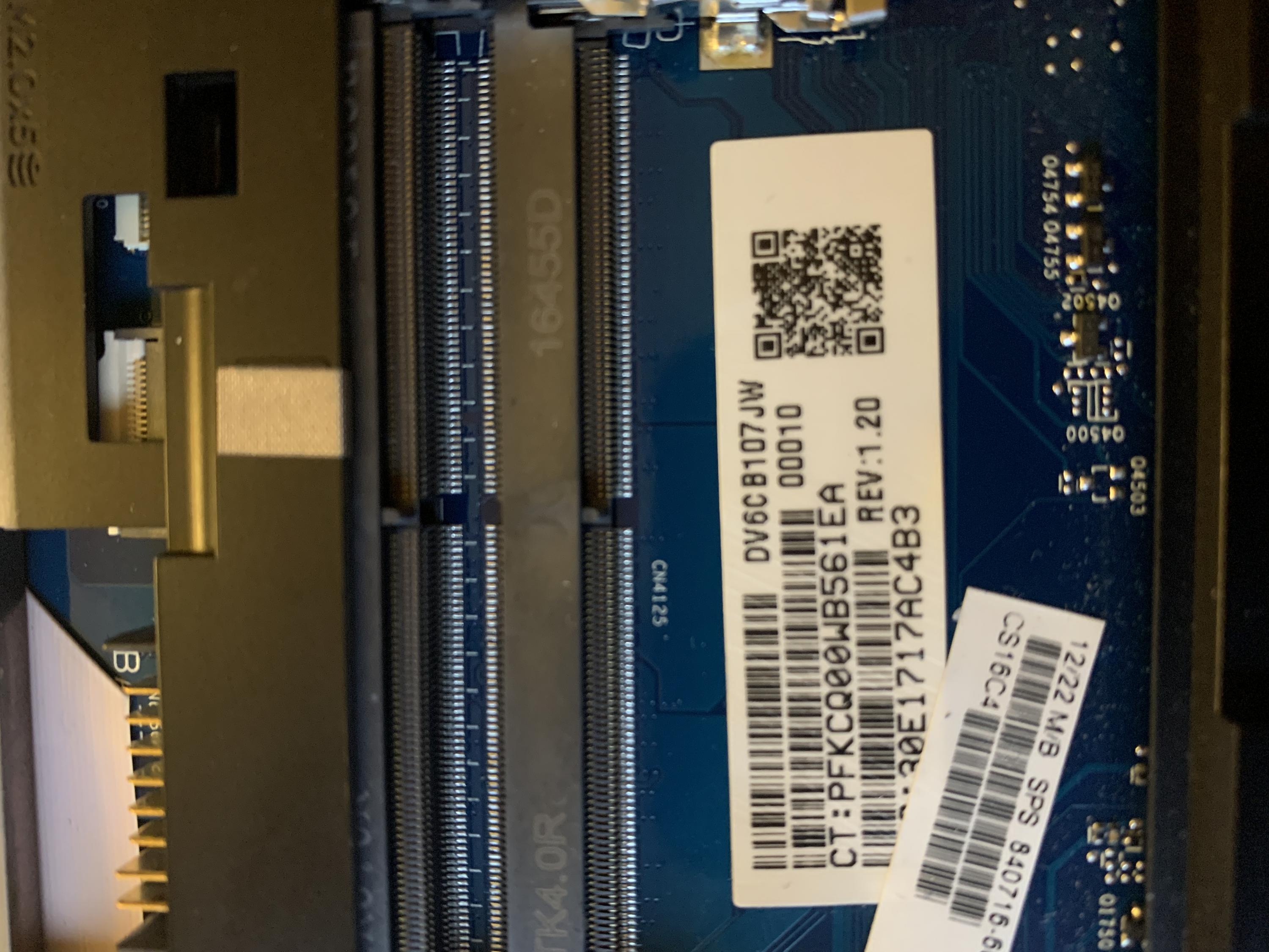

                                      it's a little difficult to give you your bios dump without the old one , can you give us the motherboard identification

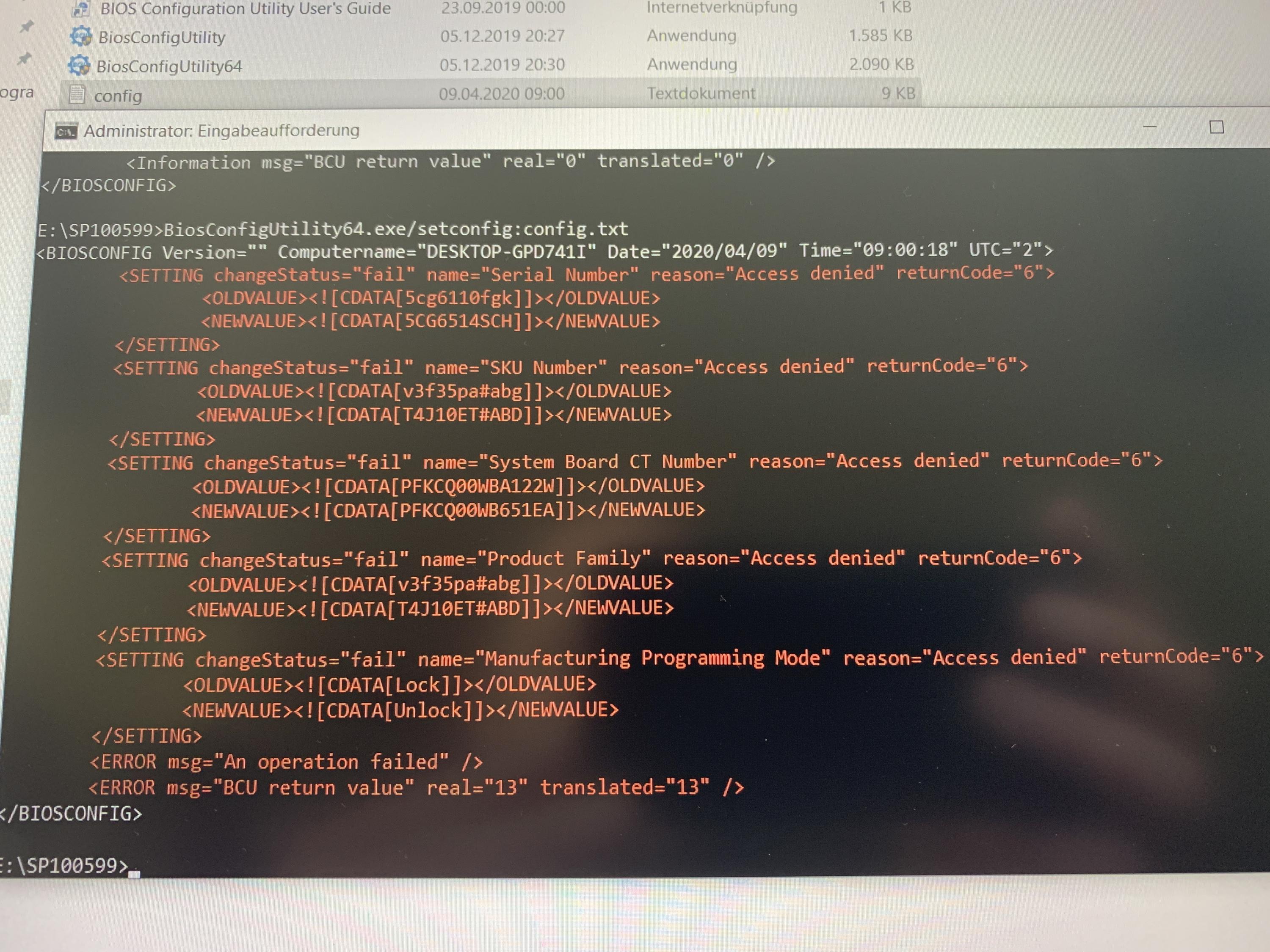

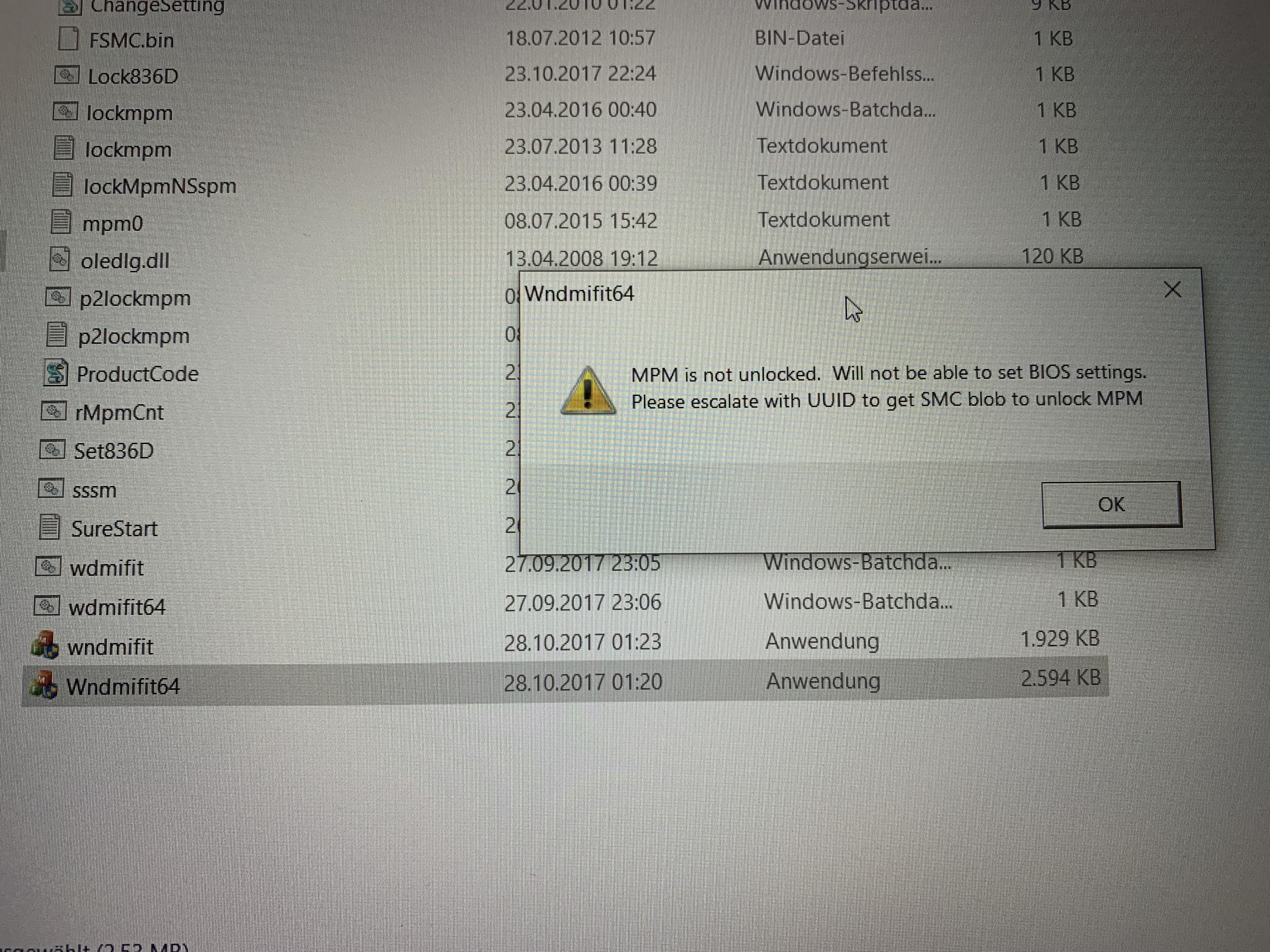

                                        I have already tried the HP BiosConfigTool. That unfortunately did not work. Since the device is probably still in MPM "lock mode". I have already renamed the FSMC.bin to SMC.bin but then I get an error message when booting. I have now attached the pictures of the individual error messages.
                                        Image 1 = current error message with the biosfile from the Internet
                                        Image 2 = error message from wndmifit64
                                        Image 3 - 5 = model and board names of the laptop

                                        Image 6 = Errormessage HPBiosConfigUT.
