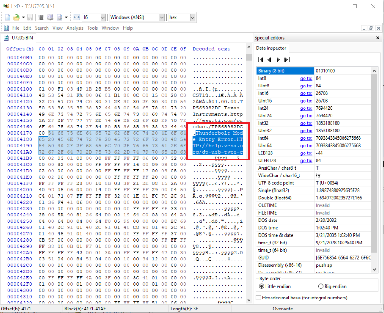

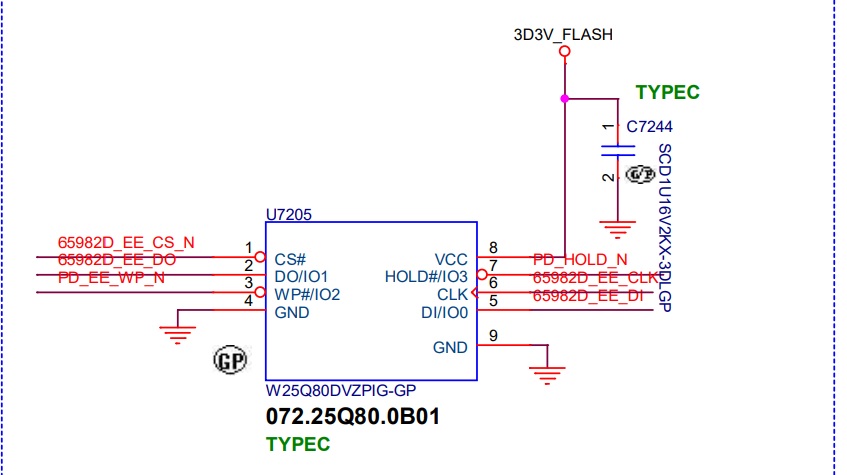

                            There is one more bios chip U7205 Size 1024kb In 17859-1 DELL 5480 Any have working bios please share
                              This is not a bios chip (I don't know what it is). Your bios chip usually has codes as 25Q64..., 25Q128..., 25Q256..., 25Q512... Find it, read it, make a backup and upload it here.

                                I also don't know about this but i think this is a bios chip i have backup and check datasheet pdf file https://cdn.badcaps-static.com/pdfs/...744336155e.pdf
                                  No, this is definitely not a chip that contains a bios file, this model has a 16MB bios so please find a chip with code 25Q128...The chip you uploaded may be the firmware of Thunderbolt.
